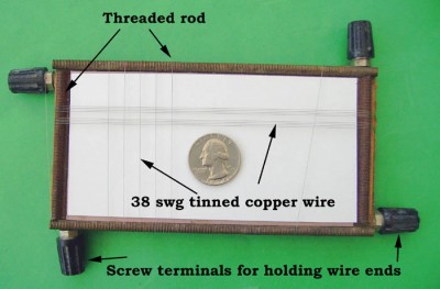

I do think photoetch would be the better option but with limited funds the photoetch is about 1/2 the cost of the forrestal kit.
That said in dont know it is possible make ,but would like to try.
I had searched google and this popped up made by shipbuilder. I need the spaceings betweeen the wires.
this was made by Shipbuilder back in 2011
thanks
kevin

I built that kit several years ago but it was destroyed during a coastal storm that blew in some windows at the house...I scrapped the model but did salvage some of the PE rails and such and tossed them into my PE scrap stash to use on a Missouri build.......Last nite I located a small section of left over "3 Bar" rail from that GMM "Forrestal" set.
The stanchions are 1/8 in. apart and the rail from bottom to top is 3/32in in height. So the top to bottom spacing is 1/32 between each rail.
Sorry but didn't locate any "4 Bar" to measure.
Hope that helps.

:woo_hoo: gott_cha :thumbs_up_1:
now i have the info all i have to do now is make the jig
Thanks again
