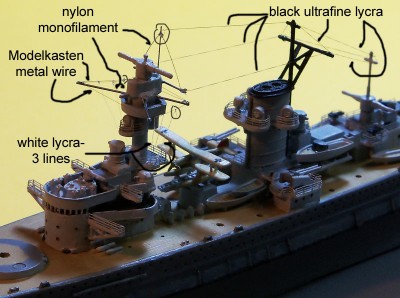

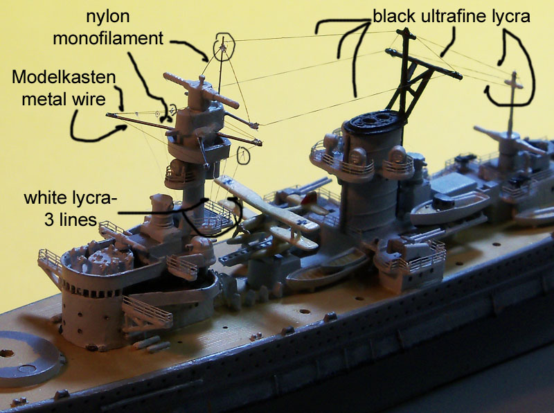

Need types - here are some issues
Here is a photo of my 1/720 Italeri Deutschland/Lutzow build (in progress) focused on rigging. I am trying to find a suitable replacement for Dai-Riki #9 nylon monofilament (0.002" diameter, so very fine, but still relatively stiff).
On this build I have used Infini ultrafine Lycra thread (I have white and black spools of this), along with Modelkasten 0.04 (H-7) metal wire (0.04 mm or 0.0016" roughly, so equivalent to Dai-Riki #9), and 0.003" nylon monofilament (I have two sources, Dai-Riki #8 and some from a domestic thread supplier - basically a lifetime supply for several modelers and then some).
This size Modelkasten wire has been discontinued as has the Dai-Riki nylon monofilament line. So, I'm trying to figure out if I can make the Infini model Lycra rigging work. For those unfamiliar with Lycra, it is an elastic polymer, so it stretches out significantly in tension (when pulled) much like a rubber band. Nylon monofilament is closer to copper wire (very little stretching when pulled).
I started around the giant pole mast superstructure. I laid Modelkasten wire horizontally around the perimeter of the large X-spar and tacked it down with superglue (no knots). I then attempted to rig three flag lines from railings on both sides of the bridge running up to the Modelkasten wire. The picture shows the port side, where I have three Lycra lines in place. This required about 6-8 attempts, as I pulled the wire off a couple times and had to reattach it (leading to a build up of glue at the tips of the X-spar) and as I also sliced the wire in half along with some of the Lycra lines trying to trim the end of the knots off (you can see in the photo, circled, that one of these is still poorly trimmed). I use a cuticle snipper from the women's beauty supply section of the grocery store to trim knots. It's always worked well with nylon monofilament, but the Lycra is putting up more of a fight (I think it squeezes when the snipper jaws close on it, but doesn't snap). A friend of mine has suggested that I try a razor blade, but it's awfully close quarters.
On the starboard side, I declared defeat after multiple attempts to run the three flag lines. The forward of the three lines is white Lycra, but the other two flag lines are 0.003" nylon monofilament. My opinion: the knots of the monofilament onto the wire look enormous compared to those on the all Lycra side, but it was sure a lot easier to run the lines using monofilament. Kind of a similar problem with the nylon monofilament that I used to brace the foremast spar diagonally up to the top - I don't think the line itself looks that bad, but the knots are far from delicate looking.
I switched to the long runs between masts, and I went with the black Lycra ultrafine thread. This went considerably better than the flag lines (more room to work, and more out in the open), though it was still more difficult than using nylon monofilament. I tied a knot at each spar tip as I ran the line from bow to stern. The knots aren't too bad looking, especially considering that the thread doesn't always want to pull snug around the spar when pulling from both ends (remember it's like a rubber band, so instead of passing line through the knot loop, some of the tension just goes into stretching out the long runs (temporarily - it snaps back pretty well when you let go).
All through this, I keep thinking there has to be a better way. Are knots really needed? The Lycra is so flimsy that it's not going to pull itself off the attachment points in my opinion.
FYI: I also tried to run the flag lines with Modelkasten wire. It is too stiff to loop over another section of the wire and pull a knot where the hole is as small as the wire diameter - so you get a hanging doughnut going that route. Similarly, while I can attach the wire to larger objects like spars just by tacking it with superglue (no knots), there wasn't enough contact area between two pieces of the wire to glue the end of one piece to the middle of the other and have it stick.
Anyway, I'm thinking through the ramifications for my future builds (perhaps a combination of wire and Lycra; the Modelkasten 0.046 mm wire is still available, and I have some on order to see how it compares to the 0.04 that I'm using).
