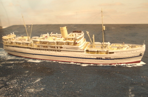

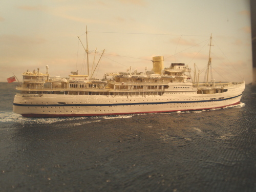

Here she is - HMT Devonshire built by Fairfield Shipbuilding and Engineering, Govan, Glasgow and owned and managed by Bibby Line.
She is shown, as built in 1939 (again, thanks to the excellent plans in John Bowen's book 'Miniature Merchant Ships) and liveried as a troopship.
It has taken about 6 months to complete and follows the construction Evergreen strip over a balsa wood core. Aftermarket parts were brass masts from Master, gravity davits from Hasegawa, railings from Tom's Model works and bits and pieces from the spares box.
Hope you like it.

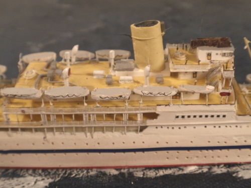

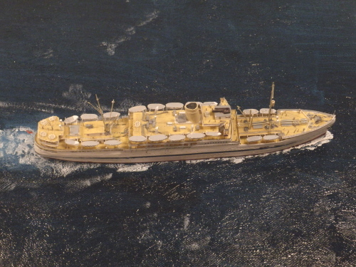

And for Timothyo - here's a few more pics

So nice....thanks for the additional pics! I would like to do a liner, but not sure how to make convincing windows, so it always helps to see how others have approached it.

I then print these on to Self Adhesive address labels (available from any stationery store) and cut with a scalpel to suit the model. Look closely at the close up of the bridge picture - you will see that the superstructure windows and the doors are stuck on.
