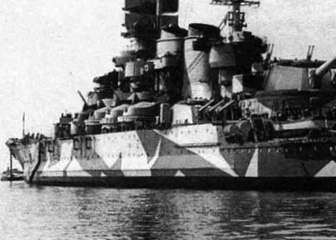

I would also armor her in the Montana style, being a stacked side armor profile. She would have a Roma exterior main armor belt that could be maintained from outside the skin of the ship.
An inner secondary belt would be between 4-7� thick one frame inboard. The main deck would remain between 1.5� and 2� with a 2.5� splinter deck 20� beneath the main deck. This arrangement would likely defeat all ASCMs today. The bottom would be a triple or quadruple layered armed bottom with CVN style anti-ship missile defeating expanded metal. Essentially it�s a spring metal sponge. Then the armored box we know and love of the Iowas.
The new hull form would eliminate the thin-hull vulnerability Turret 1 on the Iowas seems to have.
