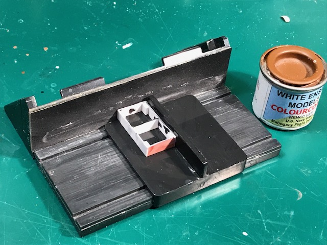

Oh - And definitely pick up one of these sanding guides:
https://hlj.com/pallet-for-file-2-wavht-082
Super cheap and just the thing for truing up a 45* or 90* edge. A life saver that I use all the time when scratchbuilding.
-- Scott

Re: how to build a cuboid structure 2,7mm square and 5,5mm h
Is there a US source for the mini sanding guide? I have the Micromark or NW Shortline Sand it, but it is often too big for the work that I am doing.
