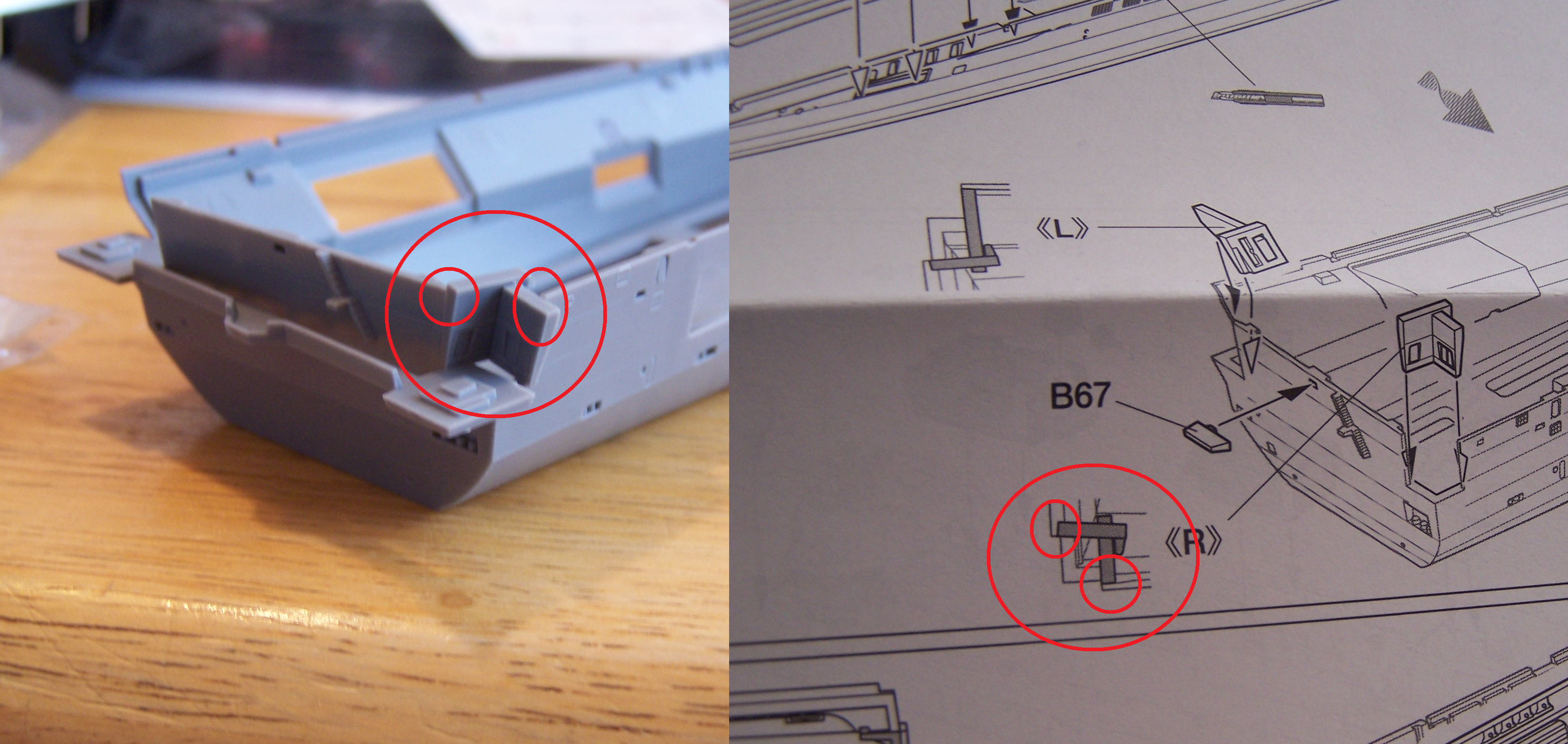

Well ran into a pretty big problem with the kit....as I was building the back end of 'Ibuki', there is a major fit problem on the aft weapons catwalk...
As I moved the catwalk one way, it got offset on the other side, and vice-versa. So I sanded it down a bit as to fit the aft hull and attached the bulkheads for the weapons platforms.
Also, the tops of those bulkheads of the weapons platforms needed to be sanded and filled and then there is the PE ladder that needs to be attached, so you need to remove the molded one on the aft hull bulkhead.....I hope that is all the 'major' work that I need to do with this kit :Mad_6: At least the accommodation ladders came out pretty well.... :thumbs_up_1: Note: I have not attached the small boats as I need to paint those separate but more important, paint the well where they will be placed.
Posts: 12437
Re: How about the Tamiya Ibuki
The reason your platform didn't fit is because you missed the inset diagram of how L and R corner bulkheads are supposed to be located: their ends contact the interior of the hull sides, whereas you have them with their ends forming part of the outside.

Hey Timmy C. I assume that is my original photo that you circled? But, I thought I did what the directions said...I'll take a look @ the work so far, but even the platform didn't seem to fit the major aft bulkhead of the ship. But It is already glued and sanded down already.... I do want to mention that I have a HYUGA-class and IZUMO-class of these ships, and they are Not from Tamiya, OR Maybe I just placed the wrong bulkheads together, you know the one port-facing bulkhead with the starboard side aft bulkhead or something.

Yes, both images are from your post - I just edited them together so it's easier for everyone to view together. In the future, it's always helpful to dryfit pieces before gluing them down: that way, if the pieces don't seem to fit, you can double check you have the right pieces, that they're facing the correct way, and are making contact where they're supposed to.
