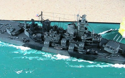

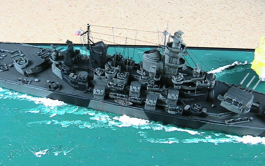

For my USS Iowa '44, 5N Navy Blue is closest to FS35044 (Model Master Insignia Blue1719) and 20B Deck Blue approximates FS35042 (Model Master Sea Blue 1718). At a glance, the two look almost similar but you could lighten Sea Blue with 4:1 with a medium gray shade (Dark Gull Gray for example) for sun-bleaching effects if so desired. The Navy Blue has a "bluer" effect at the edges. See contrast (or lack of) in the picture.

The vertical dark stripes on the hull and funnels are 5N while the deck and top of the turrets are 20B.
