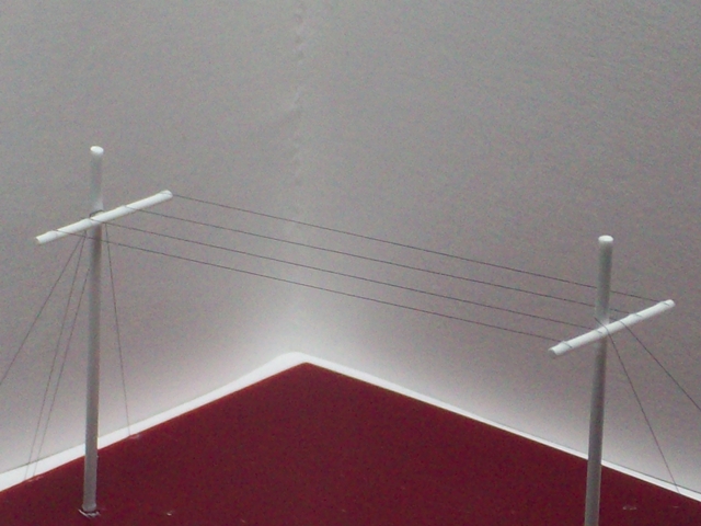

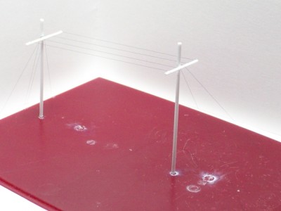

Got my camera back so I thought I'd post some pics of my test rig of the Caenis thread.
Dave
Dave
"There is no problem which cannot be solved through suitable application of naval artillery."
