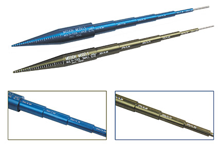

Use a mandrel, slightly less in diameter than the size you want (due to spring back) and wrap your brass around it. Cut and Viola! I just made a bunch of brass rings for a customer on Sunday.
You can use anything round- pens, wooden dowels, etc. Mission Models produces two very nice aluminum mandrels; available from your LHS.
They're also good for PE.

Got a socket set that has a groove machined into the outside of the sockets that is nice for holding the wire. Only problem is limited sizes - about 1/32" difference is diameters of the rings I need to make - not a show stopper certainly. Now need to figure a good way to hold the ends together. I'm going to try fixing the sized rings to a tapered wooden dowel and soldering. Thanks for the suggestions.
