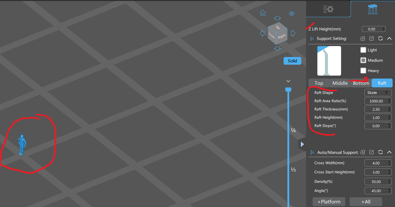

Hi guys,Iceman 29 wrote: Your exposure time may be low.
What is your printer type and exposure time setting?
here is a screen shot- there was no raft in the first place ...and trying to make one doesn't seem to be heading in the right direction..
- DrPR
- Posts: 1689
Re: 1/700 3d printed figures
There is no way that will work! The "footprint" (literally) of the figure is way too small. The upper parts are larger and will stick to the FEP, pulling the figure off the printer surface. Basically the XY surface area of the platform should be larger that the cross section area of the part to be printed.
Down at the lower right in the Chitubox screen click on the "+Platform" button. This should add a platform to the figure.
Last time I looked Chitubox had tome video tutorials. I found them to be very helpful.
In the "Settings" page you need to configure the program for your printer and the resin you are using. That can be tricky.
What printer are you using?

Consider the following example:
Suppose you have a one ton iron ball sitting on the ground, and you want to lift it with a crane. If you connect the crane and the ball with a thin thread, when you start to lift the thread will break.
When printing, instead of the ball you have the printed object stuck to the FEP film, and the crane is the printer platform that is rising. If the connection between the printer platform and the printed object is too thin (weak) it will break, leaving the print stuck to the film, and the print fails.
If you want to lift the ball with the crane you need a cable that is strong enough to lift one ton (with a little extra for a safety margin).
If you want your prints to succeed the connection between the printer platform and the printed part stuck to the FEP film must be strong enough to carry the force needed to separate the print from the film.
In the image of the figure you posted it is attached to the printer platform only by the soles of the figure's shoes, and this is far too small an attachment to the printer platform to sustain the forces needed to separate the printed part from the film.
Furthermore, as the print proceeds the attachment area to the film gets greater and greater as the cross section area of the printed figure increases (from the feet to the waist). The forces get greater and greater.
To succeed the cross section area of the attachment points to the printed object needs to be about equal to the cross section of the part being printed. You need a large base on the print platform (the "+Platform" function) and additional supports along the printed object to take the stress.
Chitubox often does not provide enough supports, and the printed part separates from the print platform - the print fails. This is especially true with objects that have a large basal area. You have to add additional supports by hand. For a tiny object like your figure you may expend 10 times as much resin on the base and supports as in the figure itself.
Look at the tutorials on YouTube and the Chitubox site and experiment. After a few trials you will get the hang of it.

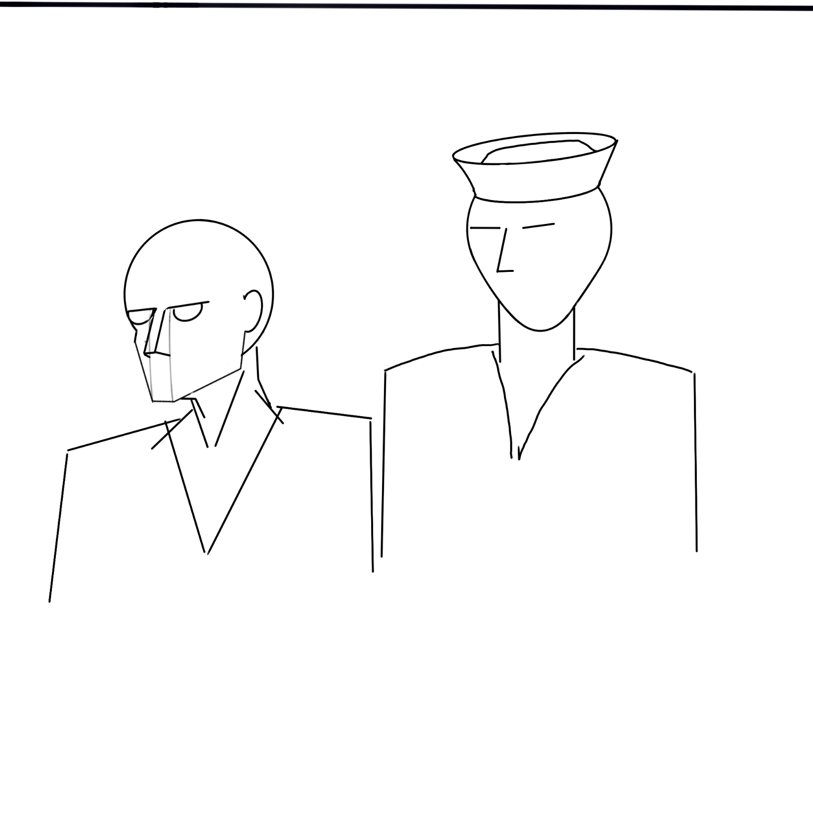

I have a question about the Crew Figures.
Why do people put an egg directly atop a neck?
Such as the right-hand figure, and not a Sphere with a Wedge on its front-lower half, like a Human Head, where the neck enters at the contact of the wedge and sphere (Left-hand figure)
I know that in larger scales the overhang of the wedge/chin/jaw would produce printing problems without supports.
But the actual anatomy of the neck produces those supports in anything from 1/700 to 1/32 scale.
And pardon the 30 second finger sketch.
MB
MB
