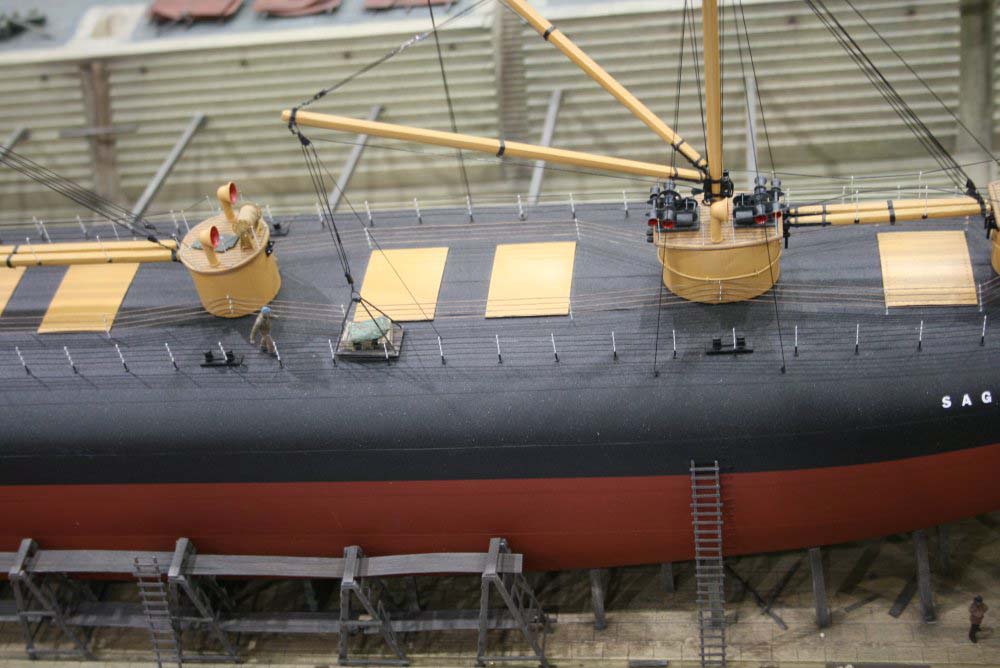

Gordon not only enlightened me about the ( sole ) English built whaleback... but
illustrated it most effectively with an amazing scratch build in 1/96 scale of the drydock
with the SS Sagamore sitting within !
he also supplied me with some photo and drawings, but mostly... he inspired me! :thumbs_up_1: :thumbs_up_1:
Below find some images of this very fine diorama.
Tragically it was irretrievably damaged by water (!) and is no longer extant
feast your eyes gentlemen

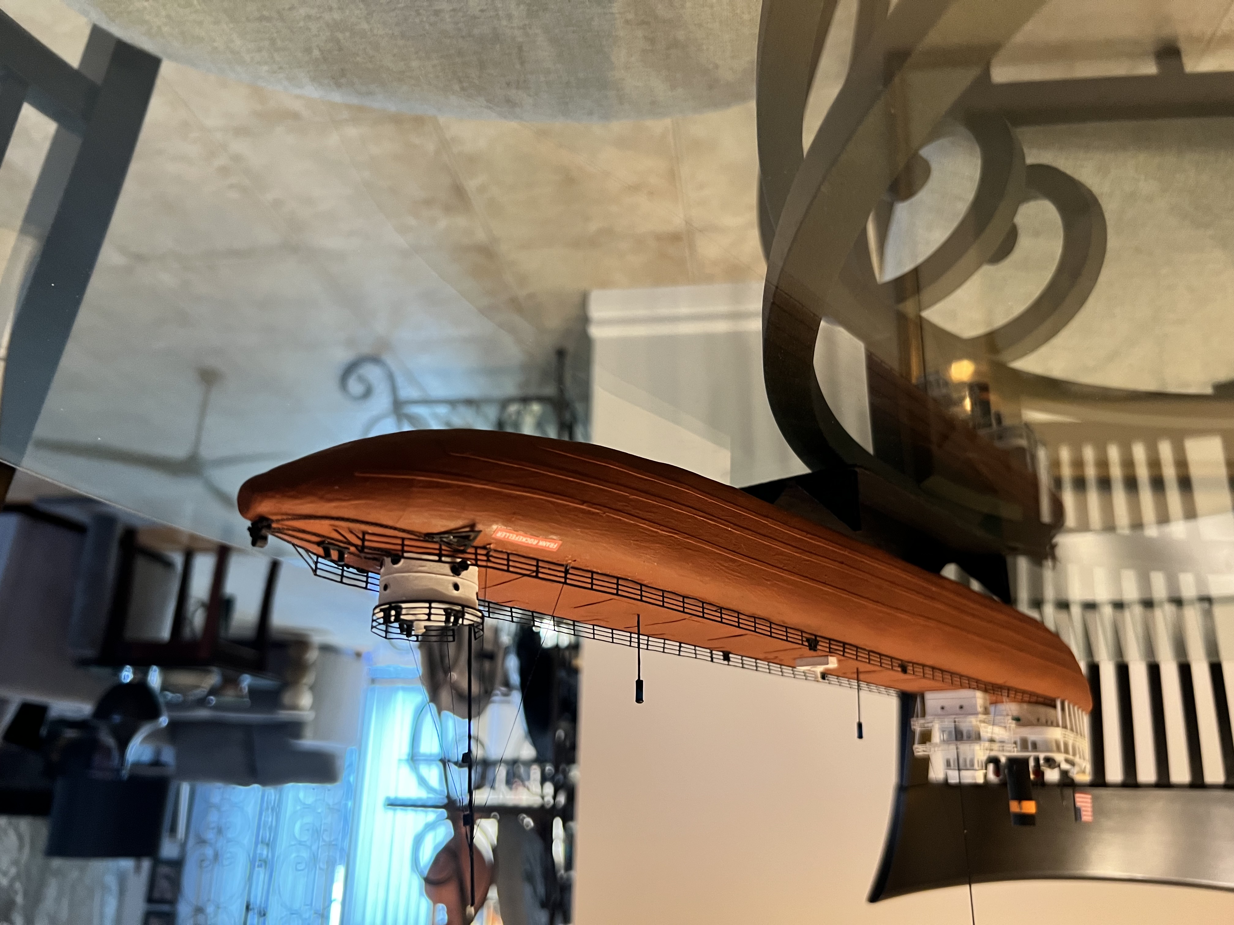

Congratulations on such a great choice of subject. I scratch built Frank Rockefeller in 1:200 scale, I�m sure your Sagamore will be far better!
I don�t know why the image posted upside down.

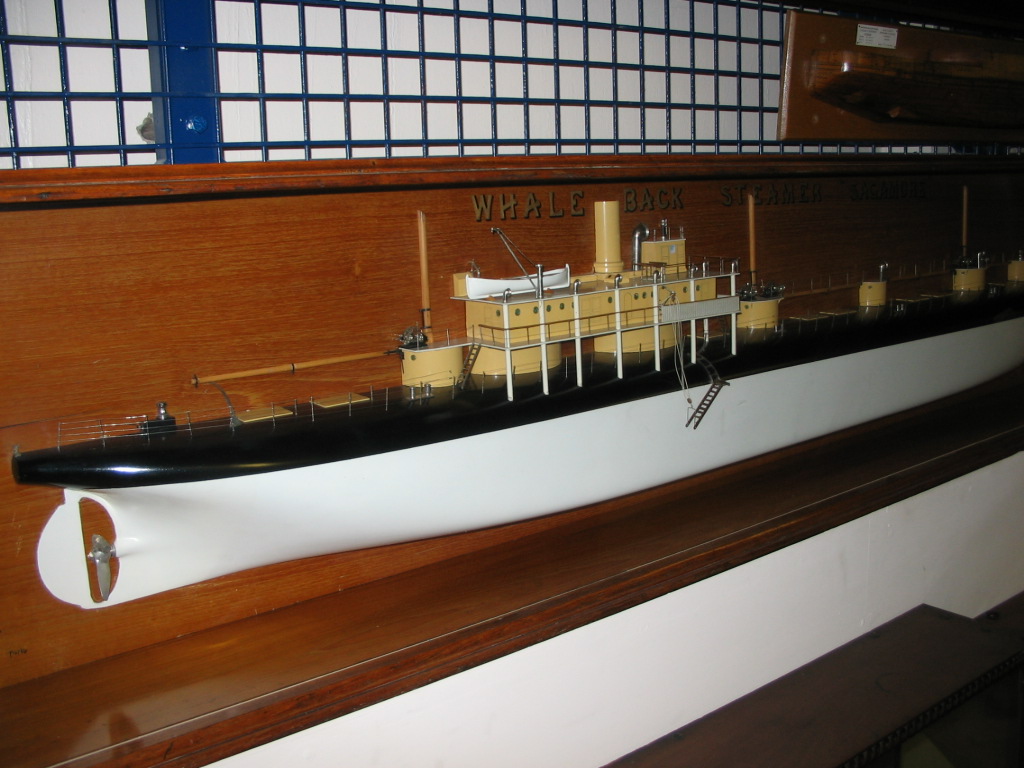

The builders ( half ) model of Sagamore still exists--
and Gordon Brookes was able to produce a
decent side-elevation GA drawing;- which correlates well with the images available in 2009
and some additional images that I have found since :thumbs_up_1:

as the Builders model specifies the length as 312 feet
BETWEEN PERPENDICULARS ( not length overall)
this gives a length over all as 322.67 feet

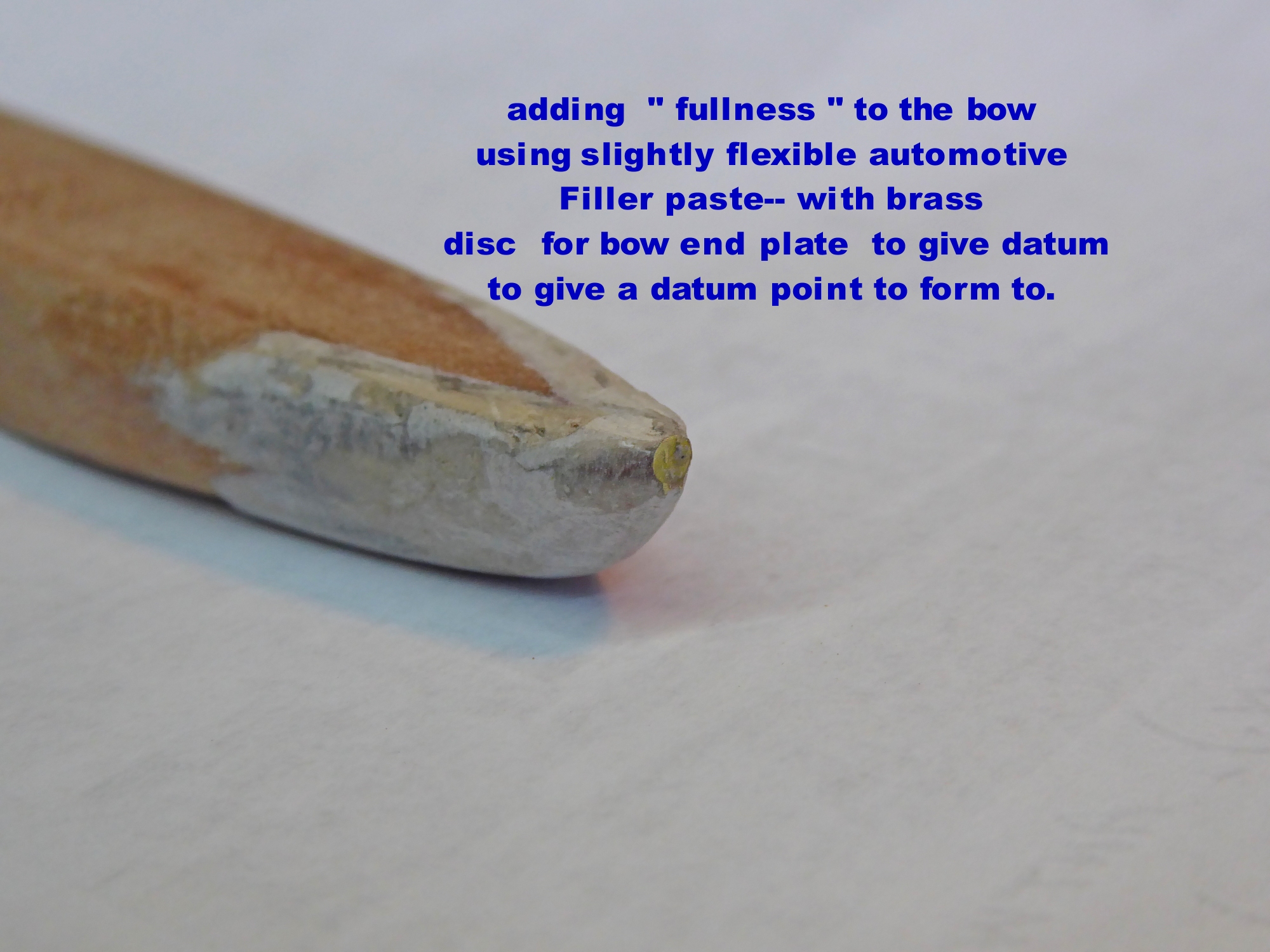

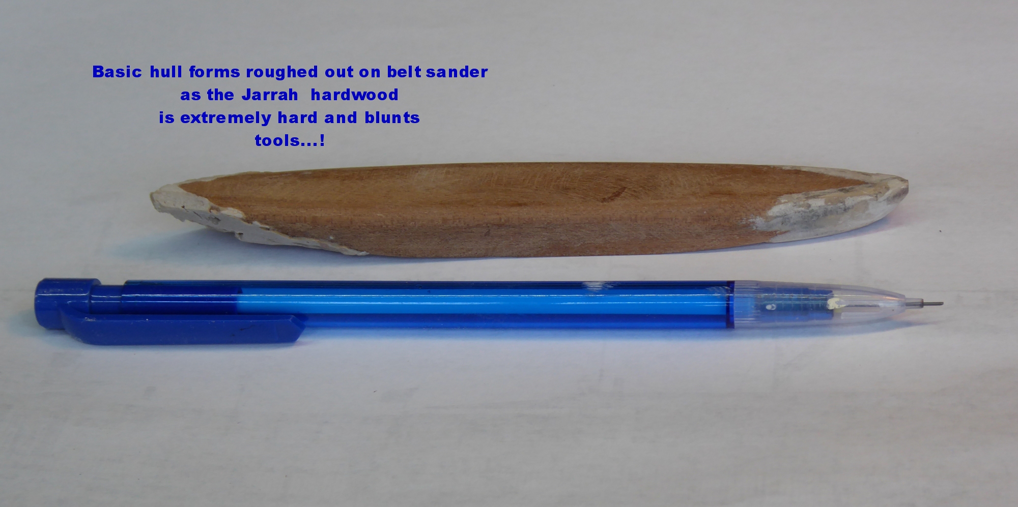

In 1/700 she is not a large ship, ==> I carved the hull in 150 year old Australian Jarrah hardwood floorboard
( from a demolished/ salvaged British army barrack room floor,--I bought 4 x 5 ft lengths 25 years ago...)
My piece of Jarrah wood is very hard, dense and well seasoned ( 150 years! )
I roughed out the shape on my belt-sander -as the wood is so hard
and quickly blunts normal hand-tools-- and I like to get things moving
Using the cross section lines made some scaled to 1/700 card templates to check the sections- the middle section is
parallel and unusually--completely flat devoid of any sheer ( deckspring)

and now onto something tangible !
JIM BAUMANN
Posts: 5698
Re: SS Sagamore 1893 whaleback 1/700 scratch-build
Post by JIM BAUMANN »

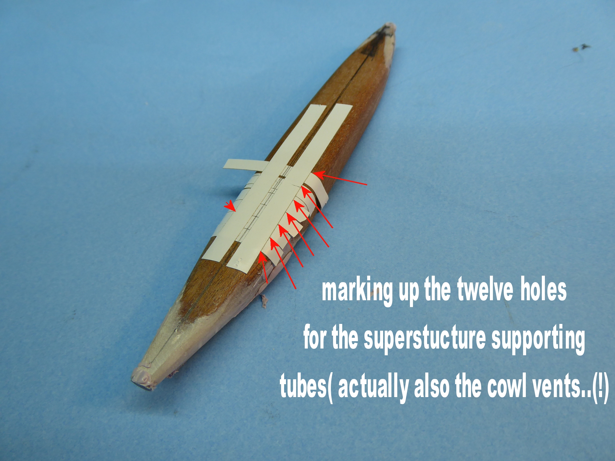

in the image below we see the ships superstructure quite clearly while the ship is still in construction
The uprights are actually cowl vent shafts as well as acting as supports for the flying decks
having established the hole centres for the cowl vents/ superstructure tubes
using then afore pictured tape lines( a repeatable means of spacing)
which can by eye be easily checked for right angles fore-and-aft as well as athwartships to get
them all in-square relative to the ships centre line and each other.
I needed to transfer these hole-centre marks to the decking pieces
I used translucent scotch 'magic' adhesive tape -which does not stretch or distort
to pin prick the holes through
Transferring these holes -- to allow some adjustment -I cut the holes as V-shaped notches
which can be easily elongated if / when needed

one short month or so later.... :wave_1:
there has been some tangible progress.... in small bites albeit--
but I am making the methods and solutions up as I go along.... :big_grin:

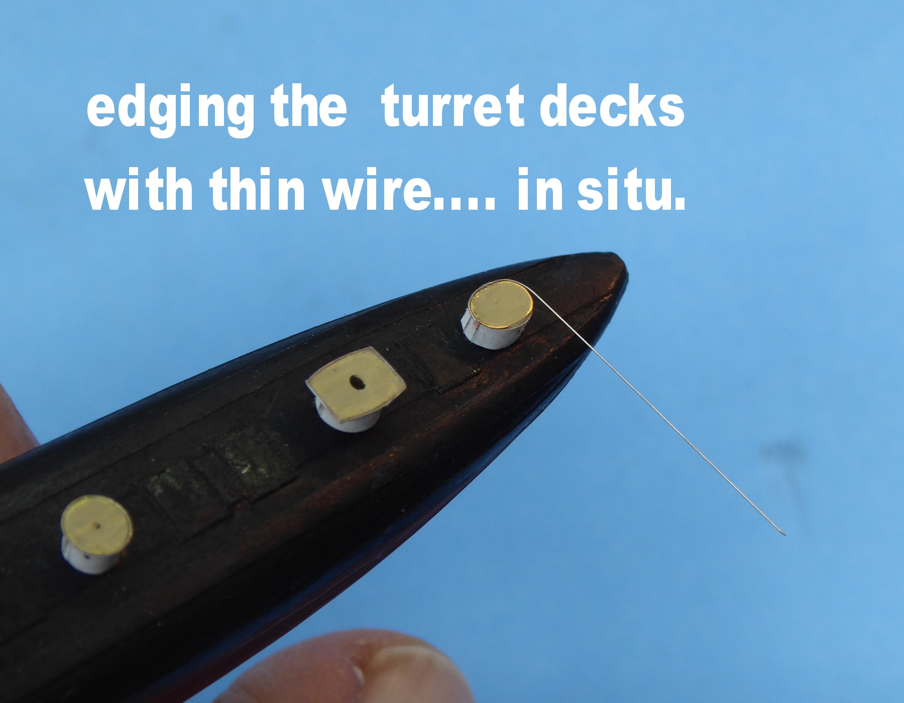

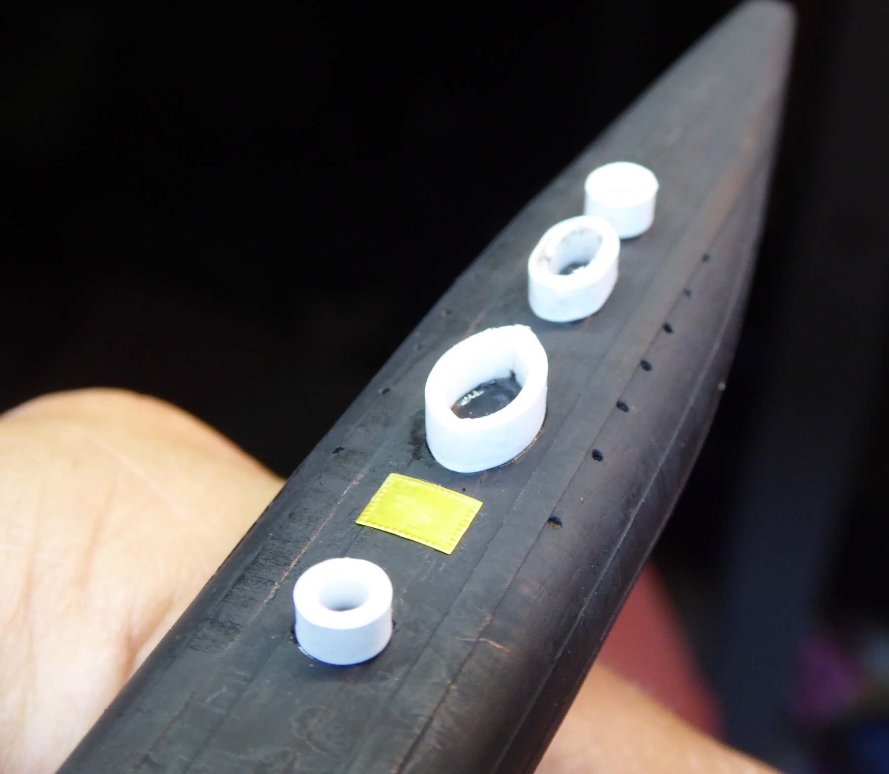

I created the various turrets of ( 15 year old!) styrene tubing of various diameters
==> in the hope that it was stable and had stopped out gassing !
The oval turrets were made by compressing the in-hot-water pre-heated tubing
and then cooled in a mini-vice ( everything is mini on this ship! )
the hatches on whalebacks --on the real ship-unlike the usual practice-
of raised coamings, timber , canvas coverings secured by battens with hammered in wooden wedges....
No Siree !
--that would interfere with clean discharge of any water on the decks....
nope - on these ' wet-deck' ships of minimal resistance-- ....
The hatches were near-Flush bolted down hatches of steelplate !!
rendering these in miniature was a potential challenge

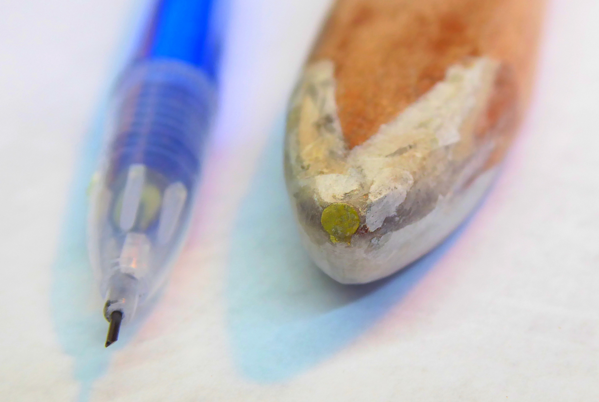

Fortunately --some generic PE ( l'arsenal ) .....that has been resting in my stash fro many years-( it may come in in handy some day...)
was indeed dimensionally spot -on-- with a subtle bolt pattern relief etched.
This was a real relief!=> repeatable and dead identical !

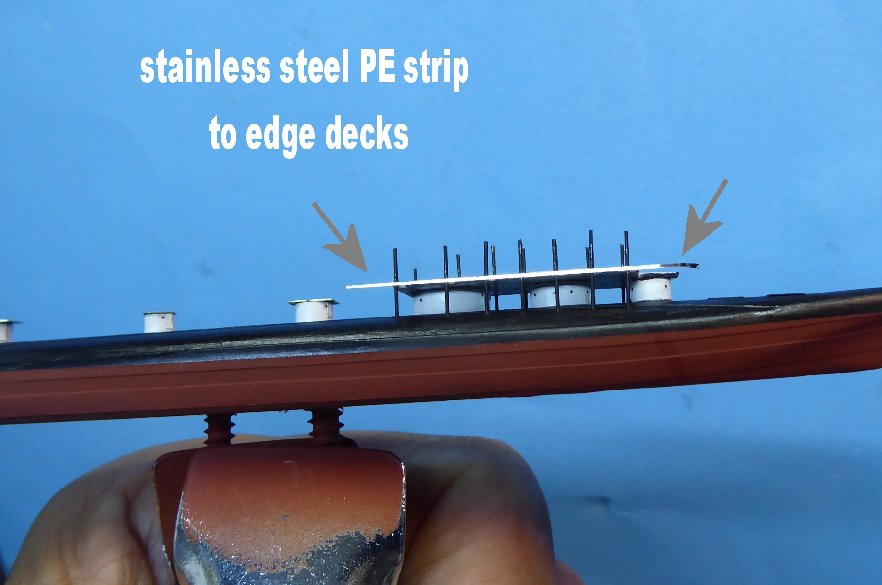

the turret decks were overhanging - of various shapes
these were filed to shape out of thin PE brass scrap
These were very hard to hold firmly without damage whilst being filed
I devised a sprung clamp via thick flat headed tweezers
... a bit gawky...-- but effective :thumbs_up_1: :thumbs_up_1:

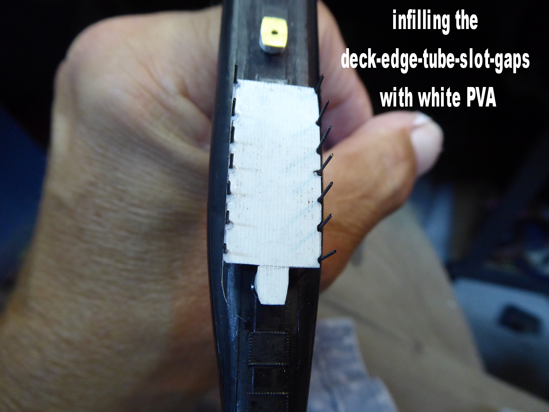

Using the first fwd and aft pairs of uprights,
the lower superstructure deck was testfitted
then the real work began of getting the uprights perpendicular...

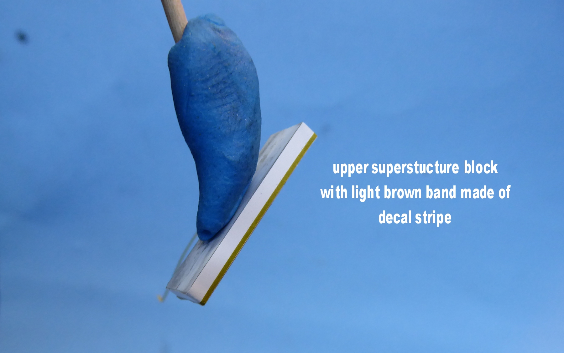

The upper accommodation block was made , wrapped in white thin vinyl tape for a homogeneous surface,
fitted with a wrap of light brown decal strip and portholes as well as flush fitting doors ( dark brown decal strip)
when the uprights had been re-re-re-re-adjusted, they were fixed with CA , the deckedegs were faced with a thin stainless steel PE strip
and the the oversize ( latitude to adjust!!) holes by the uprights
were backfilled with white woodworking glue
( a bit like PVA, but tackier and fasterdrying ) so as to self-level...
The superstructure block was added on the pre-painted deck
and the upright tubes trimmed off
as a repeat of the lower deck-- the deck was edged with brass , snipped off and backfilled with white glue
a tinned copper wire beading was added as per photos of the real ship
The lower deck had angled diagonal braces on the underside of the deck
Tricky in these small spaces (!! ) to install these evenly, at the same angle and length
without frustration of damage.
so I resorted to a simple solution, not quite as per the real thing -- but...
looks pretty convincing ( to my eyes....)

The decks for the turrets were bead edged with wire-- fiddly in situ--
but.... much easier to handle when attached to a ship!!!
