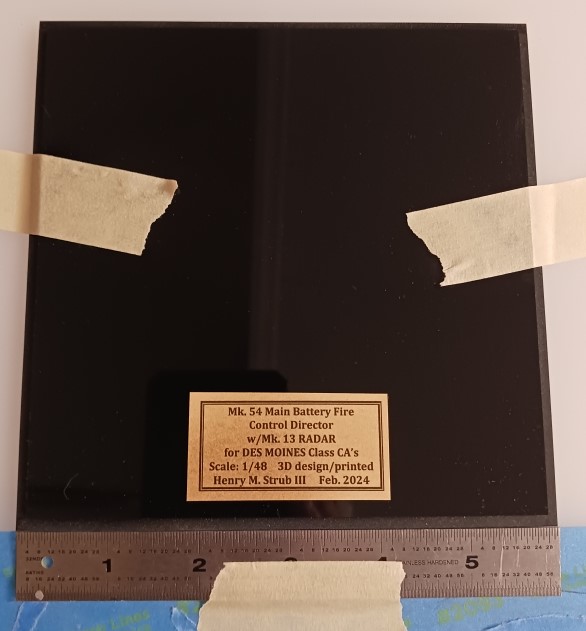

Here is what I came up with for my current series of large-scale gun directors/mounts/turrets:
2 Nameplates on Cardstock.jpeg (22.91 KiB) Viewed 7425 times

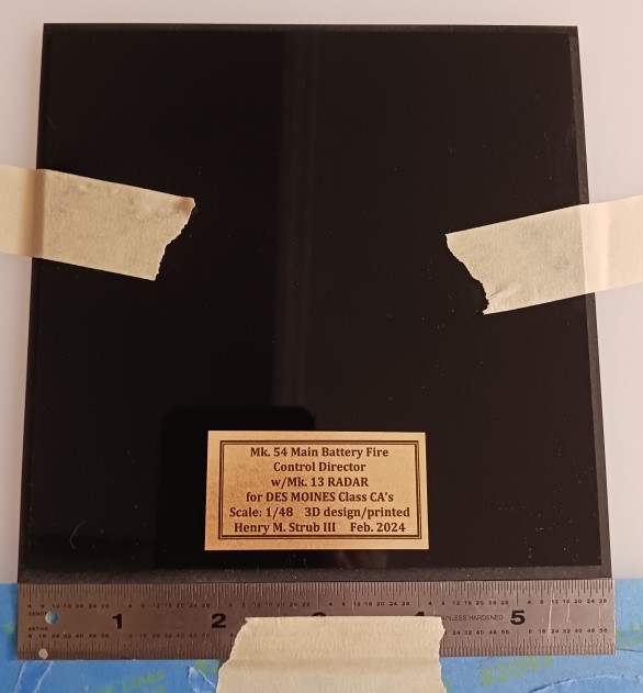

Using spray adhesive, I mounted the appropriate plate on the base plate as such:
Prior to cutting out and mounting the individual nameplate, I did overspray the cardstock with clear, flat lacquer, but this is not necessary and can be eliminated if so desired. The only thing left to do was to then adhere the model to the base plate and then the display case to the base plate. I have a recycled (saved from being tossed out by corporate!) paper cutter that I used to cut out the individual nameplates from the sheet. Scissors can be used (obviously... :whistle: ), but if you've had one or two or a six-pack, well....you get the picture :heh: Besides, a trip to the ER to have those pesky scissors removed from your head can break the bank on savings on this little project! :thumbs_up_1:
As for materials, my only purchase was a pack of Astrobrights cardstock (#99316) which I bought at Wally World for less than $6.00. It comes in 5 colors � Husk, Grocer Kraft, Honeycomb, Concrete, and Stone. I chose to use the Husk which gave a lighter �gold� look to the plates. I think there are 10 sheets of each color in the pack. I printed these nameplates on an Epson WF-7620 Inkjet Printer.

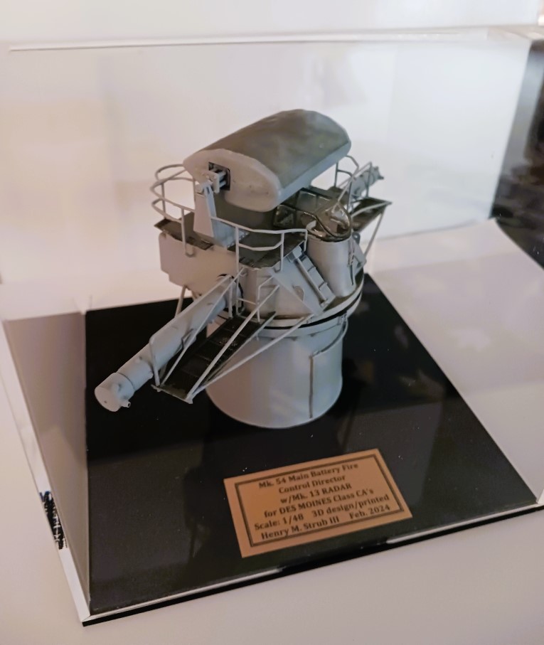

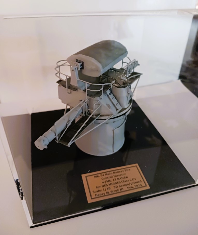

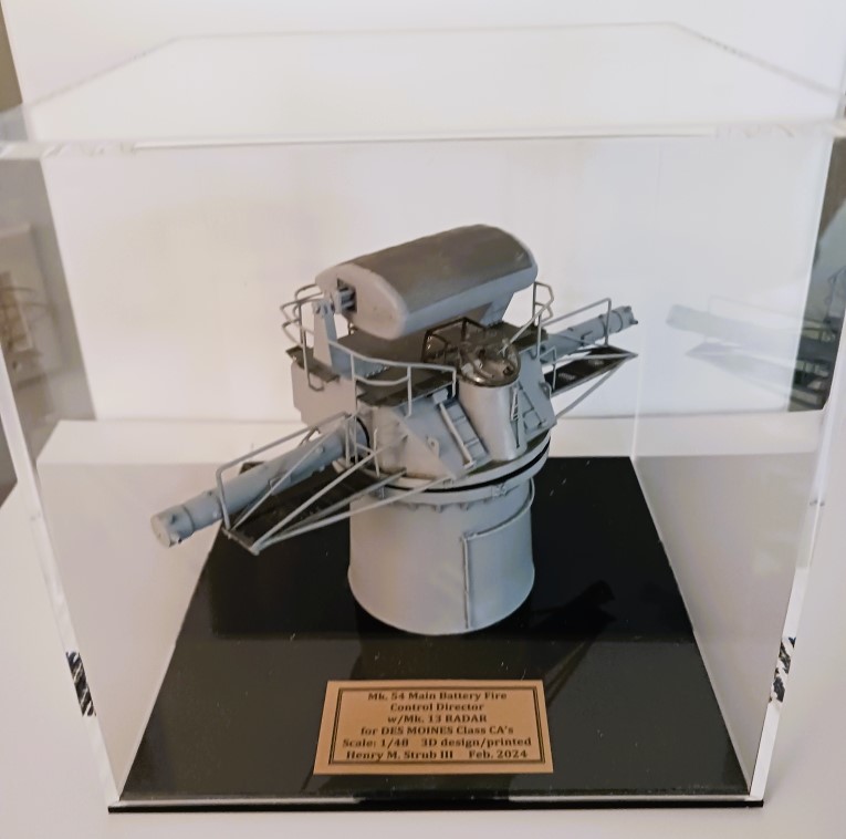

Here is the finished product awaiting placement on the display shelf:
Overall, I�m pleased with the results and the cost savings of approximately $40-$50 over purchasing a brass nameplate from a shop. I now have another half dozen or so display cubes to assemble using these nameplates.
