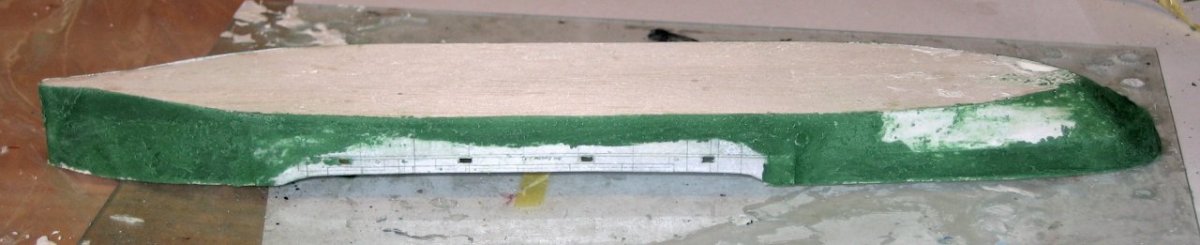

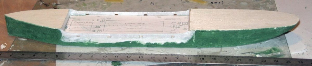

Hey

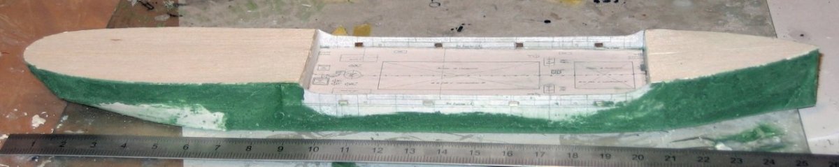

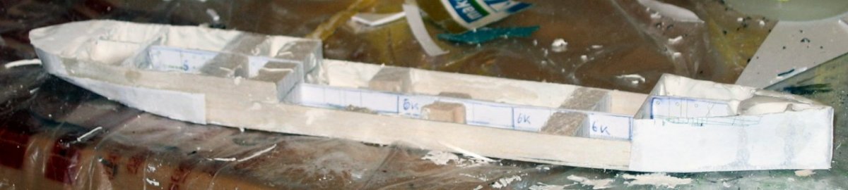

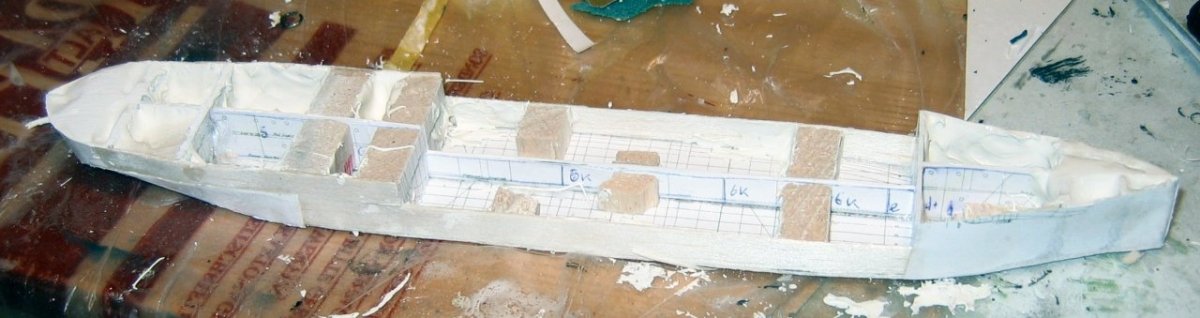

For my coastal convoy diorama I needed a small coastal freighter, and in 1/350 scale you have none ready. So, I finally overcame my fear of scratching a "whole damn ship", and went out to search for the plans, and found a free set of fine plans (at french historic service page) of a 1936-built, french 1300 tons coastal freighter Golo, which looked exactly like the one I imagined for my dio! I have no idea of the ship's destiny or service, except a guess that it was probably a navy auxilliary, as the 1935 plans provide quite heavy armament for such a small vessel - 2 75 mm and 2 37 mm guns. Anyways, I went to build it. After considering gluing some balsa blocks together and sanding it all, I finally went for a more classic frame and plank hull. I used 1mm ABS plastic from the local RC shop to cut the central support structure and frames, and 0.8mm balsa for the base plate. After gluing the frame, i planked it using 0.8mm balsa on the flatter areas, and CA-soaked paper for more curved ones. I filled the bow and the stern with some polyester resin, as well as using the same resin to reinforce the paper skin from inside, so no holes appear while sanding. Afterwards, I added the decks (same 0.8 mm balsa) and applied a lot of squadron green putty (the tube was getting to dry to use further, anyways) to fix the stern and bow form defects, and to cover balsa, as well adding some CA-paper false board in the middle area. Now it shall dry overnight, for tomorrow sanding session.
So far, I am happy with my first effort, and scratchbuilding looks much easier for me now - just took some 9 hours of non stop work to get where I am now..

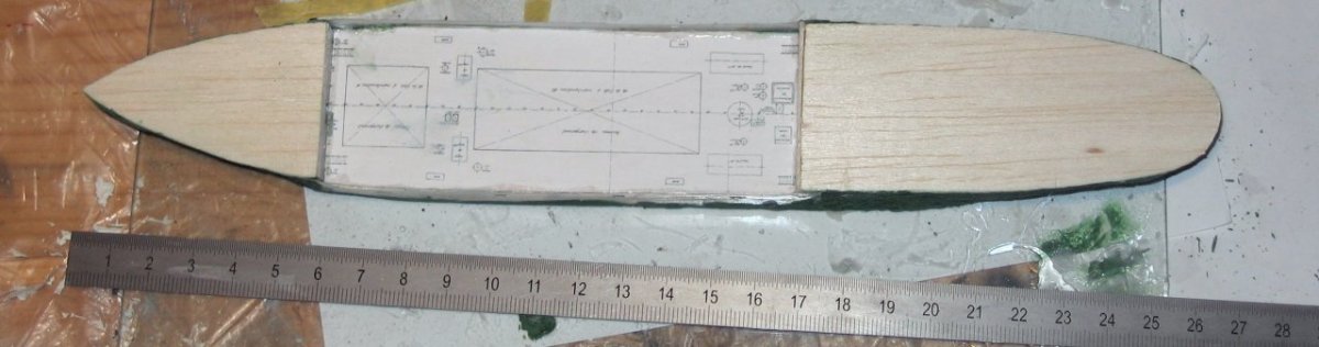

Post by PetrOs »

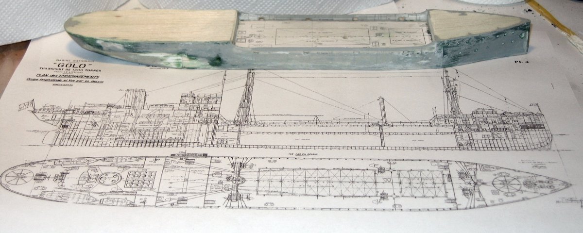

And 3 more photos

Post by PetrOs »

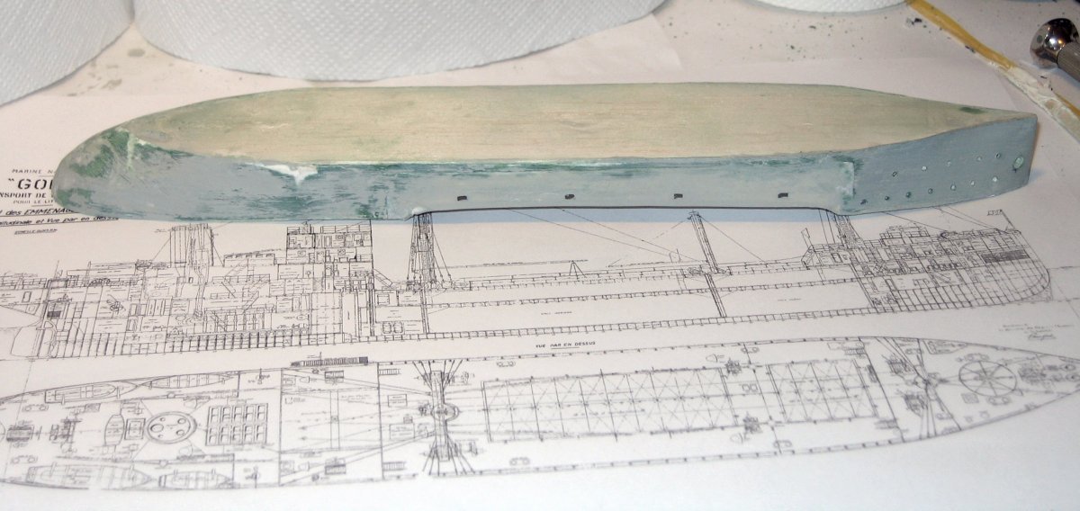

So, the hull is quite done, i am happy with its form and surface now. Only remaining job before painting it is to add more bulleyes in the rear part (24 to be exact, 12 per side), add water protection above them. Then I could go engraving the decks. In fact, I planned to leave the front and rear decks natural balsa color, but when priming the hull some grey primer soaked into the deck sides, so probably a paint job for me. Maybe I'll stain it and then partially sand it off..
I also ordered a large amount of fittings for it, including
Battlefleet models Winches, Capstans and Windlasses (in 1/700, but I could use the larger ones for the small cargo winches), L'Arsenal Liberty ship upgrade set (to share it with a planned Liberty ship), Corsair Armada Chocks, Battlefleet Bollards, L'Arsenal handwheels, WEM steering wheels... Just to make my life easier. I also located a number of boats from different kits to make some copies using polyester resin and kids modelling clay as a single-use form material (I plan to close the boats with canvas covers...). Thanks guys who helped me in selection!
As I have no idea who was the ship's user or how was its destiny, I just decided to use the IMHO most attractive paint scheme for a french pre-war shipping company (Thanks John@WEM for a list) G. Lamy & Cie.: black hull, red boot-topping, "yellow stone" superstructure, white boats. Shall bring some fresh colors to my shelves ;)
Further kits in preparation.

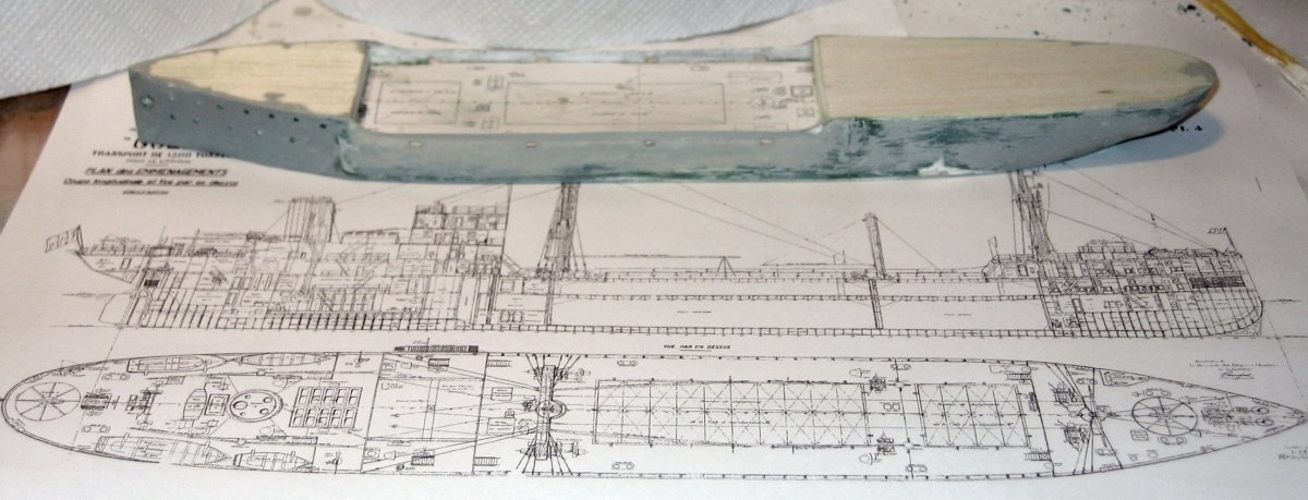

She's making some good progress now, all the bulleyes are drilled out, and Im adding the rain covers over them, and its about 80 of them..
