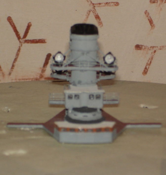

lower bridge is without railings yet to avoid damage while handling - I will add them at the stage of mounting the whole structure on the model

again - the vertical ladder will be added at the stage of 'total assembly'

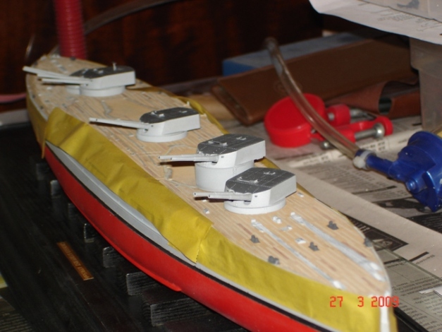

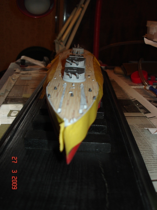

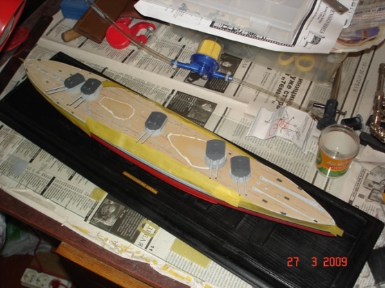

the sides of the hull are covered by masking tape - not to hide my faults (which are existing thought) but to save the casemates and guns from damage (and fillers dust) which can result at the stage of assembling everything

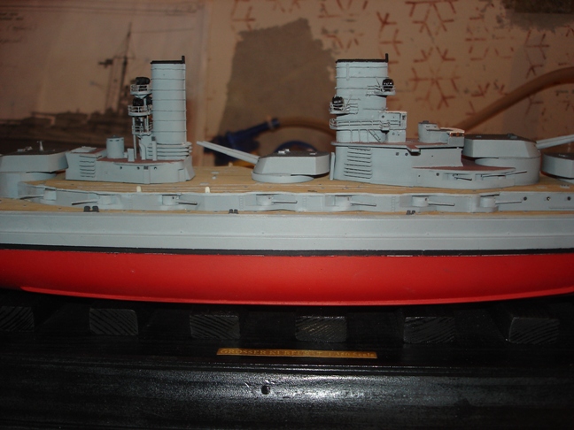

the name plate is cut from White Ensign PE set frame - WEM please continue writing ship names in such nice way :-)

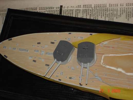

the 'white areas' on the deck are made deliberately to avoid putting glue on paint - it is made for superstructure

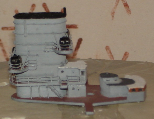

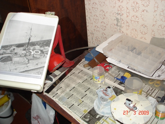

I use Tamiya rotating round tables for working with each piece of superstructure. Very handy I would say as they allow to rotate you bridges while you add PE, paint, etc. This photo is also a QUIZZ - guess whose MODEL photo I have in Copy Holder and use as a reference ?

Your deck looks very, very good.

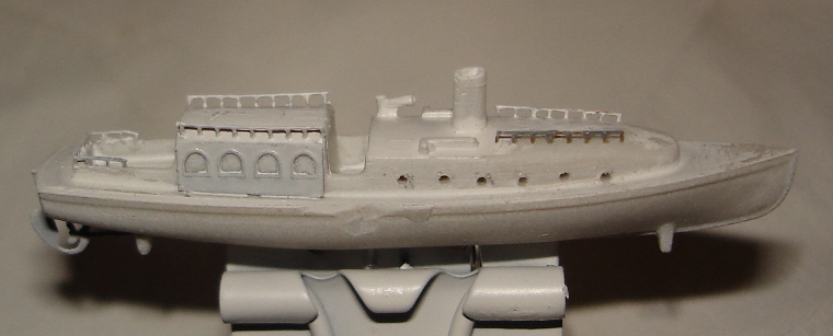

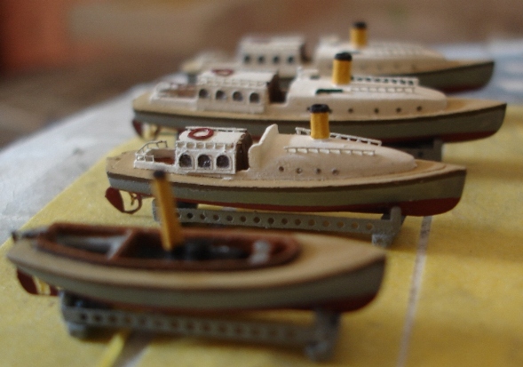

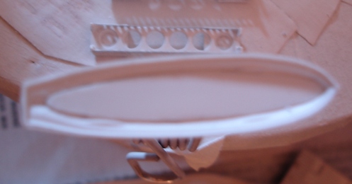

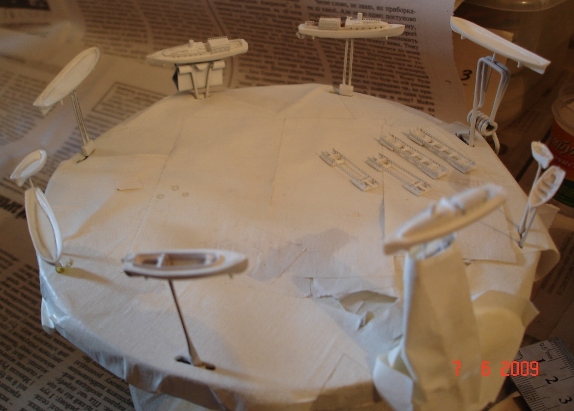

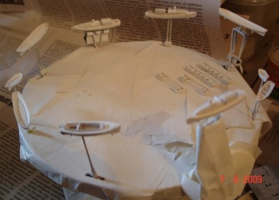

I am showing you Grosser Kurfurst motor boats and barkasses mounted on Tamiya rotating round table (masked with tape to avoid its cleaning afterwards). Very handy for priming/painting I would say - althought when glueing PE I had to fix the table manually since it rotates all the time :big_grin:
I scratchbuild interior floor of large barkasses and cutters cutting them from WEM PE frame :cool_2: - those boats are too large to skip those parts. I shied away from engrawing planking on them - but this is for next model. Actually my Grosser Kurfurst is a everyday learning ground for me - sometime I learn new skill but it is already too late to implement it - otherwise it will be my life-time project which I do not want :heh: .

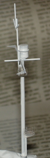

Masts tops are made from syringe needles which were filed to make them square at joint points and glued with CA. Now I keep fingers crossed so that they (masts) do not fall apart when I start rigging.
Next update probably when I finish the model (end of summer :heh: :heh: :heh: )
Yevgeniy
A little dent on hull will be filled later
WEM pre-Yutland mast

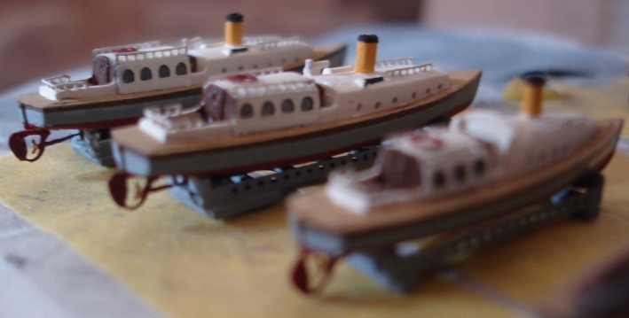

Large barkasse - floor (do not know nautical term in English for that) cut from sheet of plastic
Smaller boats (cutters, right?) - floor cut from WEM PE frame - very good material - flexible, thin, just perfect
All boats together mounted on Tamiya rotating table which I highly recommend

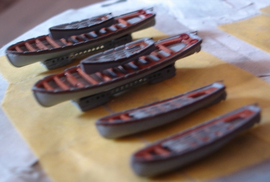

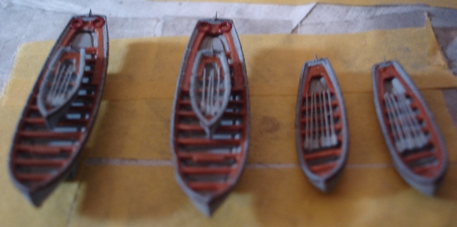

Well, more than one month and a half have passed from the moment I started the motorboats/life-boats on my Grosser Kurfurst and yesterday I finished. Working 1-1,5 hour per day took me around 40 hours to make these boats. When I had 2-3 modelling sessions before the end I started hating my boats but when finished I feel satisfaction.
Now when they are finished I can return to the hull and finally start mounting all ready assemblies there. Hopefully I am 2-2.5 month before completition of this model.
I shall thank Jim Baumann for photos of his boats in high resolution which Jim has kindly provided to me which were my base reference and Peter Lienau (aka Ingura) for his continued support with reference material and sharing own research on Kaiserliche Marine. And thank you all guys helping me to decide on oars placing in Main Forum :big_grin:
Any constructive critisism is more than welcome - I will try to do better on my next models (I know one big mistake with motorboats rear railing - they were just different - but I already done them after discovering the right version and just can not force myself to re-build - see correct version here download/file.php?id=11334&mode=view (kindly provided by Ingura) ).
Yevgeniy

Islander
Posts: 66
Joined: Thu Jan 10, 2008 5:19 pm
Re: My in-process Grosser Kurfurst photos
Post by Islander »
Hey Yevgeniy,
Nice boats!
John
Cadman
Site Admin
Site Admin
Posts: 3636
Post by Cadman »
Those are like little models by themselves. Great work. :thumbs_up_1:

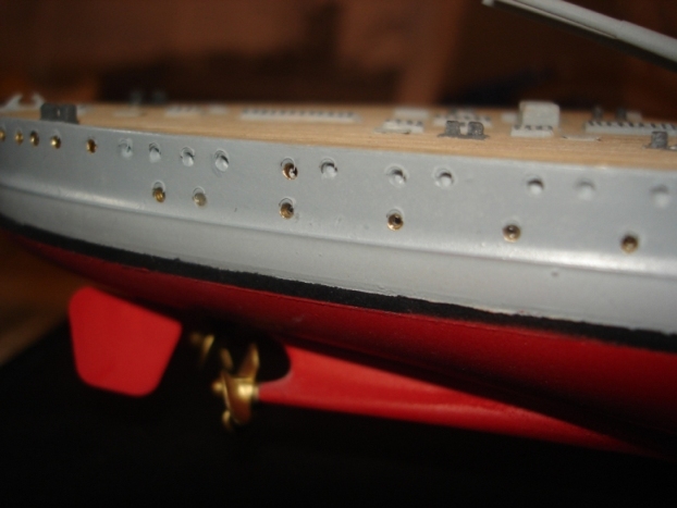

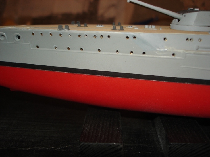

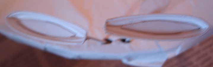

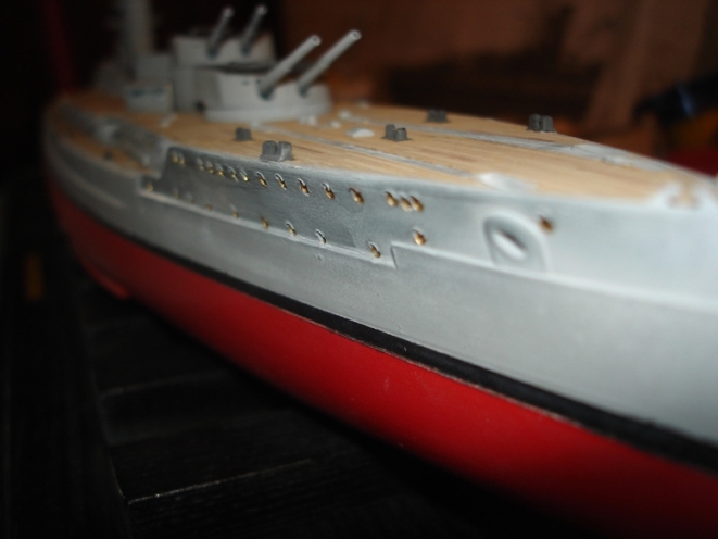

Some updates with photos - I want to show you the portholes for which I spent some 3+ weeks: 2-3 modelling sessions painting them black then in a year during this build :heh: deciding that it is wrong and remaking them.
I drilled them through, painted the edges bronze, made eyebrows from 0,1 mm wire (from telephone cable). I have not succeeded yet with glazing (only 6 portholes were glazed so far) - my private photographer (my brother) came unexpectedly so I did not have time to glaze it - will finish today.
Rear superstructure is glued in place. The forward one is not glued yet - just installed for today's photosession.
I am getting nuts as I run out of my time-table to finish this ship by the end of September when my study begins. Today I read Vladimir Yakubov method of making realistic chains out of PE chain (cutting for individual sections and connecting in the right way) and I can not abstain from replacing the chain I already have. Omg will I ever finish this project?

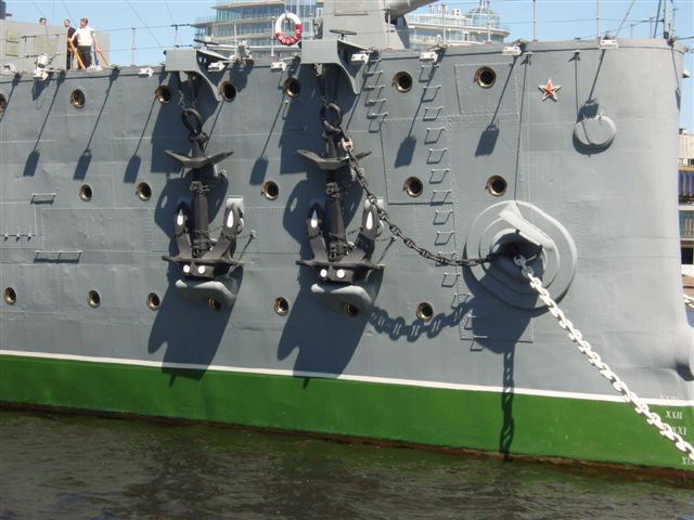

The last 2 photos are: Aurora in St.Petersburg for you to see brass portholes and Konig real photos - eyebrows on Russian and SMS ships were obviously different.
Yevgeniy
I had time to glaze only the lower row of portholes (by Micro Krystal Klear). Upper row is not glazed yet. I had problem painting all upper portholes as I had to install suppots under the deck not fitting the hull. Now these supports are on the way of portholes - I will leave them not painted - as closed from inside
Forward superstructure under battery deck is not glued in place yet - just placed for photo
I was happy to find that on real ship portholes "showed brass".
I found this photo only after I made all the eyebrows on my ship - alas! But still I hope I reached some resemblance.
Posts: 12473
Painting the edges in brass certainly helps to bring them out from the monotonous tone of the hull! Looking good!
