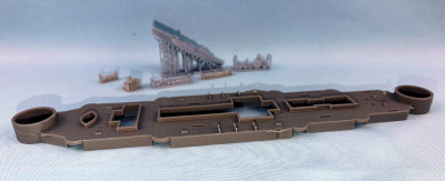

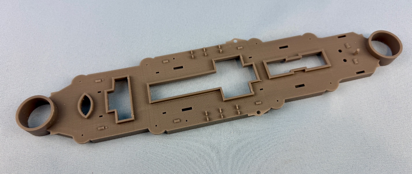

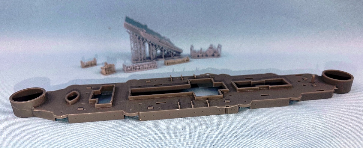

It does indeed seem the casemate (not casement, sorry not sorry :big_grin: ) deck has been damaged at some point, as before the #3 barbette the pole to string part of the wireless fit on should be double that height. Seems to be a one off, but you could always ask for a replacement. (Also thanks for pointing the bulkhead thing out, I was unsure whether to include that or not, and in the end I went with what I did because I reasoned that you still wouldn't see anything inside - and thus through the opposite side of the hull without lighting - I hadn't thought about looking at the mount directly from the beam. We will implement it in further designs.)

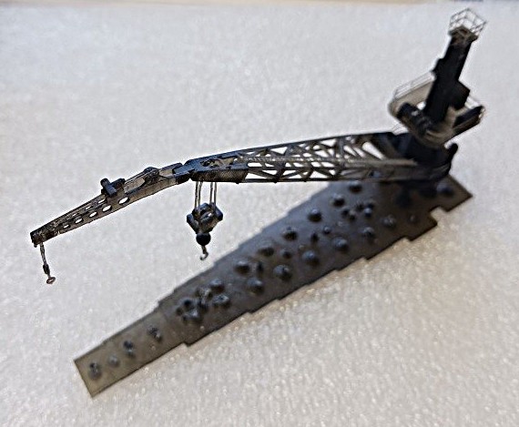

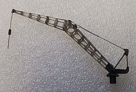

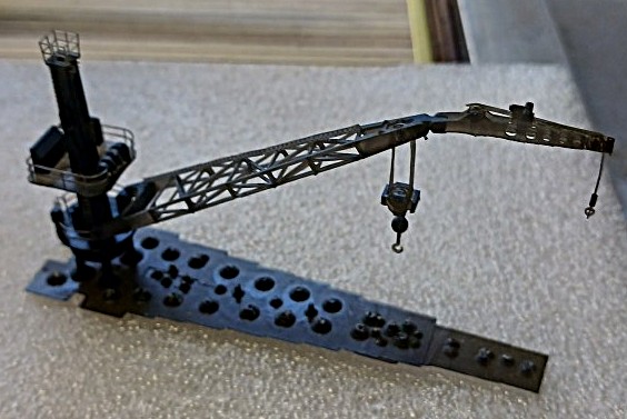

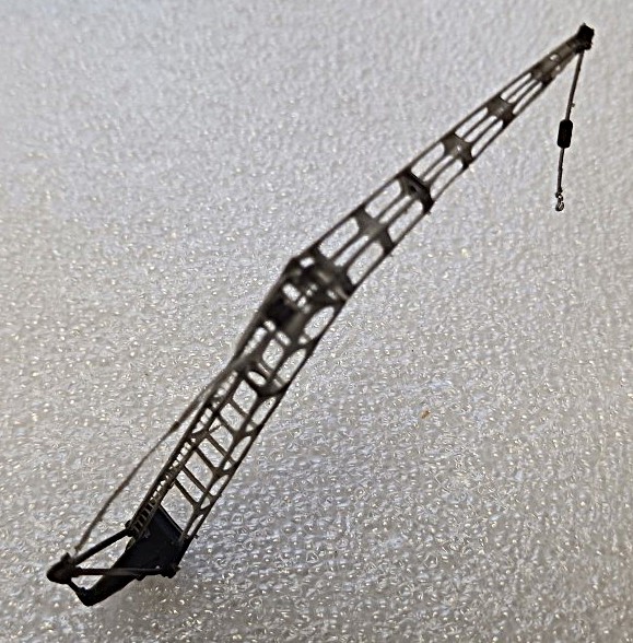

After reading over Martin's review, I think he's given a fair assessment of the kit overall. I have had intentions of purchasing one of the tripod versions of this kit and modifying it to my own ideas about how it might have been modernized as many of us discussed in the LEX thread earlier last year. So, as a small diversion of time/energy from other modeling stuff, I went ahead and 3D design/printed all the parts I would need for this including the aircraft crane and boat cranes as I envisioned them - good thing I did, as those 3D files are now history due to my own lack of understanding Win. 11 file directory when I upgraded my computer last year (live & learn :doh_1: )
Anyhow, here are photos of my 1/350th scale cranes -
I know that I have much more time for designing parts than the commercial guys do and I'm not criticizing 3D Wild, just pointing out that highly detailed parts CAN be printed and this improve the overall appearance of the model. I sometimes have surprised myself with what can actually be successfully printed at the smaller scales!
I would add that if 3D Wild does make improvements to the kit, they should consider redesigning their cranes especially as these are quite prominent in the overall appearance of the model.

Update: In my review I mentioned that my casemate deck had some damage. I reached out to 3D-Wild, with photos, and they promptly sent me a replacement, which arrived today. It has no visible flaws and appears to be - outside of the damage - a better print overall than the original part.
I just wanted to acknowledge the great customer service by 3D-WILD, and thank them for the quick response!
