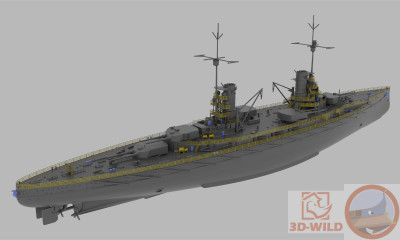

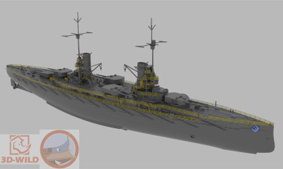

Greetings fellow modellers,
for those of you wondering what happened to the Lion kit, do not worry, it has been postponed due to other commitments. But since these two were always planned to go together, here is her German counterpart for the 110 Battle of Jutland anniversary. The High Seas Fleet flagship, SMS Friedrich der Grosse.
We plan to release both kits at the end of June, with a good discount if you want to order both at the same time.
I only have one thing bothering me for this one, and it has to do with the boat stowage. German practice with the en echelon arrangement called for stowing boats in between the two midships turrets, but this would be unpractical if not outright impossible when going out for action. I believe these would have been left being altogether. The thing is, this leaves the battleship without any kind of lifeboat, except the handful of life rafts, of which too I'm not too sure about the number at the time of the battle of Jutland. I know what kind of boats she was supposed to have at completion, but if anyone knows what would be done with them when clearing for action, that'd be greatly appreciated.

MFS,
The copies of the British intelligence reports of 1918 printed in "German Warships of World War 1" printed by Greenhill Books stated that when going to sea in expectation of going into action, German warships left their boats in harbour. However, photographic evidence post Jutland suggests that not all ships e.g. DERFFLINGER and SEYDLITZ complied with this. Recall though that the original plan of the German fleet was an operation to "roar up" merchant shipping in the northern North Sea, not to have a "punch up" with the Grand Fleet.
The best bet would be to provide the all the boats and let the model-maker decide by finding what photographs of the ship may be available.
That said, I doubt very much that they would have been stowed in such a manner on the operation that they would have impeded operation of the main armament. The photographs of the two ships above show that what they were apparently carrying were well out of the way of the main guns.
wefalck and maxim may know better though and I hope that they will comment.

@81542 Thank you for the insight. I can see the point of not wanting to put ashore all boats on the part of the sailors, on the other hand ships like Derfflinger don't have the issue of boats interfering with arcs of fire - Seydlitz does, but to a lesser extent than the Kaiser class.
My hunch for FdG is that they would have removed the innermost boats, those closest to the back of the turrets when rotating out to the sides, and those on davits at deck edge, because those would have suffered the most from blast overpressure.
I thought the same, the problem lies in identifying those spots. The other issue is, Ithink the complement of boats would have been reduced compared to when originally built; I haven't come across any definitive photos yet for German ships, but I know for a fact that was the case on some of the British ones. For example, when working on Lion last month, I discovered the boat stowage between the first two funnel was completely deleted - there's a photo of that portion of deck where the ships' chocks used to rest that has been plated over, you can still clearly see their outline, and Carley floats had been added aft.I believe that they were removed to avoid a splinter hazard, but also because two 3'' guns were added on deck abreast of that position, so that could also have hindered gun operations.81542 wrote: Sat Jun 06, 2026 8:08 am I doubt very much that they would have been stowed in such a manner on the operation that they would have impeded operation of the main armament. The photographs of the two ships above show that what they were apparently carrying were well out of the way of the main guns.
