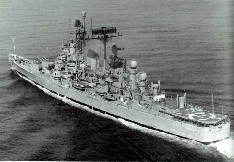

Here's a general picture of a guided missile heavy cruiser.  Looking at this, please consider where SPS-48 would have gone and what kind of addional/modified masts would be placed where.  Also, where the flag and helo facilities would go and what they'd look like.

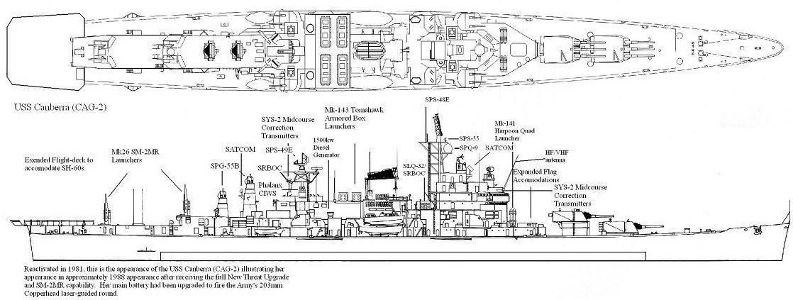

Here's some drawings from Friedman's Cruiser book. Some more visuals should help get the ideas flowing.
For fun here's a comparison between CA-134 and CAG-1. I think I might do CAG conversion to a Des Moines class CA.

Thanks for the quick input and the pictures. They are pretty good and pretty helpful. For clarification, the time frame would be the early to mid-1980s.

Hey, guys, here is my idea so far for Canberra.
First, I really want to thank some of the powerhouses here on the forum for commenting on this. I understand neither the Boston nor Canberra were available for reactivation or modernization. Nor if they had been available, would they have been brought back. The Des Moines were far superior ships in most ways. The only advantage these had over the Des Moines was that they had AAW facilities constructed, and they had breach loaded guns. The breach loaded guns would have made for utilization of Copperhead and 8" RAP rounds. The propulsion plants and all other systems would have needed to be brought up to speed like the Iowas had been, so I offer that might have been easier than people make it sound. It does sound like Boston was run pretty hard and hung up wet.
I apologize for a few inconsistancies between the top-down and profile views. I spent the most time on the profile view, so that should be consulted closer.
There are still a few differences that there will be between this drawing and how the model will turn out.
The Harpoons might still be too close to Turret 2. I know they had no problem with the 16" overpressure, but they were further away and did not risk being directly affected by the ends of the barrels like this arrangement is.
Let me know what you think and please ask questions. I really hope to get this concept down before I get to fabrication.
You can click on and download a little higher resolution picture from my deviantart page. That way the lettering is a little easier to read.
http://wiskybb64.deviantart.com/art/Can ... -135365569
