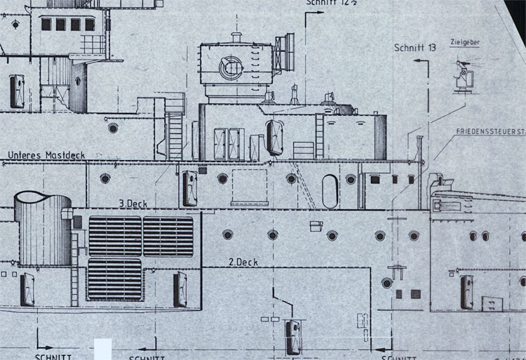

Is there an article somewhere that helps us newbies turn plans into actual parts? Specifically, I cannot make a clear connection between the two dimensional plan and a three dimensional superstructure. I have many ship building books(Coker, Brian King, etc.) and all of the Scale Ship Modeler magazines and have never found any really helpful techniques that address this issue. My plans of the Bismarck have numerous details covering up the sides of the superstructure and I have difficulty deciphering what is important. The plans have clear top views of each deck and numerous front views but the side view is one full size sheet of the 1/100 ship with every gun, boat, railing, fitting, etc. Should there be a side view without anything obscuring the decks and bulkheads or does everyone see past these distractions with out hindrance?
For example, this side view show the forward superstructure of a 1/100 Bismarck. I am confused as to which dimensions should be used to determine the height of each deck as there appears to be multiple reference points that could be utilized but only one would be correct. I would certainly like to duplicate Norberto's fine ship as seen here:
How would you explain to new modeler how to get the critical dimensions from a set of plans?
Thank you for your assistance,
tweety777
Posts: 594
Joined: Fri Sep 25, 2009 6:28 am
Location: Near Veenendaal, The Netherlands
Re: Turning plans into reality
Post by tweety777 »
The dashed lines are lines that aren't visible.
For example, if there is a bulwark with behind it a wheelhouse, the bottom of the wheelhouse (and also the deck) will be drawn as a dashed line.
The distance between arrow A and arrow B in your picture is the thickness of the deck.
Greetings Josse

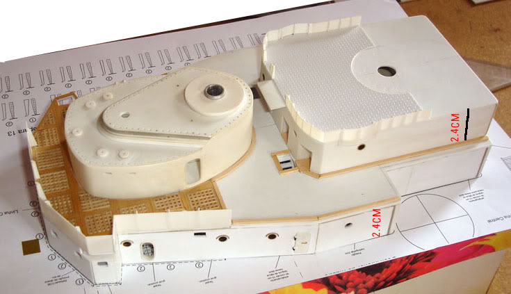

WELL the distance of lines in your drawing are few exagerate.
seeing the plan i have the distance is about 1mm.
follow the straight line who mean the piece finished
the height of decks is represented in the image bellow :smallsmile:

I have been following all the Bismarck builds that I can find, but even there I notice a divergence of what I see on pictures of the ship vs what is being modeled or maybe it is just the modellers have different interpretations of what they are seeing.
My foremost difficulty is that the sideviews that I have are not very precise(I have two 1/100 sets, both in German that only has one full length side view of the ship, the picture I submitted above is a section of that drawing)and it seems that the drawings should be more precise to render an accurate model.
So, who does have an accurate side view of the Bismarck? Are their different drawings to choose from?

you can follow the height of i show in image. this are extremely correcr. 2.4 meters in the original Bismarck.

Norberto, I am now going through all of the Bismarck plans that I have, including yours and these are the only drawings I have for the side views of the Bismarck.
Is it possible to construct an accurate superstructure from these 6 drawings?
This is the only drawing I have of the funnel in 1/100 scale. That's why I was interested in your drawing and knowledge of the funnel dimensions and details as I do not have a clear side view other than the full length starboard side view of the ship.
This image here is about 1/300th scale I guess and I think it is supposed to give me an overall port side view easier to look at than unrolling the 9 foot plan. It also shows that the funnel is obscured for most of its size.
Since these drawings represent the only side views of the Bismarck that I have, from following the other builds here and elsewhere, I am attempting to figure out what else is needed to get on with my ship.
