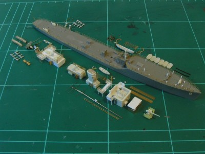

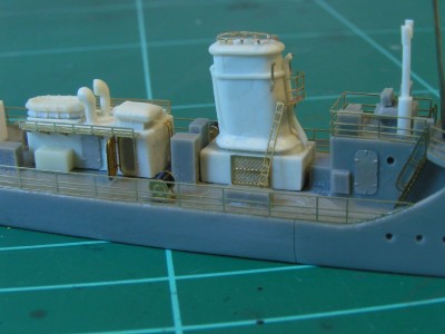

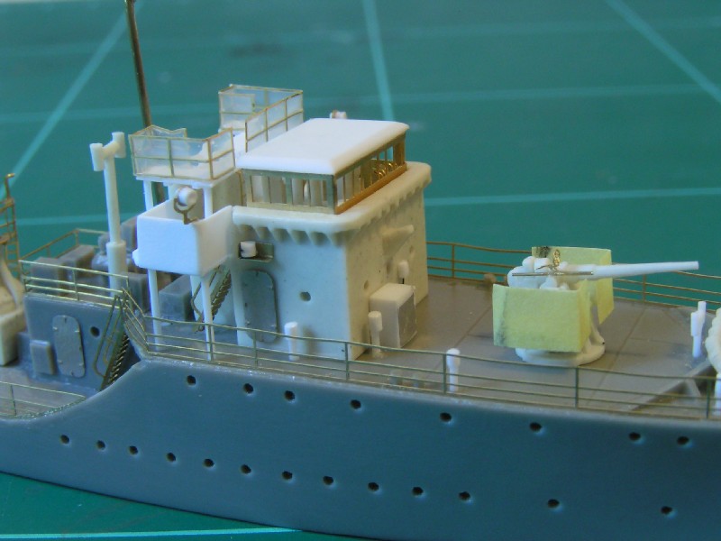

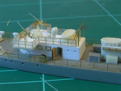

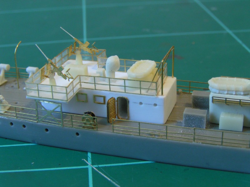

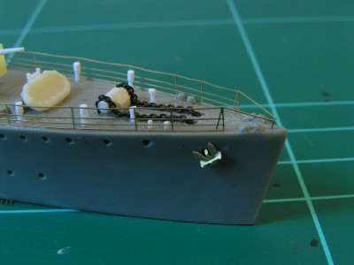

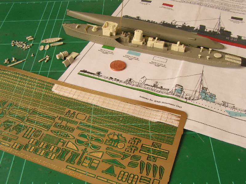

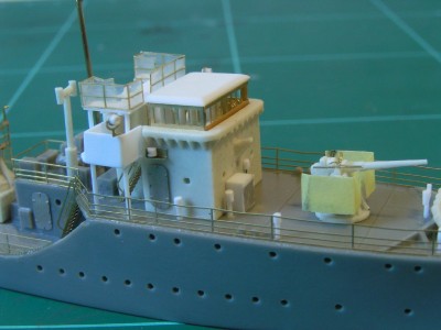

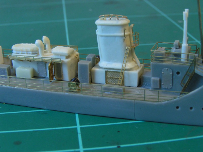

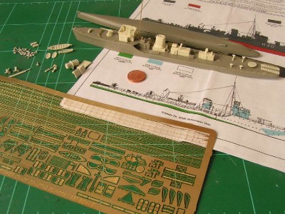

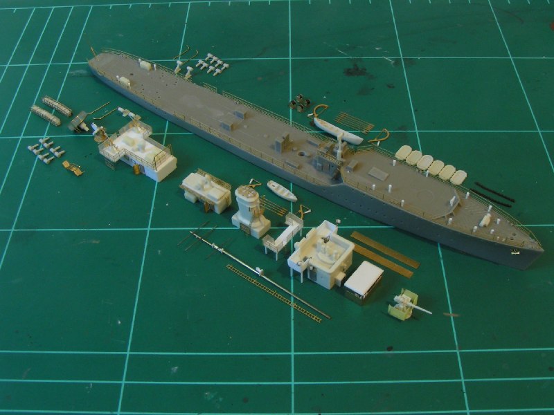

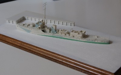

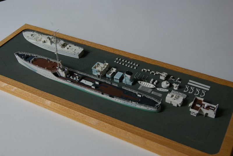

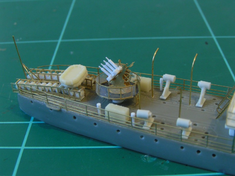

Hi all,
My WEM Kingfisher class sloop is still waiting her final completion since I have start building her at the beginning of 2009. I decide to build her as HMS Shearwater in her colorful Western Approaches scheme. When I start my research I found out, that the kit represent the Kingfisher class sloop in her pre war fit, so there is something to rework to build her in her 1942 war fit. The main difference is the larger aft superstructure with two 20mm Oerlikons and a modified bridge, with bridge wings and a searchlight platform and a gun shield for the 4� QF gun. Next to this main modifications I have added some extra details like vents, position lights, lockers, etc.! I have used brass rod, plastic card and rod as well as some extra PE parts from L�Arsenal, GMMM and from my spare box. I have used some photos of mid and late war Kingfisher class sloops to build the aft superstructure as exact as possible. The dimensions are only guess work, but in my opinion it looks well. Some 1.5 to 2.5mm plastic cards were used to build the basic structure and 0.5mm thick card for the deck with its AA gun platforms. The same plastic card was used for the bridge modifications. Instead if plastic card, paper was used to build the gun shield. The paper was covered with super glue to get a firm part with smooth surface. Even though there is something to modify WEMs little sloop is a really nice kit of these more or less unknown type of coastal escort. The Kingfisher class sloops were build in three groups between 1934 and 1939. Next to Shearwater are Kingfisher, Mallard, Puffin, Kittiwake, Sheldrake, Widgeon, Guillemot and Pintail. Because of their size and their inefficient steam turbines (less range) the ships mostly served in coastal waters. One of the workhorses, HMS Puffin help to sunk U-16 in 1939 and a midget submarine in 1945, HMS Pintail was lost in 1941. HMS Shearwater was commanded from March to October 1943 by Nicholas John Turney Monsarrat, RNVR, the author of �The Cruel Sea�
The nearly finished model dozed for nearly a year in my modeling yard. After I have finished HMS Glowworm in April I decide to finish Shearwater at first, because it is an interesting subject and the most finished model in my stash. So I have started to paint her in a three tone WA camouflage scheme. As usual I have used WEM Colorcoats for the basic painting and Vallejo acrylics for decks and details. Now the main paint job is done by airbrush and brush painting, also a display is in progress. I hope to finish her as soon as possible, so stay tuned.

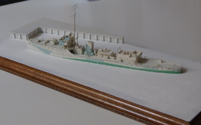

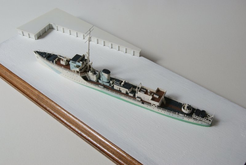

Hi again,
thank you very much for your interest and your very kind comments. Ther is only less progress during the last weekend. So far, most of the brush painting is done. It lacks only some small details like position lights etc.
I deliberate about some details for the quay. Mmhhh, maybe something like a street lantern, some bollards along the quay, lets see.....

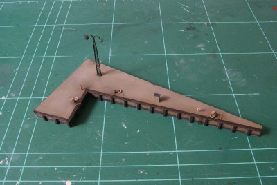

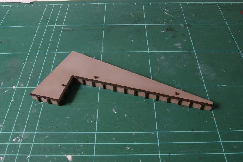

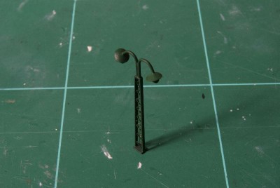

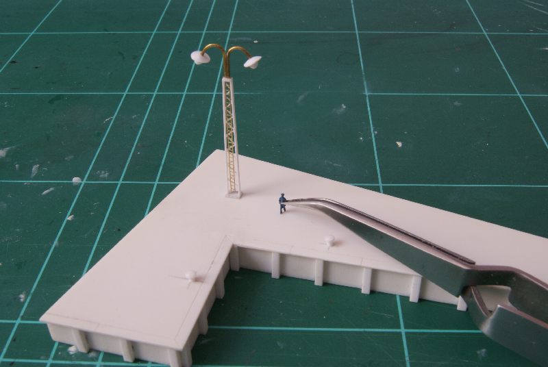

Hi all,

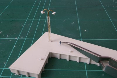

today there's only a small update. I have build a street lantern and add some bollards along the quay. Mmhh, the lantern could be 10 - 15% smaller, but it was tricky enough to build the lantern.
Comments are welcome

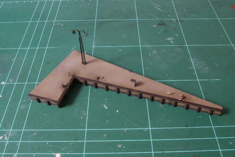

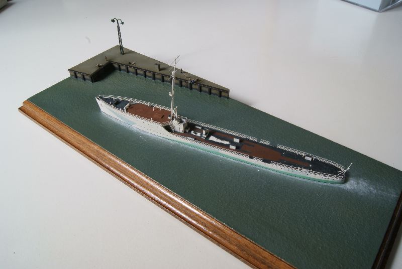

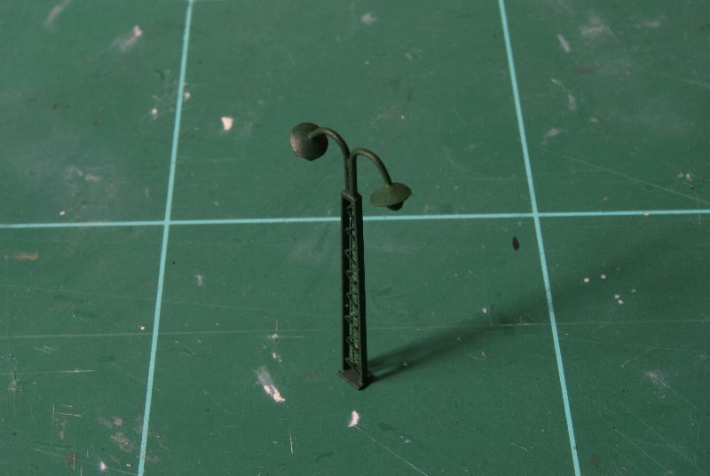

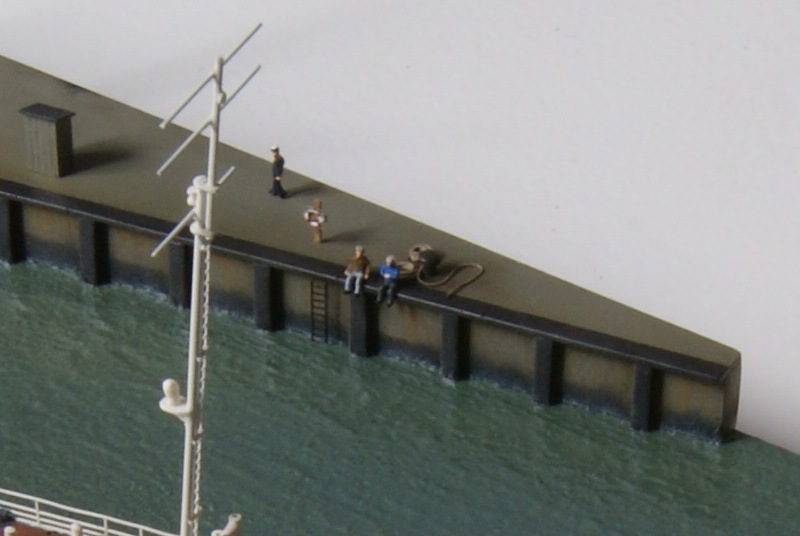

Hi all,

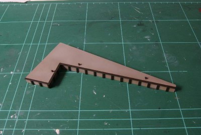

There was less time for modeling during the last month, so there is only small progress to show. But at first let me say �thank you for your kind comments�
Because I have no solution for the pennant no. at the moment (the no. should be grey, but I have only white and black decals) I start painting and detailing the display and the quay.
The street lantern. The quay painted with base colors. The finished quay with lifesavers, ropes, ladders, street lantern and a phone box. The finished base, the ship is only in place to check the effect of the wake. I named them Statler and Waldorf;-) Some more figures will follow.

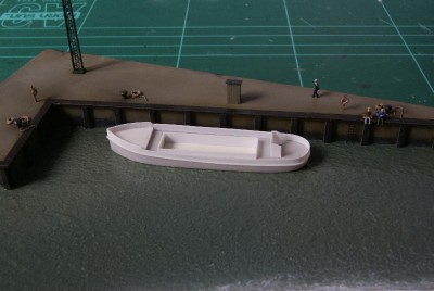

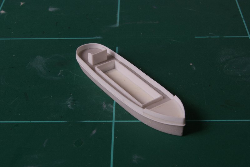

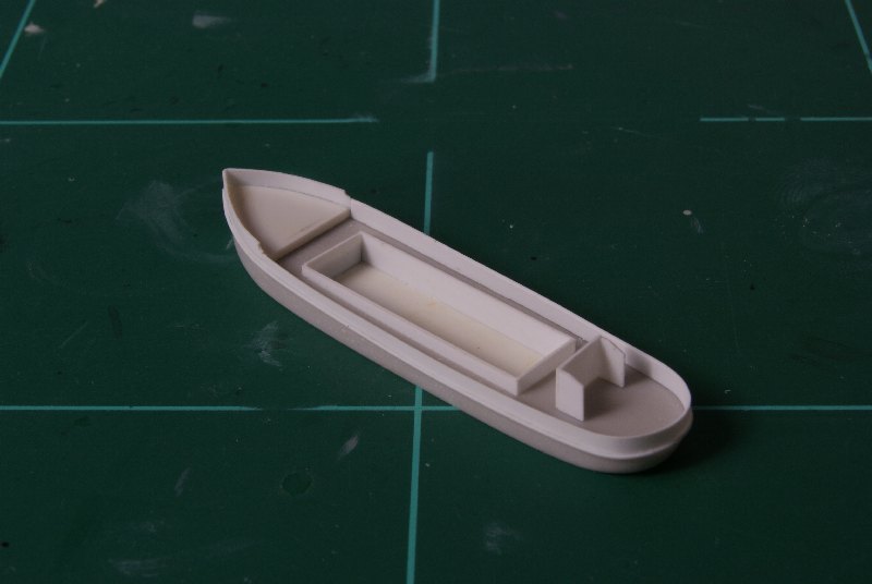

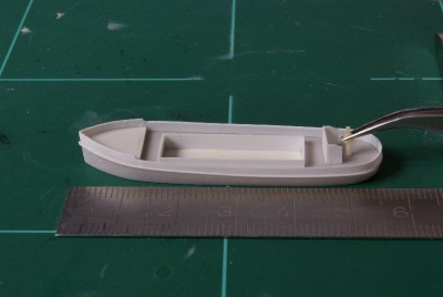

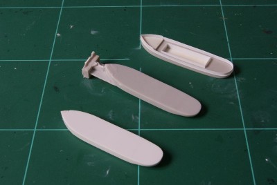

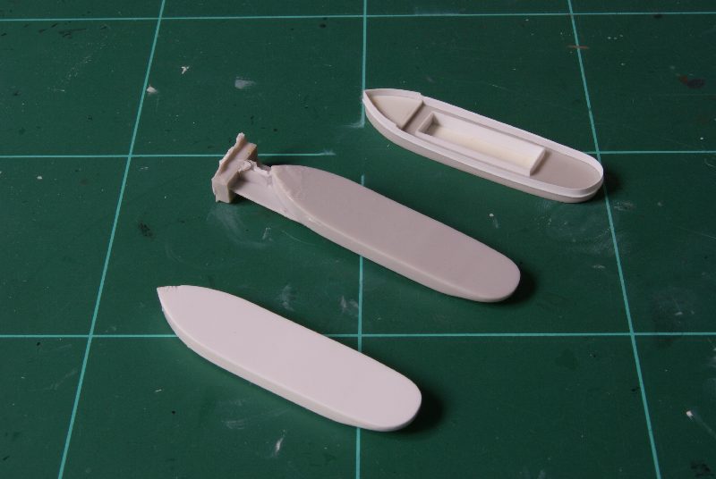

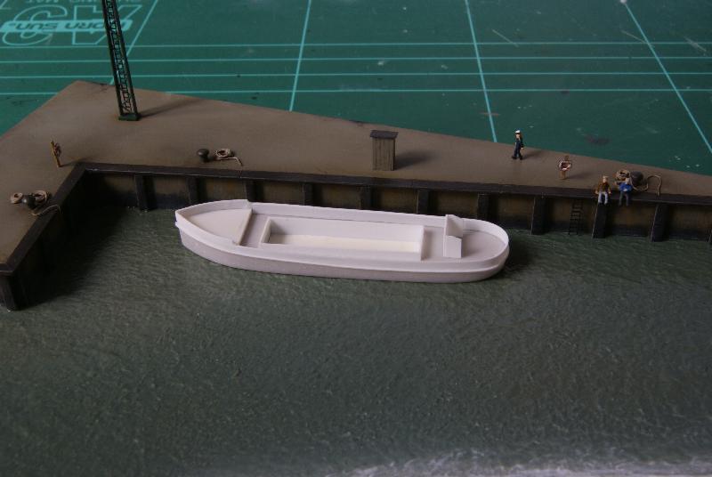

Hi all,
@Roy, unless I can see your HMS Shearwater in Telford, I hope to meet you there!

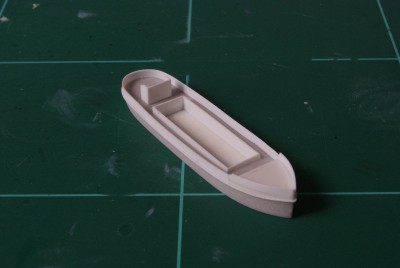

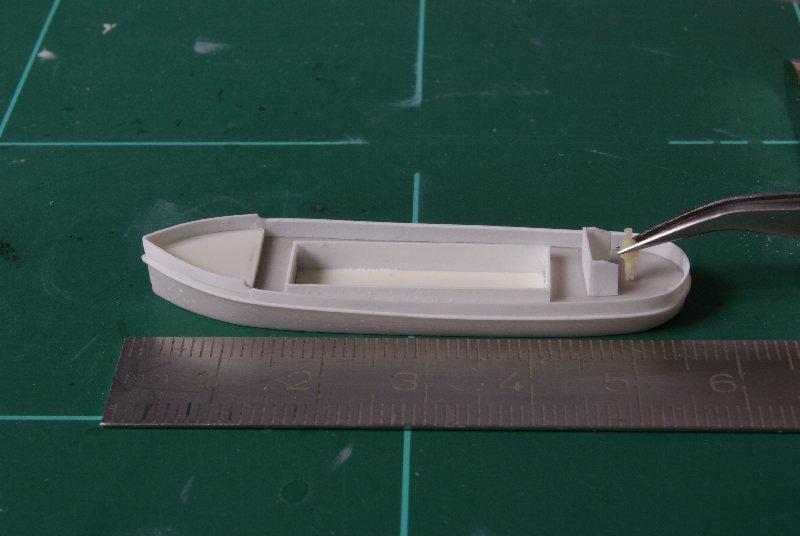

There are less harbor accessories in scale 1/350 on the market. Well to get some, there is only one way - make your own ones!
To add a small friend to my HMS Shearwater and some following models I start building a supply barge. When I start shaping the hull (made of some layers of plastic sheet 0.3 � 1.0mm thick), I thought to make some different hull shapes of these master pattern. I ask a close friend to cast some parts from the master for further processing in different shapes.
The first one is the supply barge, a sailing cutter will follow someday.
From above to below: current appearance, cast and master Ok, this is what the barge looks so far. I add a small platform at the bow and bulwarks and stringers along the hull. To give you an impression of the dimension I placed a ruler and a L�Arsenal sailor on the photo. The helmstand aft is only basic so far. The hold is open, but I will make a separate cover. It was really fun to work on this small model, I hope you like it!
