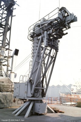

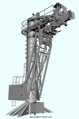

Here is another example of how CAD modeling can help with creating a physical model.
In the 1960s the US Navy began installing a FAST (Fleet Automated Shuttle Transfer) system on ammunition ships and missile cruisers. When operating correctly (rarely, if ever) it could transfer a missile every 90 seconds.
We had a FAST crane on the USS Oklahoma City CLG-5 when I was aboard, but it didn't work. It was removed in mid 1971. This set the date for my 1:96 model of the ship - I wanted to include the FAST crane.
Unfortunately, I have never found drawings or blueprints showing dimensions of the thing, and the last one went to the scrapyard or the bottom of the sea decades ago. So I had to work only from photographs. I had a few closeup photos, but they didn't show all of the thing. I have a dozen or two fuzzy images taken from a distance that show some additional detail.
Working from these photos I was able to determine the approximate height, length and width of the assembly. Over a period of 39 days I made 48 pages of sketches with "photoguestimated" dimensions, and slowly built up the 1:1 scale CAD model piece by piece. I tried to get at least six sets of dimensions for every part from the photos. These were averaged, and then corrected to the nearest 1/4, 1/2 or whole inch (the original was built in feet and inches).
Because I was guessing the dimensions, I had to change some parts several times when newer pieces just didn't fit with other parts created earlier. I don't know how many times I reworked the catwalk at the top! This is probably the greatest advantage of CAD - no material wasted if you make a part incorrectly. However, the amount of time lost from restarting is about the same.
The test of accuracy of the model came when I placed it on top of the missile house and used it to create an operating diorama. I had to reposition the assembly a bit from my first guess position (12" 1:1 scale) in order to align it with the missile strikedown hatches, but the assembly worked pretty much like the real thing for positioning missiles over the strikedown elevator! So the dimensions must be close. Now I can make 2D drawings (maybe the only such in existence?) and build my 1:96 scale model with confidence that it will be "right" (well, approximately right) the first time.
This is a photo of the FAST gear on the OK City.

Here is an image of the CAD model.

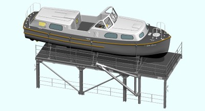

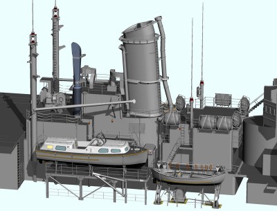

More of the midships superstructure - the boat decks. These are a good example of how complicated modeling can be on a ship that was in service for a long time.
I have the original blueprints for the boat decks. The ship had two 40 foot utility boats nested on the port side and a 40 foot personnel boat nested over a 40 foot utility boat on the starboard side. It also had double level gravity davits with a 28 foot motor whaleboat nested above a 28 foot personnel boat port and starboard. However, the ship was top heavy after the guided missile conversion, so it went into the yards for a 15 month weight reduction program.
Both double level davits were removed, and replaced with the one single level gravity davit for one motor whaleboat, as described here earlier. On the starboard boat deck the 40 foot utility boat was eliminated, leaving just the 40 foot personnel boat. On the port boat deck the upper utility boat was removed and was replaced by a 28 foot personnel boat. These modifications scrapped much of what was shown in the original blueprints and I have found no drawings of the modifications.
Once more I had to examine a lot of photographs to determine just what the new boat supports looked like. Fortunately, the basic dimensions were the same as the original drawings, and only some details had changed. The framework was still the same as the original, but the boat nests were quite different.
The port boat deck
The port boat deck
Above you see the port boat deck, minus the 28 foot personnel boat (I haven't modeled it yet). The 40 foot utility boat is cradled inside the support framework for the nested boat.

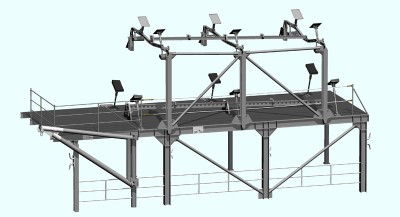

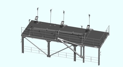

port boat deck framework
The image above shows the boat cradles without the 40 foot utility boat.

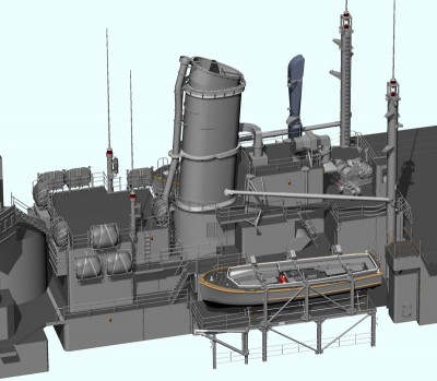

superstructure port side
The image above is the port side of the midships superstructure. There are still lots of details to add. The picture below is the starboard side. You can see how the boat decks fit into the design. You can also see where the motor whaleboat davits were located relative to the boat deck.

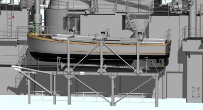

starboard boat deck
starboard boat deck
This image shows the starboard boat deck with the 40 foot personnel boat. Below is a picture showing the boat cradle and tie down arrangement. It is much simpler than the port side arrangement.
starboard boat deck
starboard boat deck
