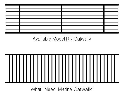

I'm looking for a source for photo etched 1/96 catwalks, but the kind normally found on ships... Specifically those that look like this:
Can anyone help with this???
In a severe pinch I can use the railroad catwalks, but man I'd sure prefer accurate ones!
:help_1: :please:

Okay, I feel bad for not monitoring this thread more closely. Some answers: width should be somewhere near .25", call it 6 to 7mm.
I need lots and lots (and lots) of catwalks for this project - building from strip plastic is certainly possible, but not what I would choose, except if backed completely into a corner.
I've purchased a length of model RR catwalk intended for the top of a box car. The diagram at the top shows its design. I can and will use it if I have to, but I'd sooo much prefer accuracy.

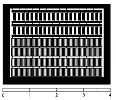

While awaiting delivery of my PE "kit" from MicroMark I went ahead and assembled a test stencil. I made it usable with generic catwalk and inclined ladder so it will be instantly usable if it comes out well.
Any comments or criticisms? If I'm on the wrong track I want to know now!
