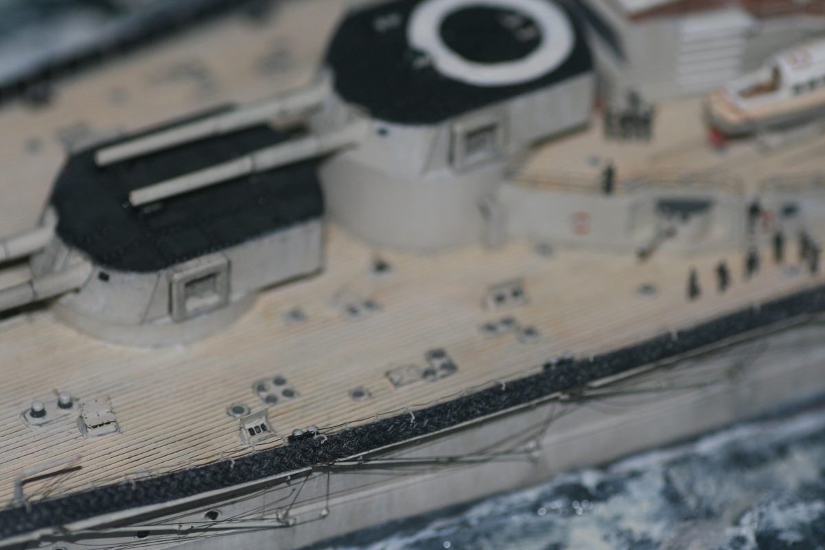

this is my shoelace effort:( albeit back in 1999/2000)-- I reckon I would improve on it now,,,,

Bill Livingstone used shoelace--albeit its not that textured...
