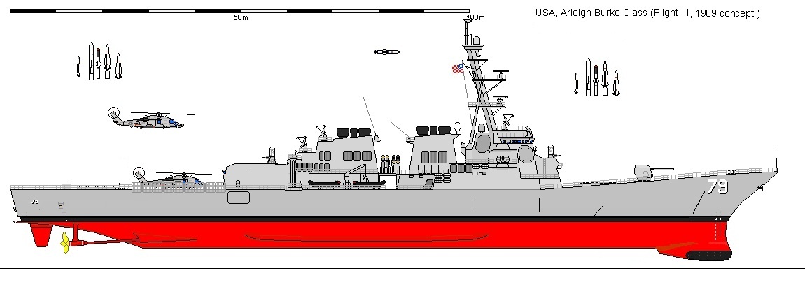

Now, instead of the CG(X), the DDG-51 Flight III developed in 1989 is being redesigned in FY2012 to accommodate a larger radar and the associated equipment (such as cooling plumbing and other requirements) to try to approach what CG(X) might have been able to do. However, because these radars weigh so much more than the SPY-1 the hull was designed for, the Flight III is also looking at being delivered at the beginning of a 30 year life with no possible growth margin.

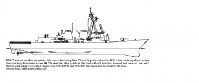

here is the line drawing I found, while doing some research... I know it is very basic, but it a good starting point...
As david said, this is the way to go, that looks like an enlongated burke.
So what would be add to the design?
RAMS, MK38.. ???
What time frame should this have be started.. ???
My thoughts are around the early 90's as they started to phase out the Older Crusiers such as Truxton,branbridge...etc..
Thanks.
RAMS, MK38.. ???
Thanks.

Hello! I'm the guy on Shipbucket and Secret Projects who dug up the line drawing that is seen in this thread and I would love to get a copy of any info you find on the Ship so that I can improve my current WIP Shipbucket version [Image Link to the current WIP].navydavesof wrote:I am a member of the Naval Engineer's Society so I will see what I can find from their 2008 Symposium on the subject.

I remind you that I'm drawing the design as it appeared in the 1980s, not a hypothetical 1990s version.ex-navy wrote:Tim, welcome, that site you speak about has some great design, however, people get wrapped around the looks then function. With that said, your design has a lot of merit and as you said a work in progress some thoughts for you to consider. As Navy Dave has described this was a study to make a crusier using burke tech. So my first thoughts would be the forward Super Structure needs major re-work may be you could rework a FLT-IIA Bridge and forward structure.
Ok with that all said, my plans are to build this design in 1/350 so let get the basics down:
LBP of 620 feet.1. length should be 670 feet which would be slightly bigger then a tycho and CGN-38 Class.. so in 1/350 it would be about 24 "
She's got a repeat of the Flight 3 Ticonderoga systems fit. This means that she's got two 64 cell VLS blocks with a 3 cell crane in each.2. two sets of VLS 48 cells Forward that would be primary containing ESSM, SM-2, and ASROCS. The rear not sure if should be 64 or 120 Cells, with load out being mostly SM-2 and Tomahawks.
Yes, well, Ticonderoga fit.3. Forward and AFT Gun Mounts (spruance fit)
The drawing shows two Mk-141s, which fits with the Flight 3 Ticonderoga systems fit.4. Quad Racks of Harpoons x 4
The Mk-38 is presumed, but not placed. I'm not sure where exactly they would go, and thus I'm not placing them yet.5 CIWSx 2. Mk-38 x2, RAMSx2,NUKLA's and SLQ-32
It's on the drawing.Not sure if The SPS-49 should be retained or not..
Yes.6. Helo storage and handling for sh-60 x2 with RAST
Tycho class?Electronics starting point would be what the TYCHO Class is getting during refit...
thanks

Bruce - I know you did not intend to, but by distributing a shipbucket based image without the scale bar or title block, you are in violation of the Shipbucket Fair Use Agreement. It's a very permissive agreement, but it is one who's enforcement is starting to be applied. As a staff member in the community I would be much obliged if you credited the drawing.
I also point out that the Flight 3 Burke has been drawn, so you don't have to kitbash quite so horribly to draw what you are drawing.
ex-navy
- Posts: 182
- Joined: Sat Sep 05, 2009 8:18 pm
Re: CGBL Design
As I said Timothy you are the expert on drawing...
Since you reference the burke flt III here are the drawing's I found.... and the DDV-7 purposed design
these designs are enlarged burkes....., while the DDV-7 is a burke flt I without Aegis.... Consider the following:
The flight III had a lot of potential but was rejected for what was called the DDV-9 design that would become the flt IIA current Config... as I said and repeat.... doing many things does not equal success, but doing one thing does.. I think this platform (CBGL) has merit and should discussed with a focus on either AAW and Command & Control;
Even go one step further have the lead ship function in that role, have another function as ASW/Convoy protection, while the third could be NGFS/Special OPS focus, fourth could have increased helo capability and last one TBD... ( I purposed a class consisting of 5 ships)... the time frame would be the lead ship being placed in service around 1995, the second 1999, the third 2002, the fourth 2004 and the last one if funded 2008...
