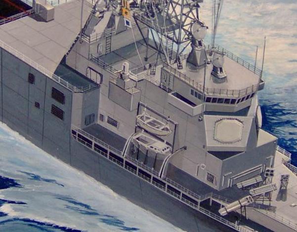

Hey, guys, does anyone remember the "strike cruiser" from the 1970's/1980's? A good friend of mine sent me a picture of the conceptual painting (below)

I have been building a few CGN/CSGN/USS Rancocas super structures lately, and I am getting pretty good at it. Since I have a few of them I was thinking about building a Long Beach converted to house the Aegis weapon system in its prototype "strike cruiser" configuration and one of the follow-on strike cruiser-class some time later this year. Even though the Long Beach was to be a "strike cruiser", it and the CSGN strike cruiser-class are not the same. The Aegis Long Beach would have just been so bad ass it would have fallen into at least a "strike cruiser" if not a "heavy cruiser" type.
What kit should I bash to meet the needs to make a model of this fine ship type?
Here is what Vince Peicyk painted in the 1980s while employed at Lockheed Martin. This was a visualization of what was developed for the CGSN-class.
I would like to hear what people might have to say about:
- What kit that should be used to make a model of this?
- What accessories/after market parts?
- What kind of equipment and weapons do you think it would have wound up having in the 1980s/1990s if actually built?
- Does 709 feet really sound right? That's nearly as big as the Long Beach with less armament! Is this really the recommended length? The picture's length to beam ratio is more like 1/8, so at 76', 608' is more proper for the ship's length.
It should make an interesting companion build to the CGN-42 to builds someday later this year.
In the meantime please watch the CGN-42 build!

As an aside, the painting doesn't completely match the specs. For instance, I see 8 Mk141 Harpoon launchers (6 forward + 2 aft) and no ABL's. Also, there's a lot of available deck space for additional equipment.
What scale were you considering?

You must consider that this picture was painted in 1976. As with any ship design there are changes, before, during, and after construction. Because the picture had to be photographed at an angle to eliminate glare, some of the proportions are distorted. What appears to be harpoon launcher at the side of the ship just forward of the deck house are a bit larger than the "harpoon" launchers one level up and in board. Could they be tomahawks prior to the armor boxes of the 80's? Sad to say, Vince is no longer around to ask.
Bill

carr wrote:As an aside, the painting doesn't completely match the specs. For instance, I see 8 Mk141 Harpoon launchers (6 forward + 2 aft) and no ABL's. Also, there's a lot of available deck space for additional equipment.
I am pretty sure the long Harpoon-looking launchers you see there are representations of the original tomahawk anti-ship missile launchers. TLAMs that are in VLS canisters are inside of tubes, and I am willing to be they are the same tubes they slid inside the Mk143 ABLs. Those may very well be the same as what would have been stacked on the Mk141 type rack launchers.
I would like to do a 1/350 of the strike cruiser...maaaaaaaaaaaaaybe even a modern version reflecting the Navy's current CGN need, too? :heh: One way or the other it's going to be a big bi@#h of a model!

With the '80s version it would have these boats on the sides of the super structure.
Has everyone else noticed that the super structure is standind up so tall? It's way up there, the SPY panels starting at the O-3/O-4 level! Wow!

At the time of the illustration, the only SPY-1 mounting was aboard USS Norton Sound, and that was rather high up, and radars had always been mounted high to increase range until that point. That and the projected need for space for the computers on the time may have driven the idea that the arrays, and therefore the superstructure, would be high.
Starting at the 0-3/0-4 probably felt low at the time, considering Long Beach and the converted CGs...
