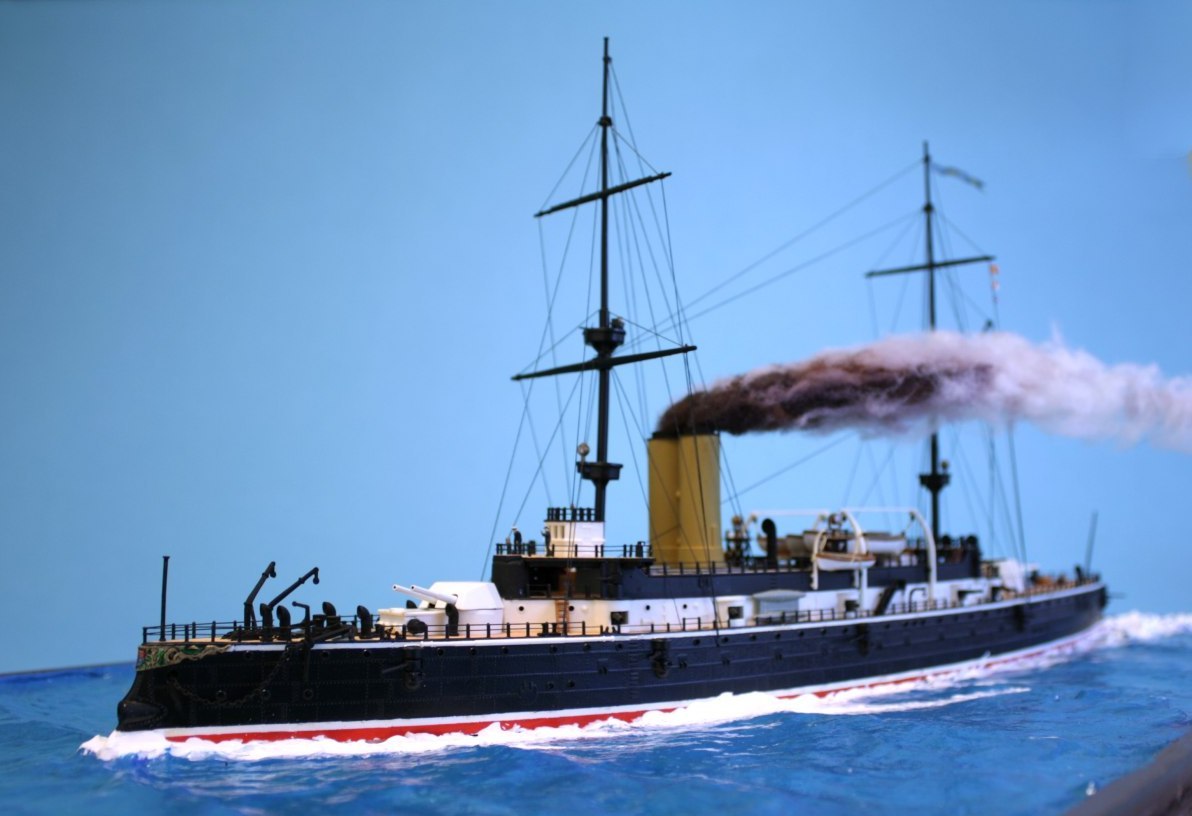

Here's a comparison that uses a ship model. I believe the effect is fairly dramatic.
A single shot in which the bow is in focus but the stern is not.
This is a product of focus stacking that includes the above shot.
