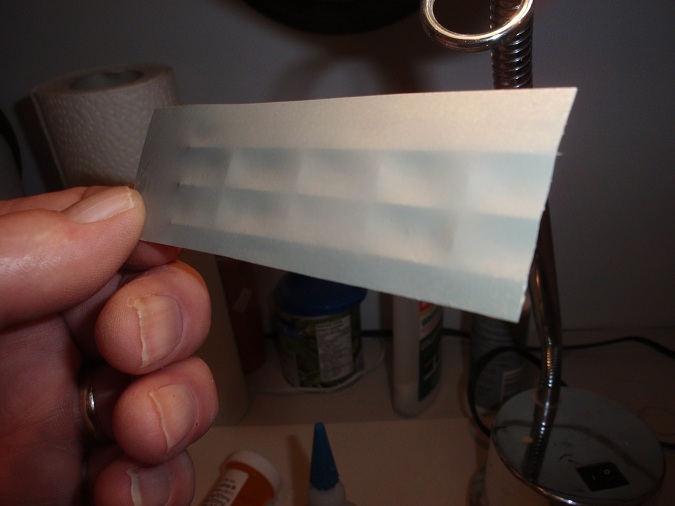

.i have been scratching my head about the indents on the hull plating on the hull.i think it is commen on all thin skinned ships.i think the welding heat must buckle the plates.i have been trying to duplicate this ,not an easy task.here are a few trys at it on a small piece .any advice on this would be very helpful.

Hello Russ,
I would like to see what you have managed for that ripple effect. I want to do that on my build but have had very little success getting anything I like. I look forward to watching the build.

hi james here's a couple of pics of a few trys at the ripple effect .not quite right i will keepon trying.the problem is the ripples are not consistent,and some of the marks are just lousey docking skills.

Russ, that looks good. I did the same thing but used thin brass sheet(tin foil did not hold it's shape) The proplem was keeping the sheets free of other creases and bends. What is the thickness of plastic you are using?
I was going to lay out thin 1mmx 1mm strips on my hull to make the grid pattern than form the brass sheet over that to get the effect. Thin sheet may be much better. The DDE/DDH hull really cries out for the scalloped effect as it just adds so much to the character of the ships.
The idea was to then mould the hull just as Mr. OMalley is on his T3 tanker build so that effect could be any future ship I build.
Just need to figure out the excact dimentions of the rectangles. I did have a rough figure worked out but need to find it.

very nice pics rick.that decking would be tough to model..james you are right trying to get the strips to line up and keep every thing lined up would be a real problem.the styrene i tried is very thin about .05 i think.i have tried skinning a hull with styrene before and ended up tearing it all of because i could not get it to follow compound curves.i will not try this unless i can be sure that it will work and look more or less like the real thing.i will keep experamenting with differant methods.next i will try indenting the wood with some kind of punch or what ever??.

Hello,
I did some rough sizing from the hull photos of Fraser and I believe that the frames are 48" by 24" for each indentation. I took the length of 366' divided by 48' gives 91.5 vertical columns on the hull which is what I counted (or wanted to see..). Using the same method, from just above the water line on the ship plans to the end of the deck curve to the hull is 6 rows which would be 24" tall.
I know this probably is not very scientific but I think it should be very close to what is there. In 1/72 this equals rectangles of 17.0mm x 8.5mm rounded to the nearest .1mm. (11.3mm x 5.6mm at 1/96)
I am not sure my idea of 1mm x 1mm strips to from the frames will be deep enough to get a good scallop effect. My new hull has the hull frames 3mm inside the proper width to allow for the thinkness of the fiberglass covering and skinning wih the 1.5mm scallop affect (1mm frame and .5mm thick skin). I am not sure that sheet styrene would withstand the heat generated by the mould making process and still keep it's shape. That was why I was trying the brass sheets. I was using a .001" brass shim roll from Lee Valley Tools.

nice to have all the feedback on the scallop effects .no matter how it is done one will have to make very sure the method will work ,,or it could be a big mess to try to correct.
