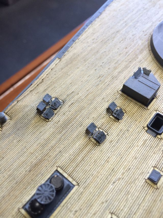

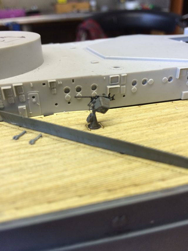

Technically the 20mm Single guns were not difficult to build, but practically, due to the small parts, quite a challenge!

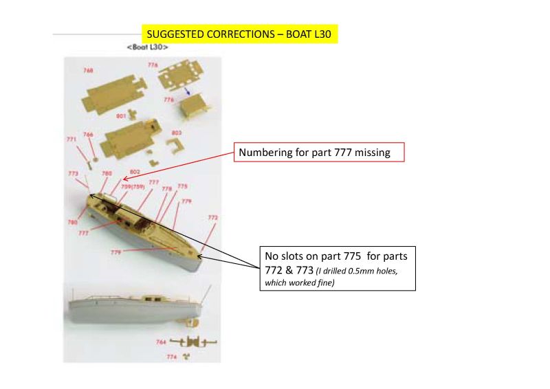

Mr Kim,
I would like to suggest the following corrections:
Dawie van Rensburg
Dawie van Rensburg

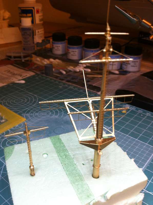

Ok so I FINALLY have the Pontos set plus the upgrade set for my big Bismarck. I have built a couple of 1/350 scale ships with PE and have done lots of aircraft with PE but this is going to be my most ambitious project to date. After looking at all those sheets of brass I have a couple of basic "ship builder" type questions:
1. The masts are a bit bigger and heavier than previous experience so will CA glue work on these or should I use something else? Soldering might be best but I am not sure if I could do a clean enough job so I will probably stick with glue. I read that white glue, thinned with water works but I have never tried that. Any comments?

1. Glue is okDennis The Modeler wrote:Ok so I FINALLY have the Pontos set plus the upgrade set for my big Bismarck. I have built a couple of 1/350 scale ships with PE and have done lots of aircraft with PE but this is going to be my most ambitious project to date. After looking at all those sheets of brass I have a couple of basic "ship builder" type questions:

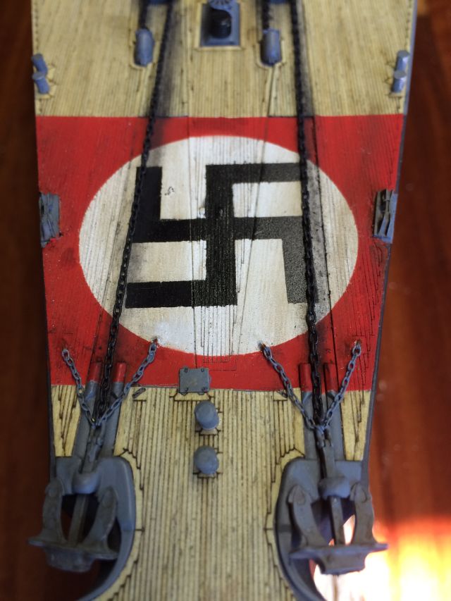

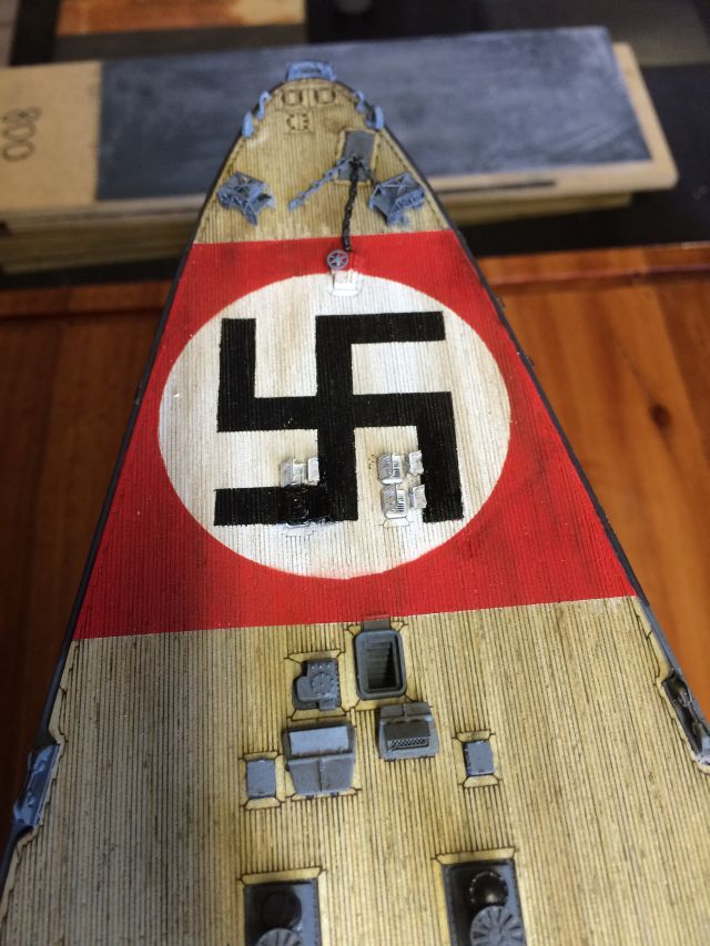

Paul,

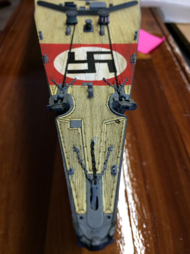

I used the wooden deck and air brushed the marking. I think it came out well.

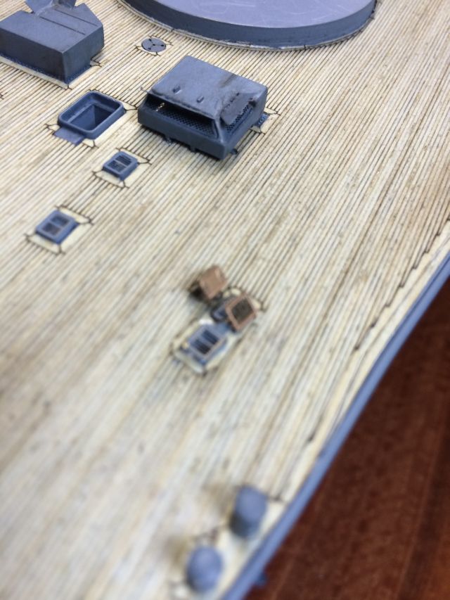

Re: Pontosmodel 1/200 Bismarck Detail Up Set

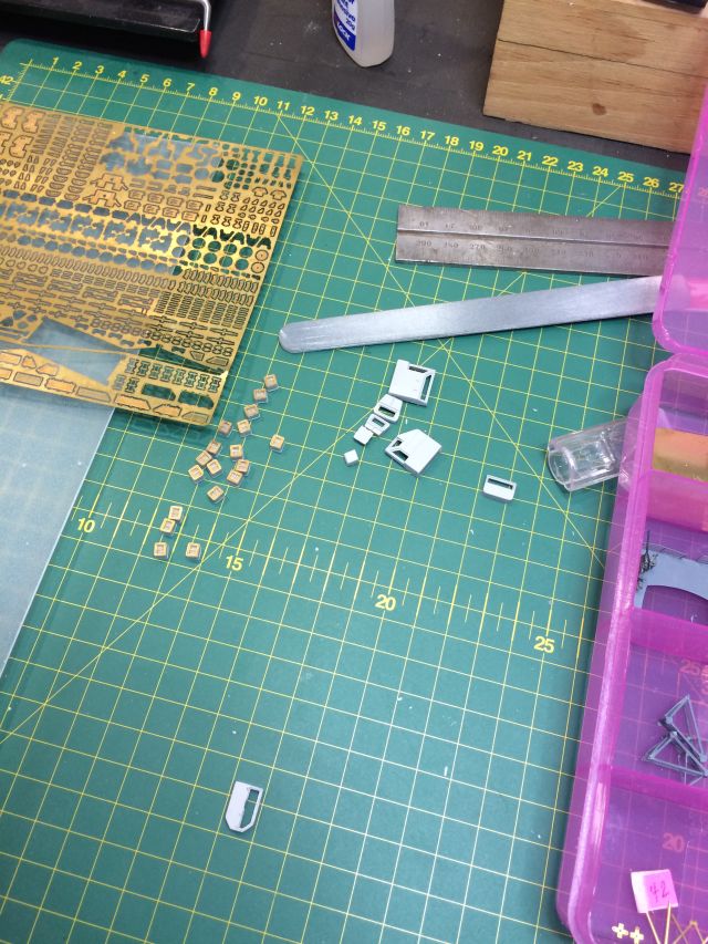

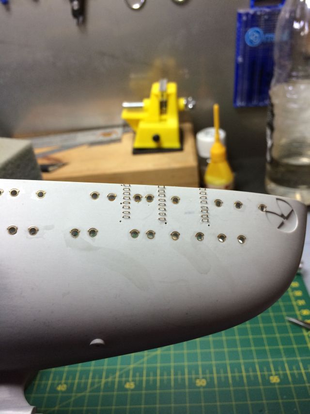

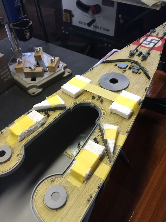

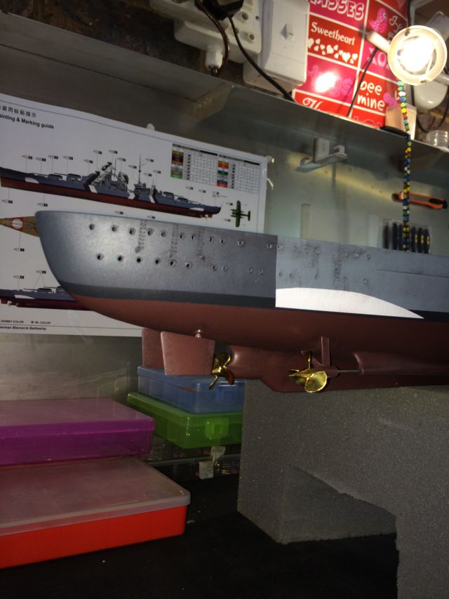

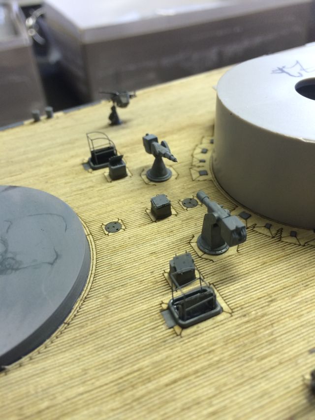

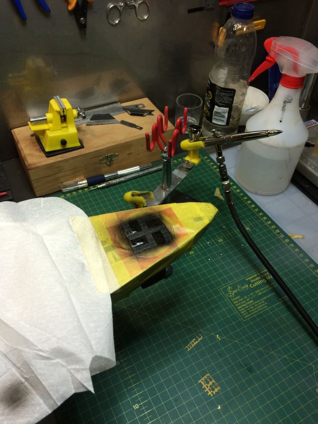

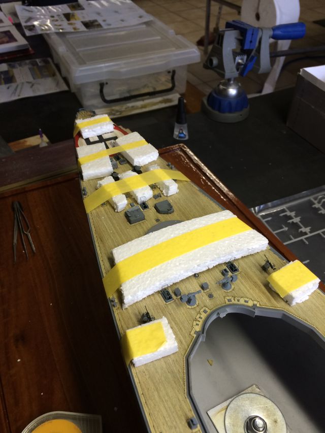

A few photo's to show my progress with the advanced add on set:
Painted. The brass screws looks very nice! Starting with decking detail Thought it wise to protect all these small and delicate parts! Happy modeling to all!
Dawie.
Dawie.

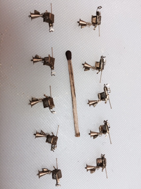

Tobori,
The sequence pictures for the hose reel assembly as mentioned:
1. Existing parts 2. Reels removed - only shafts to be drilled (0.5mm holes) 3. Wiring added for hoses. This was done before assembly as you would certainly demolish the assembly if you do it afterwards! 4. Drilled and 0.4mm wires added. I found the wires essential to align the side of the hose reel once fitted with the hose reel legs that has to be added afterwards. Trimmed after gluing. It was very easy to do it this way. 5. The completed products - all three sizes came out just fine.
- Pontosmodel
- PontosModel
- Posts: 1002
- Joined: Fri Jun 24, 2011 1:26 am
- Location: Korea
Good Job Dawie,
Basically there are 0.55mm holes on the both wall supporters of reel for 0.5mm axis.
Thank you
Keumho Kim
Thank you
Keumho Kim
