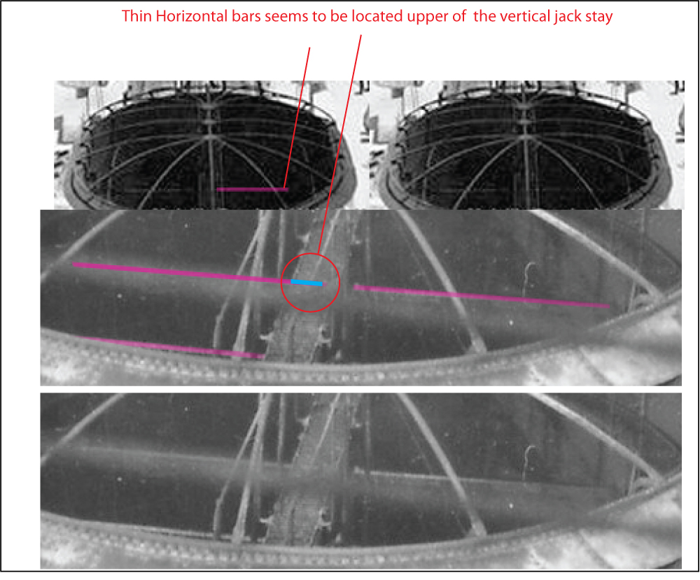

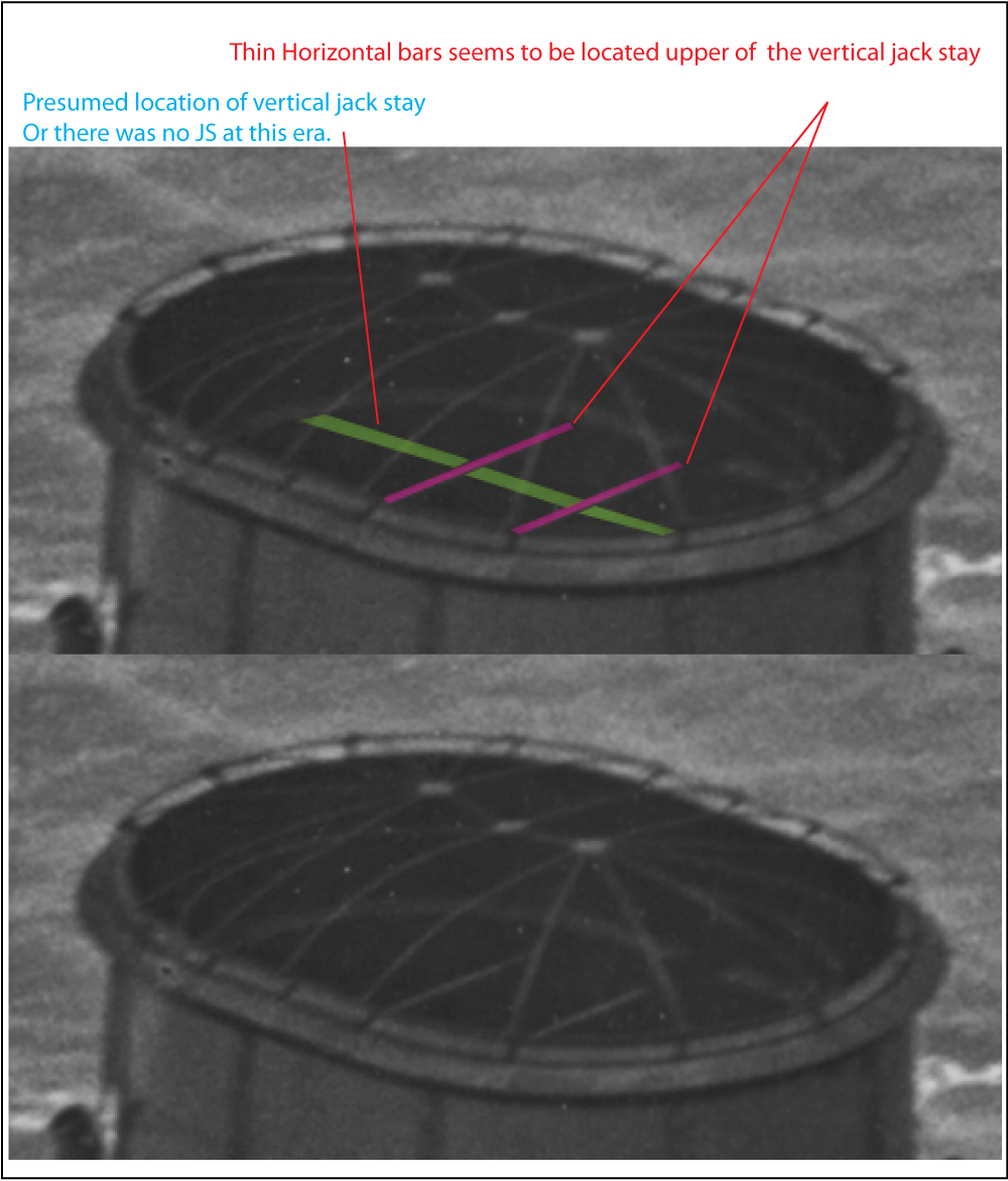

EJFoeth wrote:There are many stays in the inside of the funnel
This is a bit of a guess, really, but matches photographs.
During my precious Saturday, I looked over and searched more pictures via H.M.S. Hood Association http://www.hmshood.com.
And it seems there are thin horizontal bars over the vertical Jack stay.
And This VJS is over the circular Jackstay internal surrounding funnel.
Conclusion? I need to see more photos. :cry_3:
Thank you
Keumho Kim

I agree you need more photos but they are very difficult to find! I have some info here

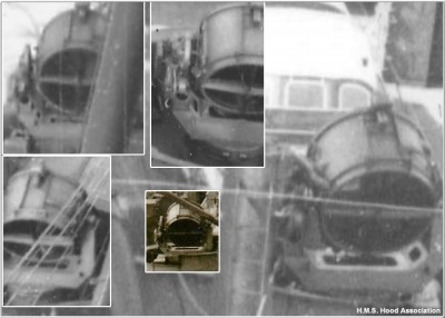

Anyway I need to find for more pictures for referring the following part too.

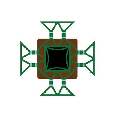

The left side base frame has straight up to down 3 holes but the right has 3 triangle holes based on the Warspite book of AoS series.
Needed photos are the left-back and under the main light area.
Thank you
Keumho Kim

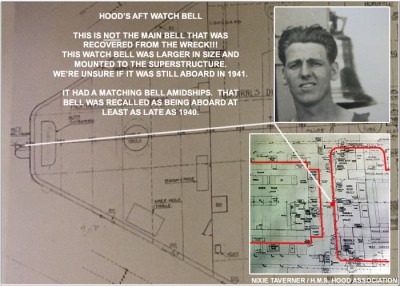

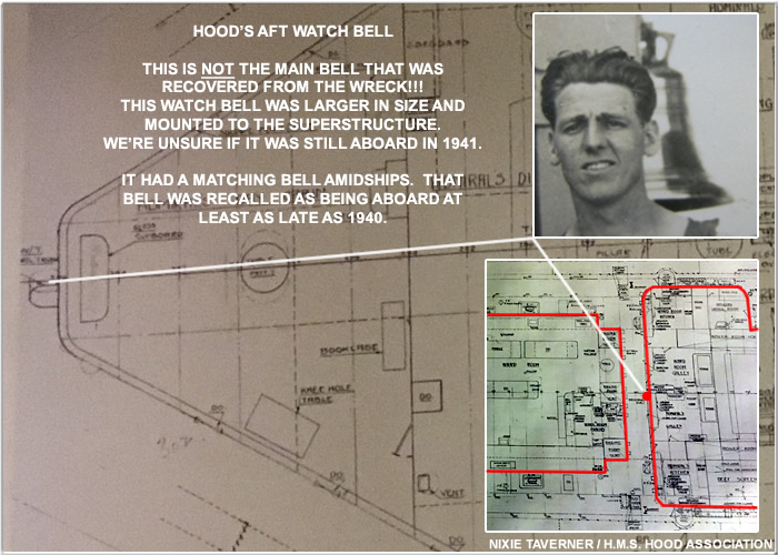

I'm not sure that bells would be worthwhile at this scale (or that they'd even be seen...except for an in-port diorama type display), but here's the info you asked for:
First, the main bell (the one recovered from the wreck). This one is about 18" high. The bell is waaaaay in the background in the main photo. That frame was about 10 feet high!
Second, one of the watch bells. Again, the bell is well behind the main in the photo (I estimate its about 10-12 feet behind the man). These were larger than the main bell. There were at least two such bells aboard Hood...but we're not sure if both were retained after tannoy systems were added. One crewman recalls just the amidships bell and main bell when he was aboard in 1940.
Frank Allen

The bells and frames are no problem in realizing except the right shape of Crown.
Though uncertain that all three bells had remained by 1941, but we would add all at this set.
I think the bell is one of the symbolic and important thing in ship and so recently we have tried to realize and add in our sets.
Thank you

Pontosmodel wrote:Yep I may adapt your idea for the funnel in the end.
Thank you
Keumho Kim

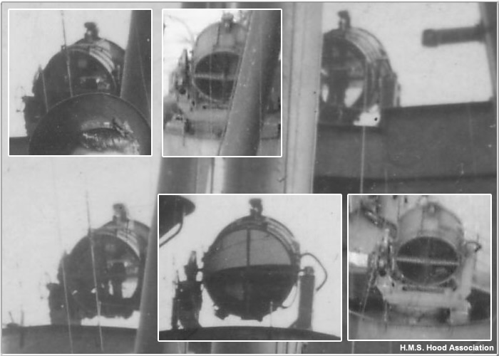

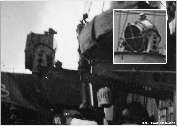

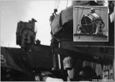

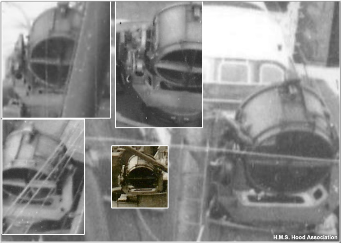

I've attached some searchlight photos (all from Hood in 1940/41) below. I'm not sure that any of them will be of help though.
Frank Allen
http://www.hmshood.org.uk

Very very helpfuls especially the mid-bottom photo of the first file. :thumbs_up_1:

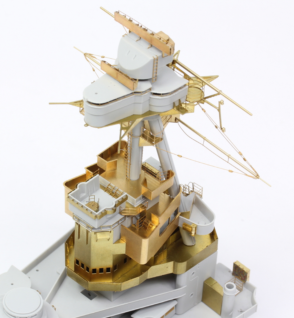

Today, we assembled the Birdge of second try.

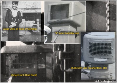

Not sure if the following is helpful or not, but here are some close-ups of various vents (showing the type of mesh/grille used in each...not that some of these would show up even at 1/200 scale):

Wow! That is looking very good indeed! The shape of the Torpedo Control Platform is a tad off, but at least matches the plans (which omitted some small protrusions) :thumbs_up_1:

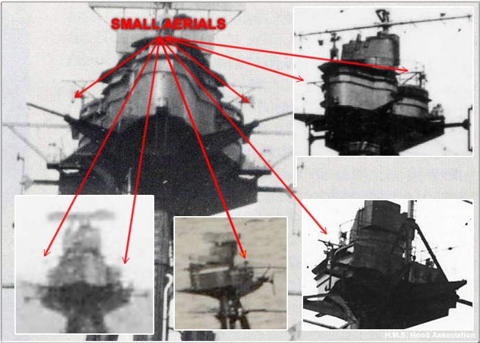

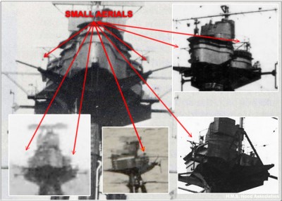

I do have one more suggestion though- Hood actually had two more aerials on her spotting/control top:
I'm afraid I don't have very clear photos of the aerials, but they were definitely there in 1941 (as sunk) though.

I just noticed something- the rangefinder is missing from in front of the upper/aft Air Defence Platform:
I posted this bridge photo for showing main structure shape. so at final stage many various equipments and other small parts will be added.
Yep we noticed and will add some thing after finding more detailed photos or researching similar aerial assembly from other HMS ships.
As for the Vents including mushroom types, we will arrange at final stage.

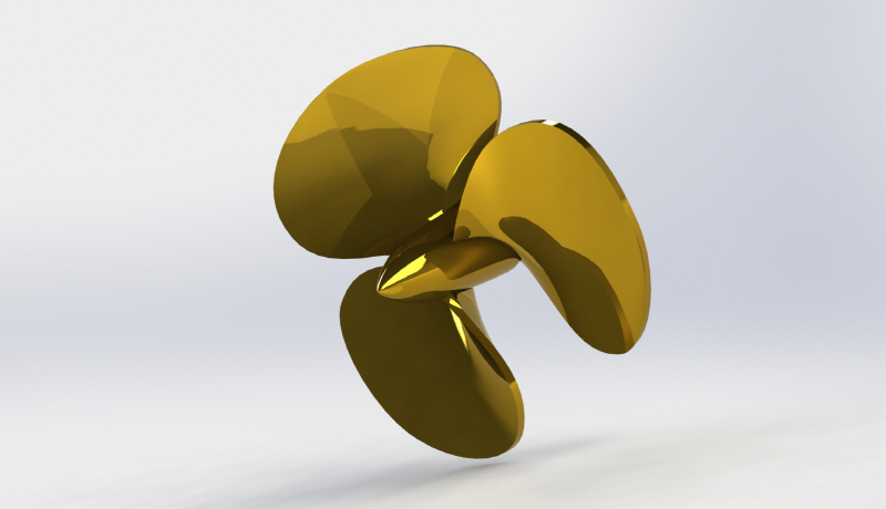

Following is Screw.
Some modification of shape might be needed.
4 Screws may not be included in the basic set.
Keumho Kim
