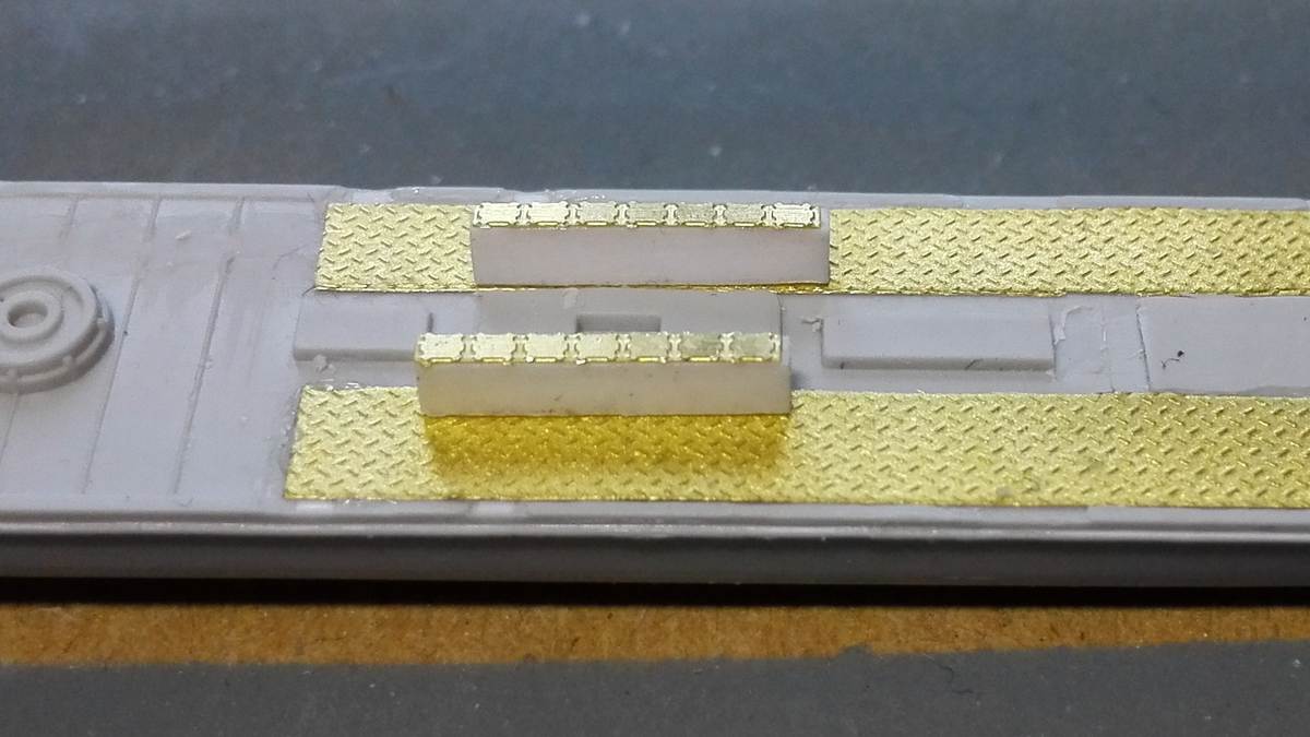

Now this is when the real fun starts. The Pit-Road kit represents the Kamikaze-class deck arrangement correct for the first batch of the class but - as was suspected already in the CASF thread and finally confirmed to me by a Japanese modeler nicked VAN- there was a change in the design applied for the last 4 ships (Asanagi, Hayate, Oite and Yunagi). For the late type the fore torpedo reload rails were relocated from port to starboard so this needs to be modified for the Yunagi. This is rather unpleasant as most of the deck is affected. There was also an additional spare torpedo stowage to starboard for the late type and some additional changes that will be discussed later.
So I removed the "Aztec steps", torpedo stowage and reload rails on the main deck where the real Yunagi differed from the Pit-Road kit. I decided to replace also the quarterdeck details with those provided in the Rainbow set - there were two options available and the one with mine-laying rails and two depth charge racks between them are correct for Yunagi. The fit around the bollards aft is not ideal but I hope it will not be too obvious in the end. I tried to do as little damage to linoleum attachment stripes as possible in the process as the Pit-Road stripes were fine and I did not want to have to replace all of them.
I still need to attach the degaussing cable to be mostly done with the hull but I simply had to check about the Rainbow bridge first :) (the main reason for me getting the Rb set). Will it fit onto a hull different from Hasegawa? Well, not exactly, but with some little tweaking I think it will work out just fine. I also addressed one additional detail where the Mutsukis differed – a large opening on the starboard side had to be deleted for Yunagi.

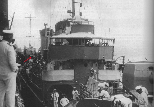

No wartime photo, but thanks God for these two as they show quite a lot of detail.

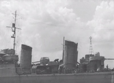

  • The most useful of them is broadside of sister Asanagi (also late type like Yunagi) as commissioned in 1926

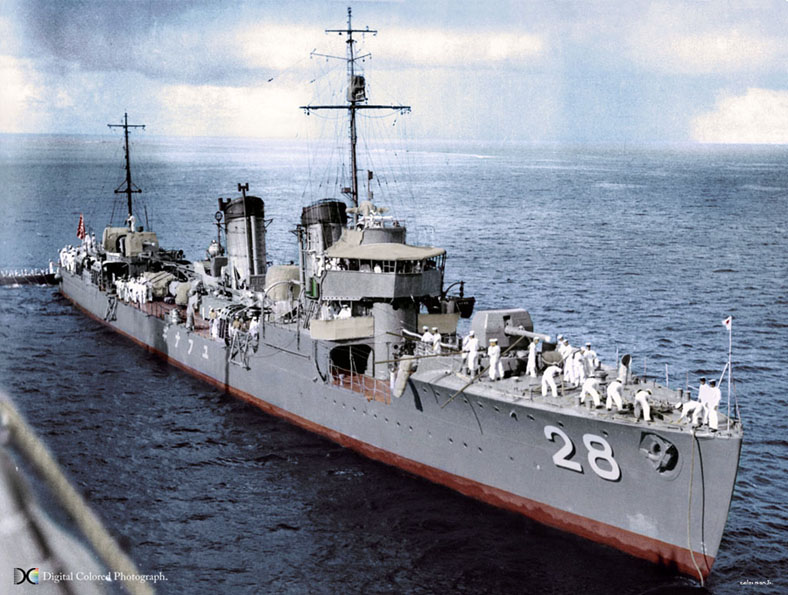

I also have this colorized photo of Yunagi from 1937 showing the rigging fairly clearly.
That is the same photo as I linked above (first of the two of Yunagi herself, dated Sept 5, 1936). I just don´t know what date is correct, 1936 or 1937.

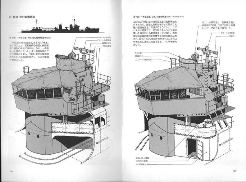

An extremely useful drawing I got from VAN. It comes from the above mentioned book in Japanese by Tashiro Iwashige, thanks to VAN for the translation! A great summary of modifications of an early-war late-type Kamikaze. Some of these mods can be clearly seen on the 1926 Asanagi (vents) and 1936 Yunagi (bridge, reload rails, funnel hoods) photos.
_drawing Yunagi (Kamikaze late type) from VAN_cr.jpg [ 55.06 KiB | Viewed 4514 times ]
At works: USS Astoria CA-34

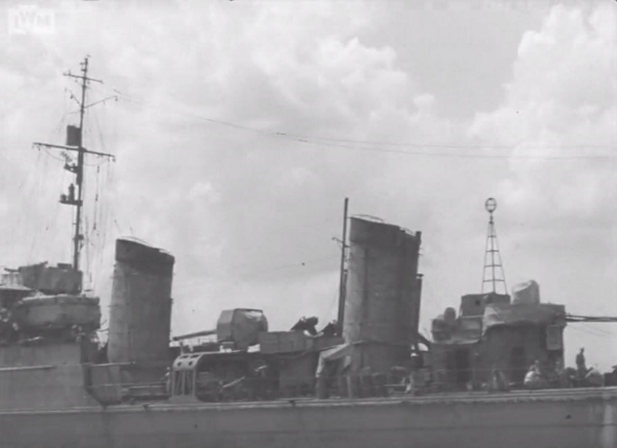

So some advance on the Yunagi today. First of all I completed the degaussing cable according to the photo of Hatakaze in Yokosuka 1943 (above) and also a
post-war photo of Yukaze at NHHC (Minekaze class). Interestingly her cable seems to be installed a bit higher aft than on Hatakaze where the cable is just above portholes. On the contrary, Kamikaze had it even higher in 1945 (see below). No clamps are visible on either photo so I used just a cut sheet styrene and I positioned it as on Hatakaze.
Aft deckhouse/gun platform
Then I started evaluating the PE deckhouses against plastic kit parts and photos. The aft deckhouse/gun platform looked fine to me and dimensions corelated with the kit, the only difference I noticed was that the small deckhouse on the gun deck appears to be hollow on the Kamikazes and Mutsukis! It can be seen clearly on the Hatakaze photo and many others, if examined carefully. The sides and roof of the deckhouse are rounded. So I cut this upper part off the PE and modified it accordingly. Agreed?
Searchlight deckhouse/RDF platform

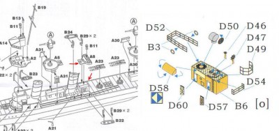

Now we come to the searchlight/aft steering/RDF platform aft of the #2 funnel. Neither the PE part not the original kit parts match what I can see on the Kamikaze-class photos but in this case perhaps the kit parts may be a bit closer to reality for early-type Kamikazes (it seems the Mutsukis and perhaps late-type Kamikazes were more different there). (Edit: the PE part is 8,3mm long vs. plastic 6mm)
PitRoad vs Rainbow instructions searchlight platform.jpg [ 122.11 KiB | Viewed 4442 times ]
It appears the platform had two levels – higher and wider (edit: it looks wider on the Kamikaze but same width or even narrower on Yunagi, check photos below) for the searchlight; and a lower level where the open aux steering was originally and where a small box-like structure with the RDF aerial on top was placed later. Excellent reference here provides an IWM film showing (from approx. 8:20) Kamikaze in Singapore after surrender:
Kamikaze 1945 Singapore post-surrender from IWM film RDF platform2.JPG [ 55.33 KiB | Viewed 4442 times ]
In between the two platform levels there might have been an inclined ladder with its railing covered with canvas (just like the ones on both platform levels) – check the Yunagi 1936 photo.

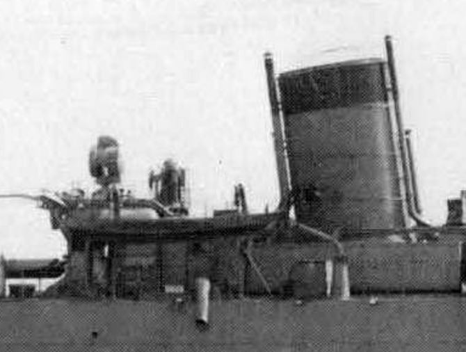

I think there maybe was an additional difference between early and late-type Kamikazes – the film (Kamikaze herself) shows a noticeable gap between the RDF platform and the funnel (note the torpedo reload stowage was already removed here), while Asanagi (late-type Kamikaze) on the 1926 broadside photo shows the steering platform extending towards the funnel (above the torpedo reload stowage). What do you think?
“Perforated triangles”
Notable above are also perforated "wings" or "triangles" extending to the side behind the searchlight platform on both Yunagi and Asanagi photos. I only noticed them just now, I wonder what was their function?
Note also the vent shown on VAN´s drawing is missing in the film (Kamikaze) vs. both Yunagi and Asanagi photos show it clearly. This vent also appears narrower on late-type Kamikazes when compared to Mutsukis and the Rainbow PE.
Your comments on this part would be highly welcome!

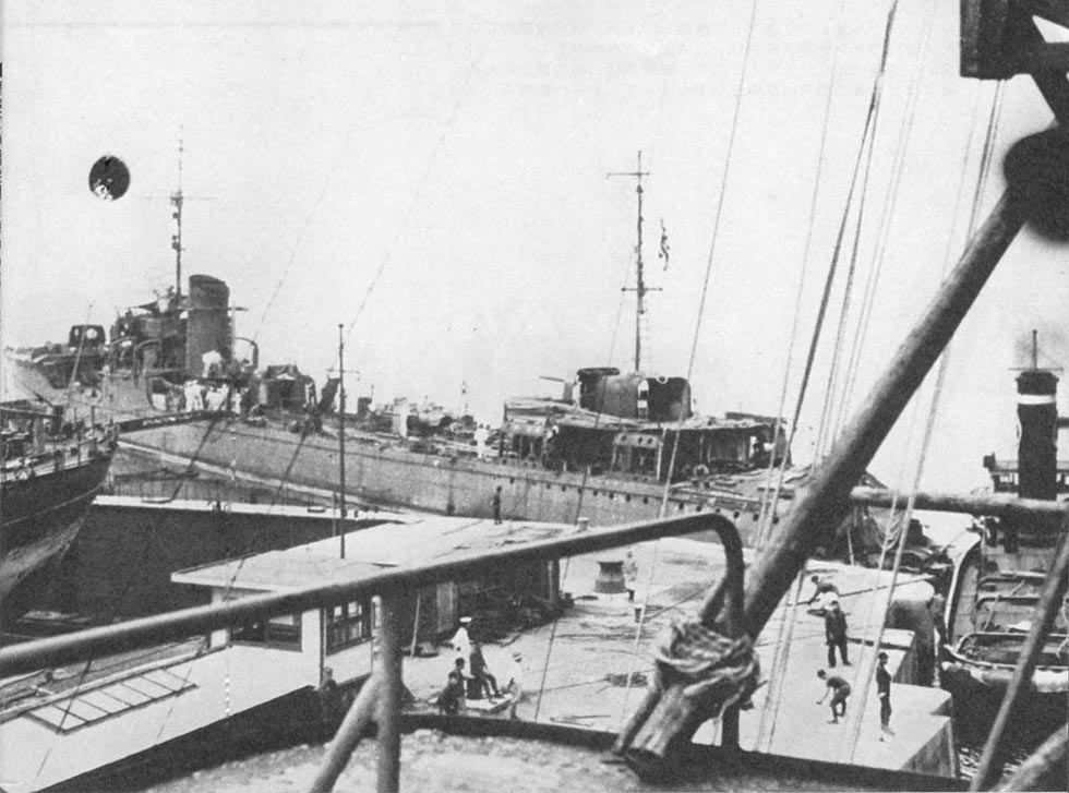

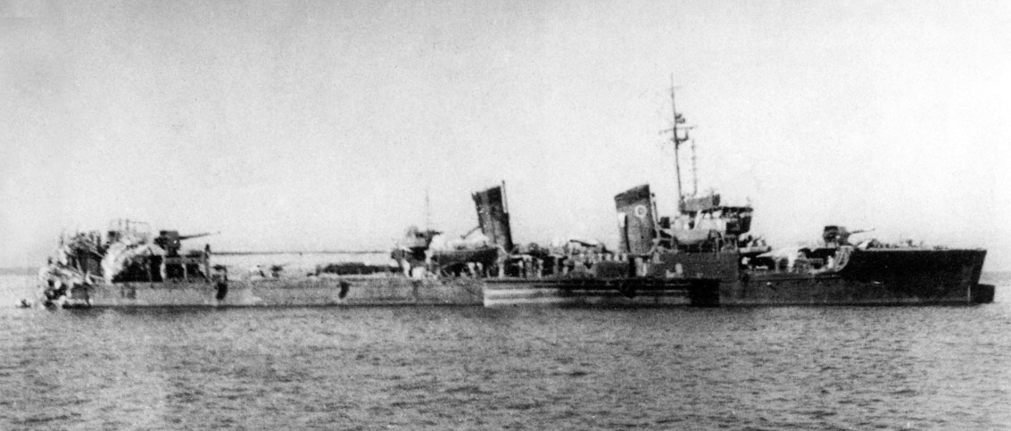

I think the RDF platform as seen in the Yunagi and Kamikaze pics is probably correct. I found this late war photo of a damaged Harukaze showing pretty much the same thing. I'm looking for a better quality version, if I can only remember which Gakken volume that it's in.

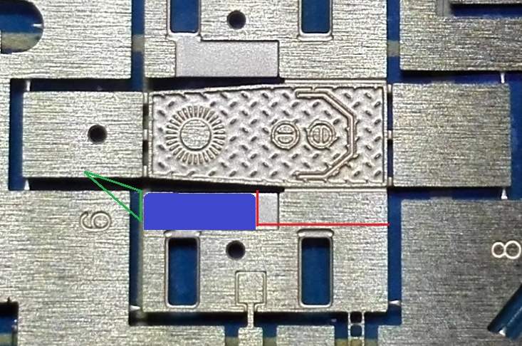

Searchlight deckhouse/RDF platform (continued)
So what I now consider doing is cutting the PE part along the red line (of course also in the other plans). The blue area is where the vent will go. The upper edges of the vent are rounded on the photos, so I´d create it rather from a styrene sheet instead of using the relevant PE part. It´s hard to judge if the result will be correct from the overhead view but without any other reference there´s probably no help.
“Perforated triangles” (continued)
What is still left open are the "perforated triangles" (green). The Yunagi photo shows they are not parallel to the long axis of the ship but slanted to the side, and there are in fact two triangles (one above the other) on Yunagi. There is nothing similar on the early-type Kamikaze photos (pre-war and post-war) so I really hesitate what to do about this.

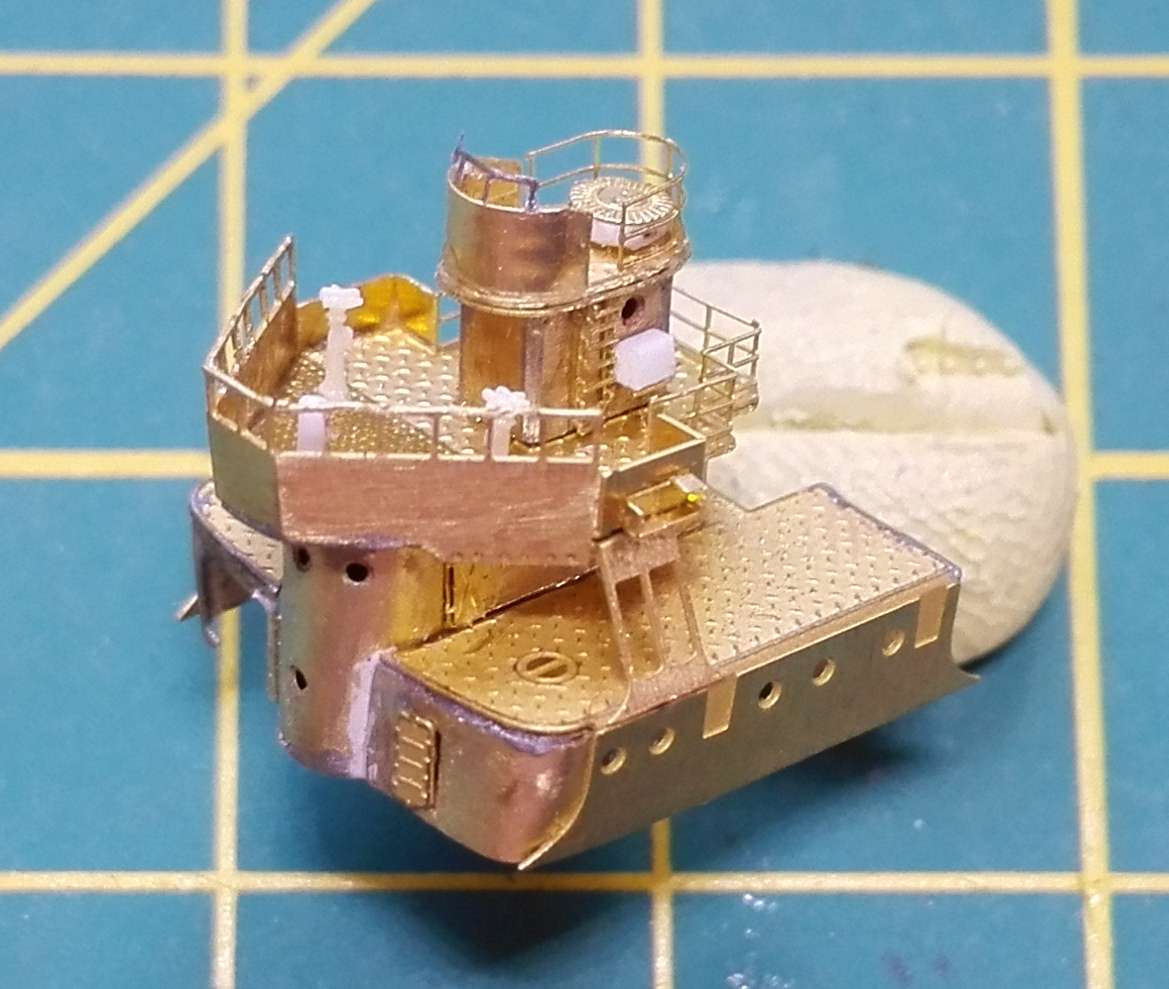

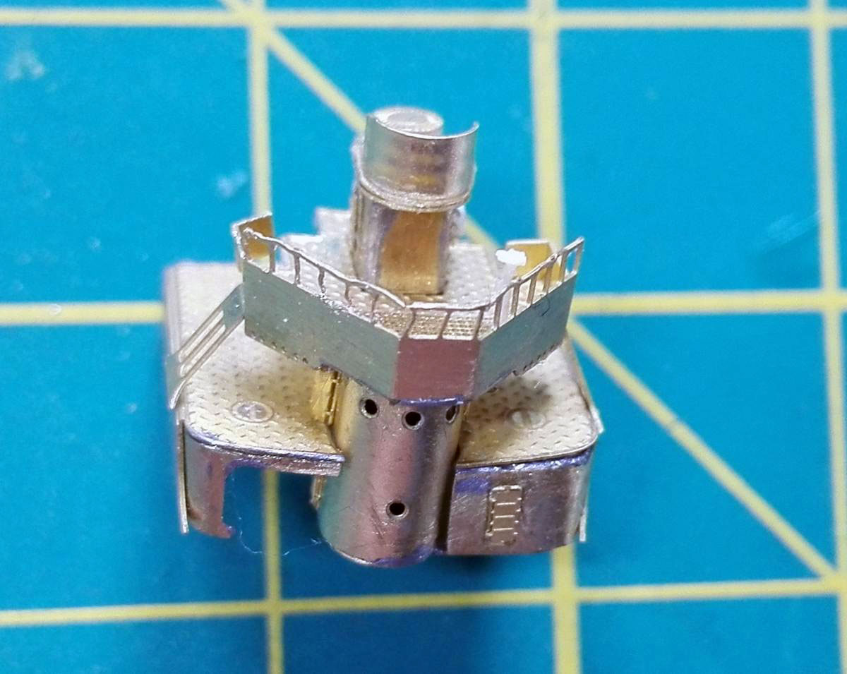

I spent most of the time on building these two parts:

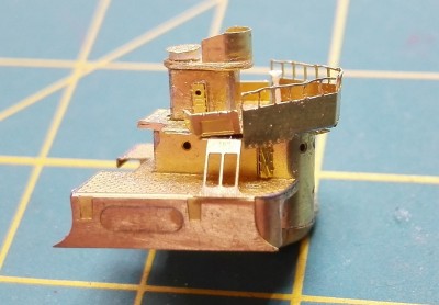

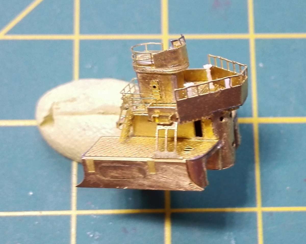

Bridge (continued)
I am really excited about how the bridge from the Rainbow PE set turns out!
So far I have noticed the following differences between the PE bridge and what can be seen on the Yunagi photos:
  • Large oval opening at the lowest level on starboard (already deleted)
  • Metal framing around the “tunnel” for torpedo reload rails at the lowest level on starboard (partially addressed)
  • Missing triangular braces supporting the compass bridge fore (to be done)
  • Sheet metal roof instead of canvas, stretching over upper part of bridge windows (installed approx. in 1941, like on the Yukaze post-war photo) (to be done)
  • Piping running down the side at the compass bridge level (to be done)
  • Missing triangular braces supporting the upmost level (to be done)
  • Two directors and no searchlight at the upmost level (to be done)
  • Glass windshields at the upmost level (to be done)
#2 gun deckhouse (continued)
I used the respective Pit-Road parts to extend the PE deckhouse by the extra 2,5mm as discussed above. Also scratchbuilt a “box” at the upper level and the large vents under the gun platform from plastic sheets.
Watch this space for more :wave_1:

Bridge (continued)
After I recovered from the shock of the bridge disaster and reconciled that the bridge will never appear as nice and clean as before (just because of a silly detail that I wanted to correct when it was already too late!), I went on to repair the damage the best I could. Considering that the windows upper edge will be behind the roof overhang it ended up better than anticipated, ufffff :)
The two resin binoculars come from Veteran Models.
I consider the bridge now ready for a base coat and some retouching, other parts will be added only after it is airbrushed and attached to the hull.

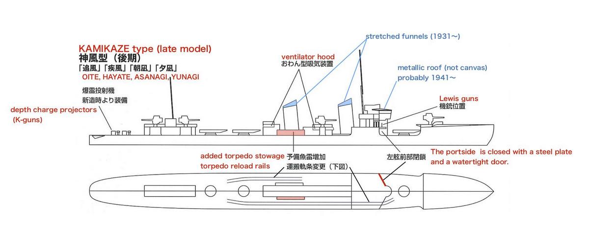

Here is the updated list of modifications to the Rainbow bridge and their current status:
  • No oval opening above the main deck level to starboard (deleted)
  • Different framing around the gangway for torpedo reload rails at the main deck level (addressed)
  • The bridge “house” at boat deck level should be approx. 1mm shorter aft for Kamikaze class, so that the foremast part under the compass bridge is still visible (ignored, realized too late)
  • The aft platform shape at compass bridge level was slightly different (mostly ignored after the disaster)
  • Missing ladder going up to compass bridge level on starboard (added)
  • Missing triangular supports under the compass bridge overhang fore (added)
  • There should be a compass instead of the foremost binocular provided in the PE on compass bridge (done)
  • The top bridge level platform was oval-shaped instead of cross-shaped and no supports down to the compass bridge level on Kamikazes (modified)
  • Three-piece windscreen at the top level (added)
  • Raised circular platform under the main director (added)
  • Two ladders (instead of one on Mutsukis – there was another torpedo reload stowage) at the aft end of the boat deck (to be added later)
  • Lookout positions above compass deck level with supports going to the top level (considering to omit them as these end up usually largely overscale anyway)
  • Additional smaller director forward of the main director (both directors to be added after rigging), no searchlight/blinker lights/binocular at the top level on Yunagi
  • Sheet metal roof instead of canvas, stretching over upper part of bridge windows (installed approx. in 1941, like on the Yukaze post-war photo) (later)
  • Pipe running down the side on starboard at the compass bridge level (later)
  • AA machine guns: sources say two 7.7mm Lewis guns on bridge, which was totally inadequate for 1942. Dan K suggested these might likely have been replaced with dual 13mm machine guns after Yunagi was strafed in March 1942. That sounds quite likely as this is what happened to many other older IJN destroyers (before those surviving were augmented with multiple 25mm while losing some torpedo tubes in late 1943 and 44), so I will go this way (later)
Let us see what comes as the next step :)
