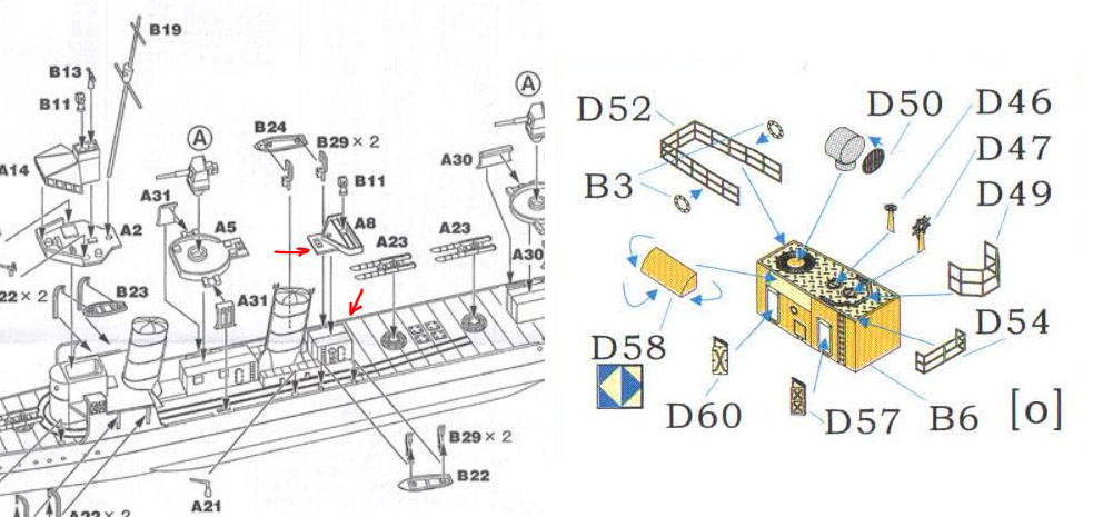

Now we come to the searchlight/aft steering/RDF platform aft of the #2 funnel. Neither the PE part not the original kit parts match what I can see on the Kamikaze-class photos but in this case perhaps the kit parts may be a bit closer to reality for early-type Kamikazes (it seems the Mutsukis and perhaps late-type Kamikazes were more different there). (Edit: the PE part is 8,3mm long vs. plastic 6mm)
PitRoad vs Rainbow instructions searchlight platform.jpg [ 122.11 KiB | Viewed 4312 times ]
It appears the platform had two levels – higher and wider (edit: it looks wider on the Kamikaze but same width or even narrower on Yunagi, check photos below) for the searchlight; and a lower level where the open aux steering was originally and where a small box-like structure with the RDF aerial on top was placed later. Excellent reference here provides an IWM film showing (from approx. 8:20) Kamikaze in Singapore after surrender:

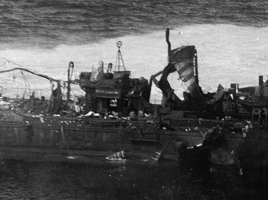

I think the RDF platform as seen in the Yunagi and Kamikaze pics is probably correct. I found this late war photo of a damaged Harukaze showing pretty much the same thing. I'm looking for a better quality version, if I can only remember which Gakken volume that it's in.
HARUKAZE-stern-damage after torpedoing, Luzon Strait off Takao, November, 1944.jpg
HARUKAZE-stern-damage after torpedoing, Luzon Strait off Takao, November, 1944.jpg [ 264.48 KiB | Viewed 4252 times ]
