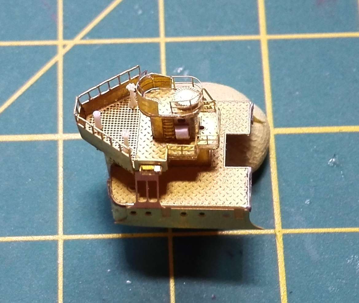

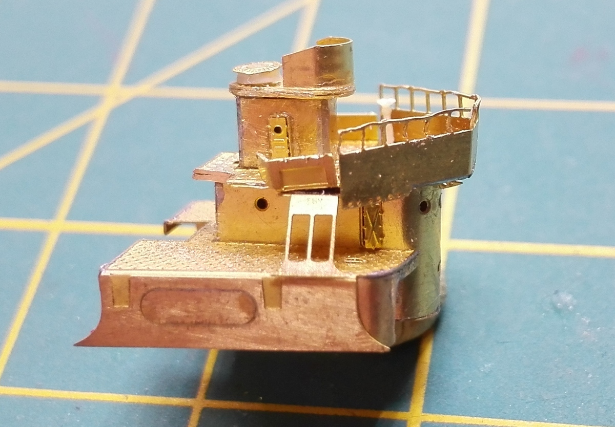

I spent most of the time on building these two parts:
Bridge (continued)
I am really excited about how the bridge from the Rainbow PE set turns out!
So far I have noticed the following differences between the PE bridge and what can be seen on the Yunagi photos:
  • Large oval opening at the lowest level on starboard (already deleted)
  • Metal framing around the “tunnel” for torpedo reload rails at the lowest level on starboard (partially addressed)
  • Missing triangular braces supporting the compass bridge fore (to be done)
  • Sheet metal roof instead of canvas, stretching over upper part of bridge windows (installed approx. in 1941, like on the Yukaze post-war photo) (to be done)
  • Piping running down the side at the compass bridge level (to be done)
  • Missing triangular braces supporting the upmost level (to be done)
  • Two directors and no searchlight at the upmost level (to be done)
  • Glass windshields at the upmost level (to be done)

I have some sad news to report today. Sure you all of you know this: you´ve been working on something for some time, everything going on smooth and nice – and suddenly you begin to realize that you´ve been wrong all the time and that you should either digest that your model will be off - or throw away what you´ve done, try to repair what can be repaired and start over again.
This is what happened to me when I was nearly complete with the top level of the bridge and I realized that there were more subtle differences between Kamikazes and Mutsukis than what I noticed when cataloguing differences between the PE bridge and what can be seen on photos and drawings of Yunagi and other Kamikazes. I managed to correct some of them, e.g. the top bridge level platform that should have been oval-shaped instead of cross-shaped with no supports down to the compass bridge level.
So far so good, but then I learned a tough lesson (and this did not happen to me for the first time I admit). One of the issues that I wanted to adjust was the shape of the aft platform of the compass bridge. I attempted to carefully mill out part of it to make room for a ladder going up from the boat deck. When I was nearly done, unfortunately, the milling tool slipped out and damaged (among other things) the bridge windows to starboard :(. The immediate effect of the disaster was so bad that I haven´t thought about taking a photo, so what you can see is current status after my first attempt to find out what can be salvaged. It does not look much good :(
Never lose hope!

Bridge (continued)
After I recovered from the shock of the bridge disaster and reconciled that the bridge will never appear as nice and clean as before (just because of a silly detail that I wanted to correct when it was already too late!), I went on to repair the damage the best I could. Considering that the windows upper edge will be behind the roof overhang it ended up better than anticipated, ufffff :)
The two resin binoculars come from Veteran Models.
I consider the bridge now ready for a base coat and some retouching, other parts will be added only after it is airbrushed and attached to the hull.
Here is the updated list of modifications to the Rainbow bridge and their current status:
  • No oval opening above the main deck level to starboard (deleted)
  • Different framing around the gangway for torpedo reload rails at the main deck level (addressed)
  • The bridge “house” at boat deck level should be approx. 1mm shorter aft for Kamikaze class, so that the foremast part under the compass bridge is still visible (ignored, realized too late)
  • The aft platform shape at compass bridge level was slightly different (mostly ignored after the disaster)
  • Missing ladder going up to compass bridge level on starboard (added)
  • Missing triangular supports under the compass bridge overhang fore (added)
  • There should be a compass instead of the foremost binocular provided in the PE on compass bridge (done)
  • The top bridge level platform was oval-shaped instead of cross-shaped and no supports down to the compass bridge level on Kamikazes (modified)
  • Three-piece windscreen at the top level (added)
  • Raised circular platform under the main director (added)
  • Two ladders (instead of one on Mutsukis – there was another torpedo reload stowage) at the aft end of the boat deck (to be added later)
  • Lookout positions above compass deck level with supports going to the top level (considering to omit them as these end up usually largely overscale anyway)
  • Additional smaller director forward of the main director (both directors to be added after rigging), no searchlight/blinker lights/binocular at the top level on Yunagi
  • Sheet metal roof instead of canvas, stretching over upper part of bridge windows (installed approx. in 1941, like on the Yukaze post-war photo) (later)
  • Pipe running down the side on starboard at the compass bridge level (later)
  • AA machine guns: sources say two 7.7mm Lewis guns on bridge, which was totally inadequate for 1942. Dan K suggested these might likely have been replaced with dual 13mm machine guns after Yunagi was strafed in March 1942. That sounds quite likely as this is what happened to many other older IJN destroyers (before those surviving were augmented with multiple 25mm while losing some torpedo tubes in late 1943 and 44), so I will go this way (later)
Let us see what comes as the next step :)
