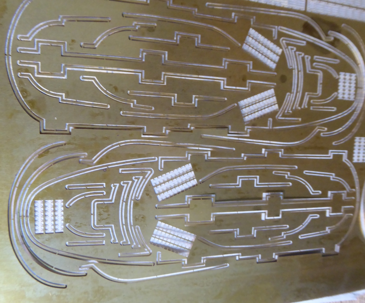

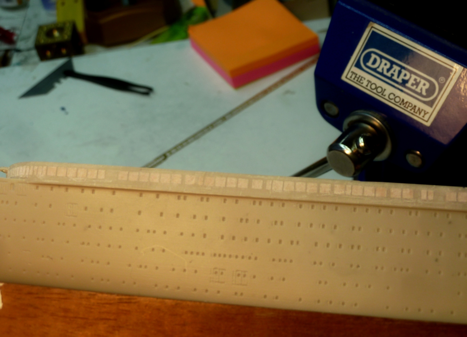

Reasoning that inserting the many dozens of individual PE window frames in the promenade deck would be a nightmare to get filled and painted cleanly
Especially considering that the glazing in this area on the ship was virtually flush-- and in 1/700- scale should be considered to be so.
I commissioned a huge relief etched PE sheet
with complete promenade window overlays reaching from the edge of the boat deck to the lower edge of the overhang--with the windows and window dividers etched through
( on the proviso that it all works as I envisaged and it looks as sharp as a hope it will ...)
this will be available for sale from me .
This sheet also has all new handrails --thinner and finer
as well as the vast timber capping rails on on much of the railings.

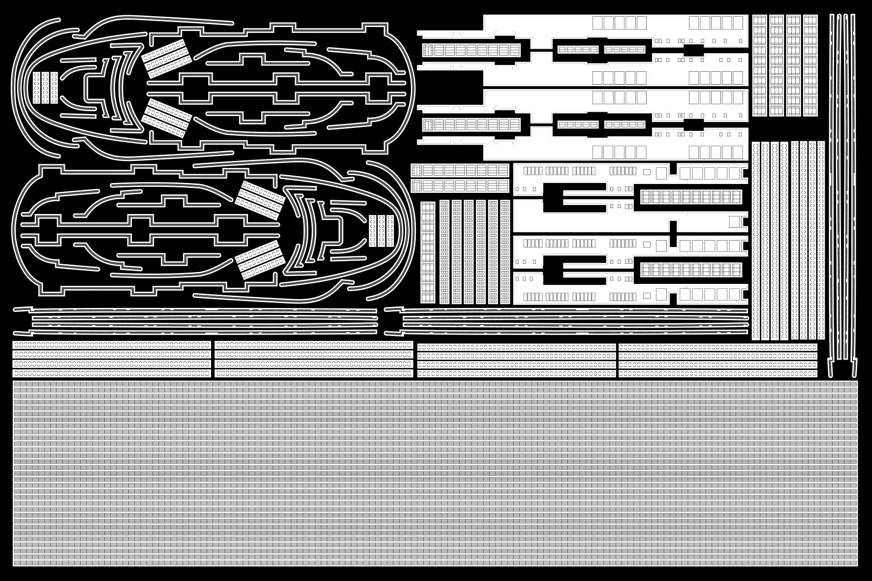

This is an excerpt from the design sheets showing the boat deck windows overlays.
the entire sheet is gargantuan and has many spares and repeats of everything- partly for experimentation and partly in case of accidents !
well... lets see if it works or it was an expensive experiment! :big_grin:

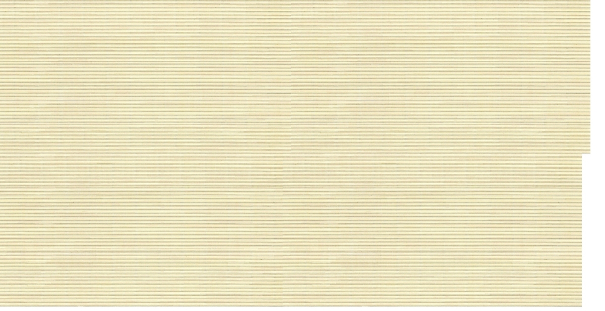

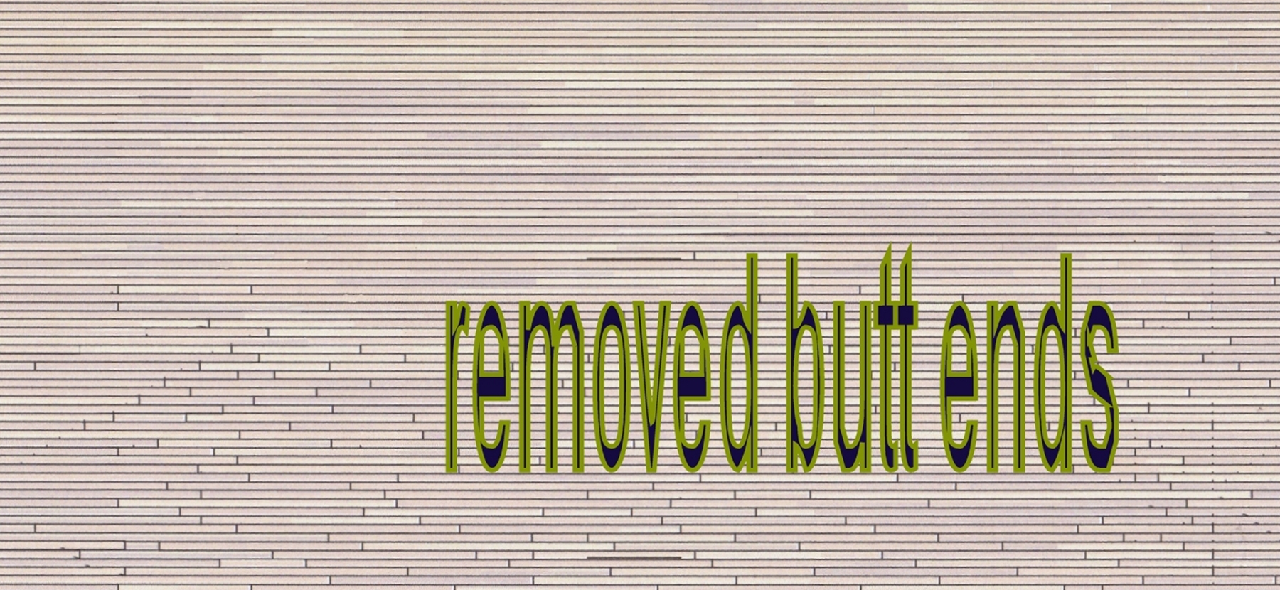

I have drawn up ( with some assistance from UK and Poland! ) a printable paper deck
I have re-worked and recoloured it in dozens of version... (!)
the starting point was a drawn deck blank from a paper model sent to me from Poland-(thank you Artur)
but it was faaaar too butt-endy for my liking --especially in small scale
enlarged it looks like this; the prime aim is to avoid visible butt ends on the planking
as this makes --in my view - almost any deck look like a chessboard.! :big_grin:
Once the butt ends were manually removed in paintshop pro I ' ghosted in' with a transparent layer
some colour changes and subtle butt ends and kept repating the process

various printers have been tried, home and commercial laser printers ( too dotty ) copy shop printers still too dotty .
I deliberately drew the lines in grey and brown tones, so as to get away from the harshness of black deck seams--
on the real thing the seams are fairly unobtrusive and the plank butt ends virtually invisible!
I estimated the plank width to be around 9 inches -- based on peoples feet in some photos
My home canon inkjet printer -- using 100gm fine smooth finish paper
has so far given the best results in appearance when placed on the deck of the ship model #
at 1:1 eyesight viewing it looks pretty convincing...
the big zoomed in images are of course a bit unfair! :heh: :cool_2:
below an example of my 1/700 paper deck alongside evergreen 2020 and the kit casting--the planking of which is alas vastly overscale.
had the casting been decked with Evergreen 20/20 or similar--I would have gone with it...
but alas not so hence pursuing the paper decks.
more soon
JB

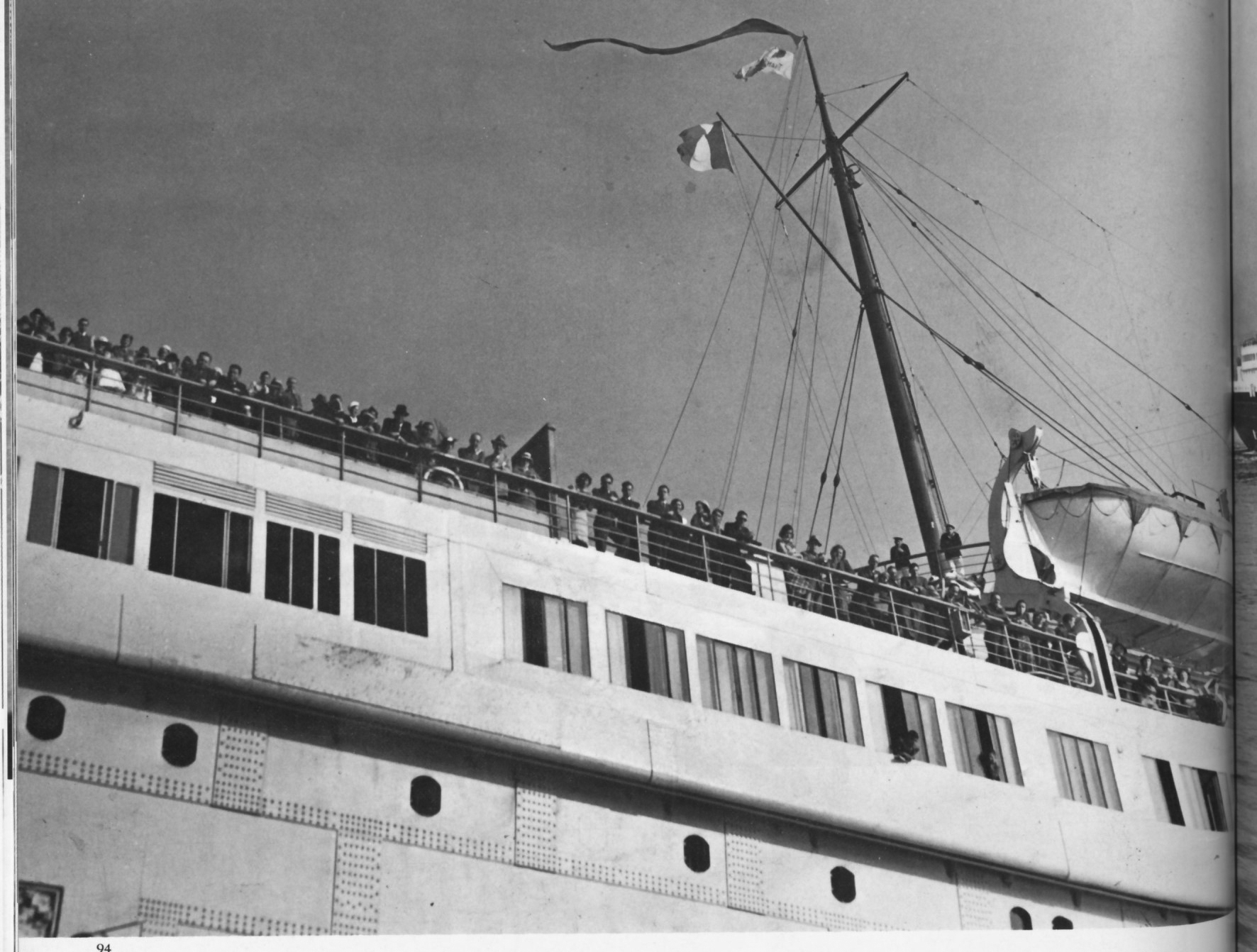

You may well have this, but in case you don't I hope you find this photo to be of some use or inspiration. One of the few I have seen of her in actual color.
--Scott

I like the colours you used for the deck. They are very close to the photograph. The colour of the seams works great too.
I do like the idea of using paper for the deck. But even very smooth matt paper often still has some 'fuzzy' texture to it, not much but you can 'feel' it. Also in the enlarged photos, the paper planking looks clearly less sharp than the plastic.
Maybe it would be possible to use gloss 'photo'-printpaper to print on? Maybe this has a perfectly smooth appearance? After printing, and even after gluing to the model, it can be flat-coated.
Also, the colour variation and butt-end seams seem to get lost in the print. I can't see them anymore, while the photo of the real thing clearly shows some lighter planks popping out, and some vaguely visible but-ends. Maybe it would be ok to have it just a little less subtle? :) Certainly if you plan to have any paint wash or glaze over it later on.
But of course, photo's can be very deceiving, so maybe it looks just perfect in the flesh. You can certainly judge that best yourself! :)

I have been busy refining the decking-- while I agree that in some photo the contrast of the plank colours is visible
the photos sizes on the screen where this is discernible would be equivalent to a 1/96 model (!)
so I maintain that subtlety of tone and nothing too jarring to the eye will work best in 1/700 ( for me )
BUT-- I have improved contrast and definition somewhat and have named this version after you Marijin! :big_grin:
( the actual file is 36 mb and 14000 pixels wide--so it does now print a bit more crisply

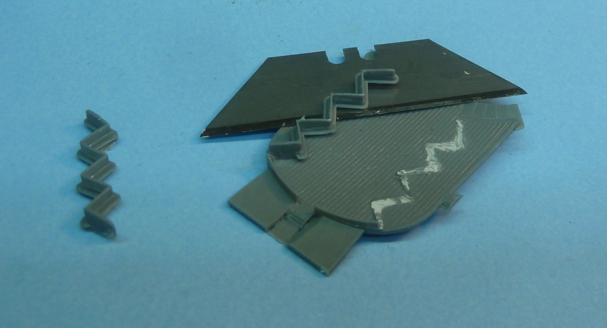

The main hull casting has had various parts removed, decks filled filled and flattened
more of that later
The typical zig-zag seating aft I removed for two-fold reasons;
1) the cast demarcation of seat-to-deck was a bit blurred in the undercut
2) and it is much easier to make a flat deck and then add the seating !

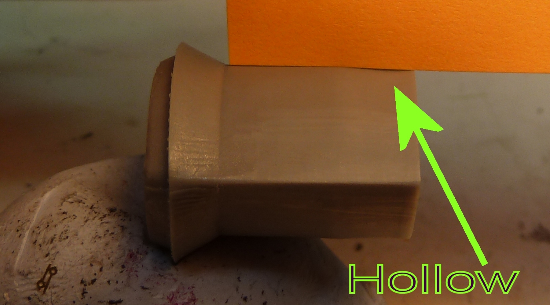

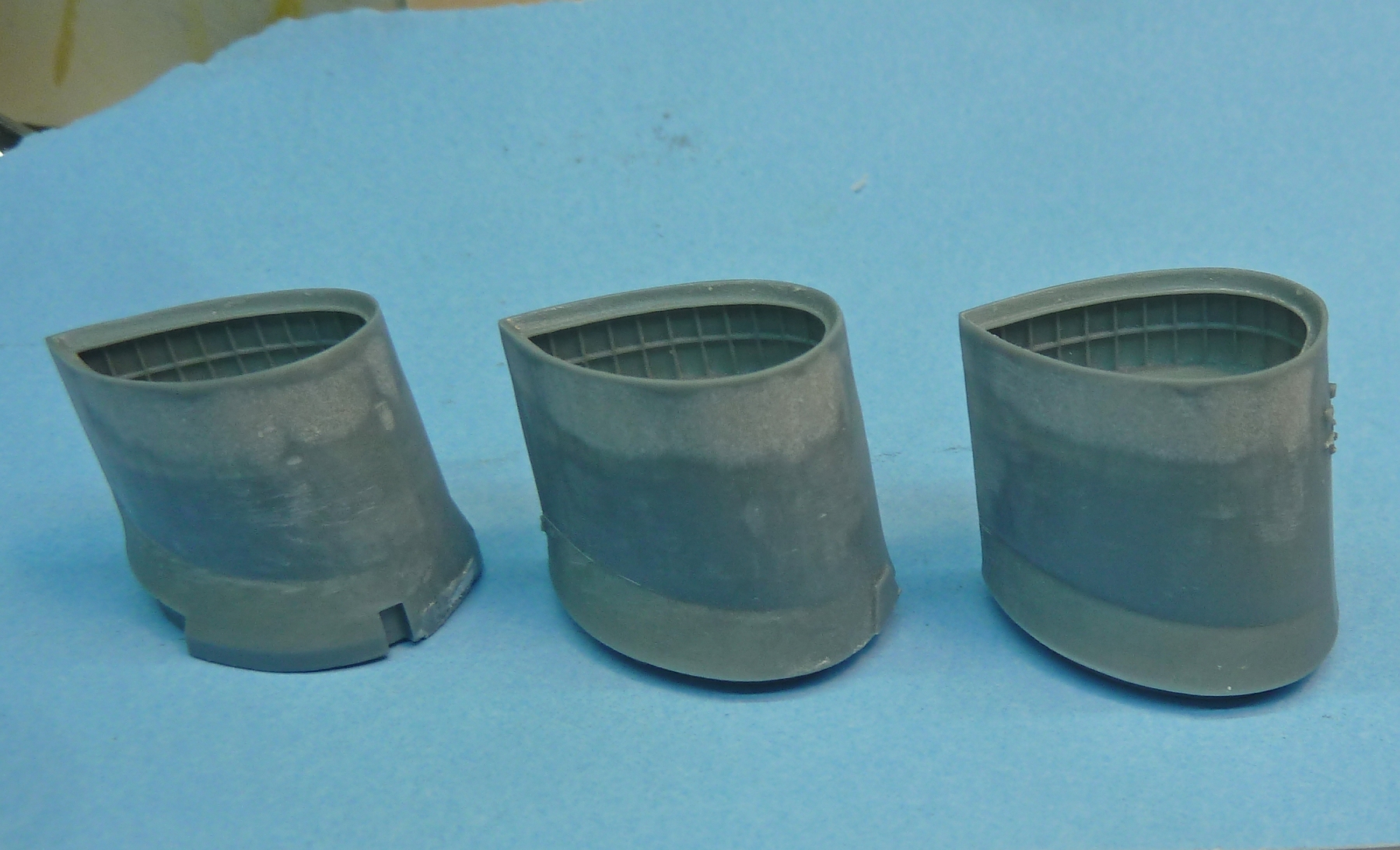

The funnels are a pretty fine piece of work-- offering delicate internal structure and excellent outline and shapes
BUT-- the casting process on funnels created a slight hollow in the upper non-solid area, and some of the digi-printing lines were faintly visible
Polyester filler was applied and blocked sanded gently
On the real thing the funnels were not as smooth as one might think

( after making a rubbing of the wind deflector with graphite dust on a post-it note as as a template for replicating in brass )
The aft funnel base had various vent lids which are rendered quite well on the casting
but are depicted as being on a wood deck base
I also removed the vertical bulwark wall, to be replaced in brass strip after paper-decking
but... the main elephant in the room is still ...(!)..
how to create the satisfactory application of the window overlays without rippling, buckling or damage
The quest thereto continues!

As brutal as it may seem, it could well be that your only option is to rebuild that deck. By which I mean grind out a bit of it to make room, and cover it with a piece of sheet plastic or something that won't react so poorly to having such pieces of photoetch glued to it. Yes, it's a scary solution (at least to me, given I have almost no experience with resin), but given what I've seen of your past work, it is (probably?) doable.
I do love your models, and always look forward to seeing what absurd details you'll add next.

Jim, can you account for any reason why the manufacturer presented such overscale deck planking in the first instance?
Terry (Caravellarella)
marijn van gils
Posts: 2686
Post by marijn van gils »
That decking looks great Jim! I guess there won't be any paint washes or filters over it anymore?
Good progress by the way! Autumn clearly has set in. :big_grin:
Those funnels look great!

I have been pre-occupied with the issues of differential rates of thermal expansion of the hull/ brass and the possible consequences of applying long lengths of brass superstructure to a resin hull
Joins in the PE would seem to be the obvious answer--with the immediate potential of it looking awful at worst--or being a challenge at best to disguise the joins in a dead flat metal surface with soft fillers..
I have been busy fellow experimenting.
This is the current status quo-- and if I am lucky-- I might just get away with it!
( I have a spare Nomandie hull --hence I can afford the relentless experimentation ! :big_grin: :big_grin: )
I had previously found that the cast window indents made it problematic to apply the brass as pressure applied when gluing the PE would cause the window dividers ( mullions) to distort inwards,--further the real ship was nearly flush-glazed on the side windows
(and I had wondered as to how I might replicate that and glaze them ) :scratch:
I arrived at my solution;
==> simply fill all the castings window apertures( on the outboard sides only)
That way the brass would be fully supported and the " glazing" would be nearer 'flush'
Having taken varied sources of advice I bought some " canopy" glue --used by large scale Radio-control aircraft modellers for affixing canopies etc to a wide range of materials, operated in often widely differing temperatures in often adverse conditions( crash-landing ? !)
on a model that is inherently flexible and exposed to often violent manoeuvres- so I guess it is flexible.!
Canopy glue review online; ( from a Model-railroader dealing with long brass PE pieces on resin/ plastic...( sounded familiar!)
http://modelingthesp.blogspot.com/2013/ ... -glue.html
I applied ( yet another!) piece of the test-promenade windows strips
Now then...
-- I have read all that has been said here, taken ( and ignored !) advice from knowledgeable friends
and paid attention to a damnedly clever non-modeller chum of mine,
...who is akin to Stephen Hawkins when he started on the molecular structures of resin and brass and other metals etc
( I did listen but he sort of lost me after a while )...
and I too thought about it long and hard to the detriment of a normal sleep pattern...( almost! :cool_1: )
So this where I am now; ( dedicated to my craft!! )
I had tried rigid adhesives ( CA ), I tried araldite 90-second epoxy ( very good--but I was too slow in positioning / applying adhesive etc)
so I tried the canopy glue
I cooled my model-room to around 10 degrees Centigrade ( reasoning that my model will not be exposed voluntarily to any lower temperatures than this )
Normally in the UK winter simply switching the radiator off would do the trick, but the weather chose this last to be unseasonably mild,
so I cooled the room with a portable aircon unit (!!)
I applied the brass using a shaped and sharpened toothpick ( bamboo==> does not go soggy )
to the underside of the brass as I went, cleaning up with distilled water on a paint-brush with a paper towel behind.
I had the model on its ( 1920's teak! ) wood build plate--held horizontally in a multi-angle vice to allow gravity to assist in positioning the PE.
The glue is high-grab-but movable for a while.
Now the testing;
So...==> Having let the glue cure overnight in the cold ;
I moved the model to our warm heated living room--placed high up on top bookshelf - ( heat rises!)
and left it there for the day
==> as expected or ( as I had hoped /guessed!) nothing happened --the resin expanding and taking the brass with it.
After 12 hours in the heat I took it back up to the model-room for the cold overnight period.
I am now in the third night of repeating this cycle and all appears to be well with no apparent movement, no rippling in the cold or any sign of brass tearing or any sign of glue failure.
I shall do this for another week or two --just to be sure,,...
I do not want to spend hundreds of hours building my Normandie to the best of my ability to be let down
by a fundamental issue that would break my heart and will!
I will report in future findings
Do read the Railway modeller's thoughts and summary linked above
to date - I have to agree with everything he said :thumbs_up_1: !
so far--so good !
my glue I used --made in the UK
