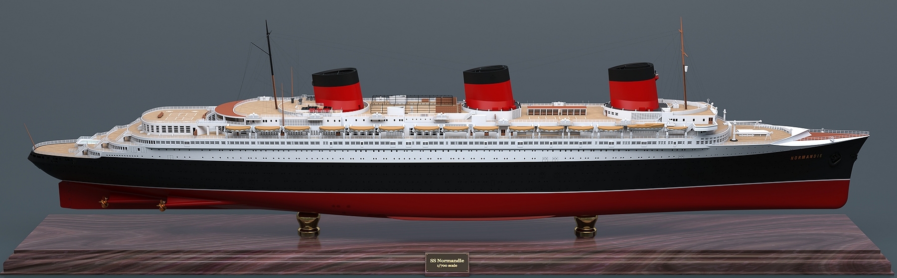

-- which will be the subject of this thread of the building of my -hopefully-- we shall see -- razorsharp model of Normandie :big_grin:
Martin Quinn reviewed the 1/700 model here at MW.com
http://www.modelwarships.com/reviews/sh ... mandie.htm
and spotted the first issue --not a deal breaker - but nevertheless worthy of note--the overscale and deep engraved planking
The large deck seam Martin Quinn alluded to in the review --fortunately - is the representation of the expansion joint....
I have always dreamed of having a model of Normadie as built- as built ( early version ) a totally balanced outline
- rather than the later post-rebuild with the ( in my opinion) heavy looking huge aft deckhouse-- which albeit is visually very interesting
but from 3/4 rear view can look gawky (in a cool way )
modelled at speed with her clean wake and minimum water disturbance even at 30 knots
in 1/700 this is a big ship especially compared with my recently completed 1/700 1891 Hood
so lets get started...-

BUT-- I have improved contrast and definition somewhat and have named this version after you Marijin! :big_grin:
( the actual file is 36 mb and 14000 pixels wide--so it does now print a bit more crisply
as with every model I build--there always seems to be a lot of retrogressive work ( akin to butchery!) before I can forge ahead.
The main hull casting has had various parts removed, decks filled filled and flattened
more of that later
The typical zig-zag seating aft I removed for two-fold reasons;
1) the cast demarcation of seat-to-deck was a bit blurred in the undercut
2) and it is much easier to make a flat deck and then add the seating !
The funnels are a pretty fine piece of work-- offering delicate internal structure and excellent outline and shapes
BUT-- the casting process on funnels created a slight hollow in the upper non-solid area, and some of the digi-printing lines were faintly visible
Polyester filler was applied and blocked sanded gently
On the real thing the funnels were not as smooth as one might think
I added very gentle vertical texture with a brush prior to layering up some of the red.
tricky things to hold to paint!
The bridge roof had its wind deflector removed to aid a clean application of my decking as per above
( after making a rubbing of the wind deflector with graphite dust on a post-it note as as a template for replicating in brass )
The aft funnel base had various vent lids which are rendered quite well on the casting
but are depicted as being on a wood deck base
I also removed the vertical bulwark wall, to be replaced in brass strip after paper-decking
but... the main elephant in the room is still ...(!)..
how to create the satisfactory application of the window overlays without rippling, buckling or damage
The quest thereto continues!
JIM B :wave_1:
