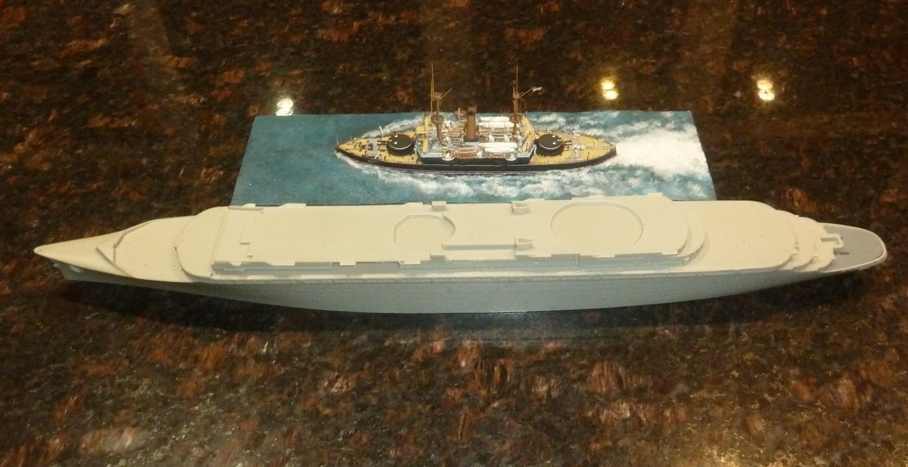

in 1/700 this is a big ship especially compared with my recently completed 1/700 1891 Hood

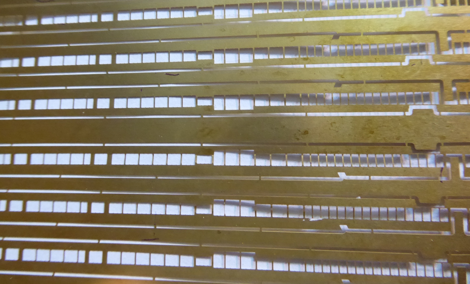

I commissioned a huge relief etched PE sheet
with complete promenade window overlays reaching from the edge of the boat deck to the lower edge of the overhang--with the windows and window dividers etched through
( on the proviso that it all works as I envisaged and it looks as sharp as a hope it will ...)
this will be available for sale from me .
This sheet also has all new handrails --thinner and finer
as well as the vast timber capping rails on on much of the railings.

as with every model I build--there always seems to be a lot of retrogressive work ( akin to butchery!) before I can forge ahead.
The main hull casting has had various parts removed, decks filled filled and flattened
more of that later
The typical zig-zag seating aft I removed for two-fold reasons;
1) the cast demarcation of seat-to-deck was a bit blurred in the undercut
2) and it is much easier to make a flat deck and then add the seating !

I have been pre-occupied with the issues of differential rates of thermal expansion of the hull/ brass and the possible consequences of applying long lengths of brass superstructure to a resin hull
Joins in the PE would seem to be the obvious answer--with the immediate potential of it looking awful at worst--or being a challenge at best to disguise the joins in a dead flat metal surface with soft fillers..
I have been busy fellow experimenting.
This is the current status quo-- and if I am lucky-- I might just get away with it!
( I have a spare Nomandie hull --hence I can afford the relentless experimentation ! :big_grin: :big_grin: )
I had previously found that the cast window indents made it problematic to apply the brass as pressure applied when gluing the PE would cause the window dividers ( mullions) to distort inwards,--further the real ship was nearly flush-glazed on the side windows
(and I had wondered as to how I might replicate that and glaze them ) :scratch:
I arrived at my solution;
==> simply fill all the castings window apertures( on the outboard sides only)
That way the brass would be fully supported and the " glazing" would be nearer 'flush'

I applied ( yet another!) piece of the test-promenade windows strips
Now then...
-- I have read all that has been said here, taken ( and ignored !) advice from knowledgeable friends
and paid attention to a damnedly clever non-modeller chum of mine,
...who is akin to Stephen Hawkins when he started on the molecular structures of resin and brass and other metals etc
( I did listen but he sort of lost me after a while )...
and I too thought about it long and hard to the detriment of a normal sleep pattern...( almost! :cool_1: )
So this where I am now; ( dedicated to my craft!! )
I had tried rigid adhesives ( CA ), I tried araldite 90-second epoxy ( very good--but I was too slow in positioning / applying adhesive etc)
so I tried the canopy glue
I cooled my model-room to around 10 degrees Centigrade ( reasoning that my model will not be exposed voluntarily to any lower temperatures than this )
Normally in the UK winter simply switching the radiator off would do the trick, but the weather chose this last to be unseasonably mild,
so I cooled the room with a portable aircon unit (!!)
I applied the brass using a shaped and sharpened toothpick ( bamboo==> does not go soggy )
to the underside of the brass as I went, cleaning up with distilled water on a paint-brush with a paper towel behind.
I had the model on its ( 1920's teak! ) wood build plate--held horizontally in a multi-angle vice to allow gravity to assist in positioning the PE.
The glue is high-grab-but movable for a while.
Now the testing;
So...==> Having let the glue cure overnight in the cold ;
I moved the model to our warm heated living room--placed high up on top bookshelf - ( heat rises!)
and left it there for the day
==> as expected or ( as I had hoped /guessed!) nothing happened --the resin expanding and taking the brass with it.
After 12 hours in the heat I took it back up to the model-room for the cold overnight period.
I am now in the third night of repeating this cycle and all appears to be well with no apparent movement, no rippling in the cold or any sign of brass tearing or any sign of glue failure.
I shall do this for another week or two --just to be sure,,...
I do not want to spend hundreds of hours building my Normandie to the best of my ability to be let down
by a fundamental issue that would break my heart and will!
I will report in future findings
