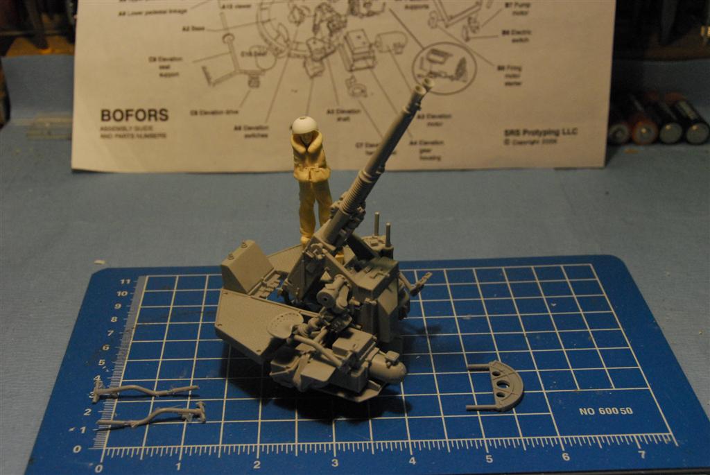

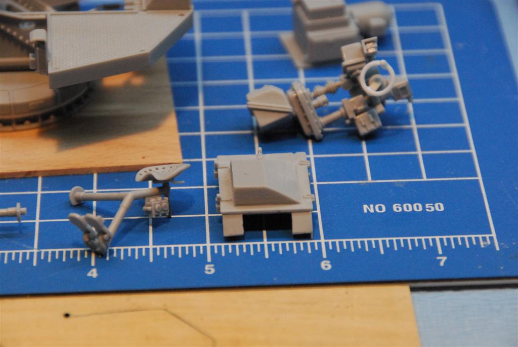

Hey everybody,
I'm building a 1/32 SRS PROTYPING 40mm Twin Bofors Mount as a restart to my modeling. Hope to scratch a gun tub from CVL 26 USS Monterey. I've met a vet who served as a gunners mate on the starboard stern most mount for all of WWII ( I don't know the number ).
This first shot is of the main parts. The base and carriage were cast as one, so I chucked it in the lathe and cut them apart. Then added new top plate, along with a center tube so the mount will train.
The second and third shots show the parts test fit with a little white glue.

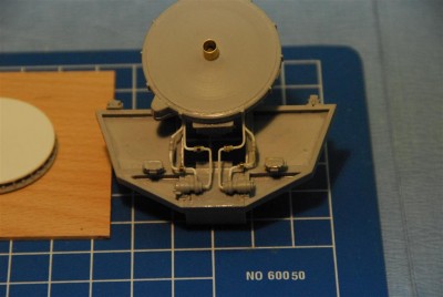

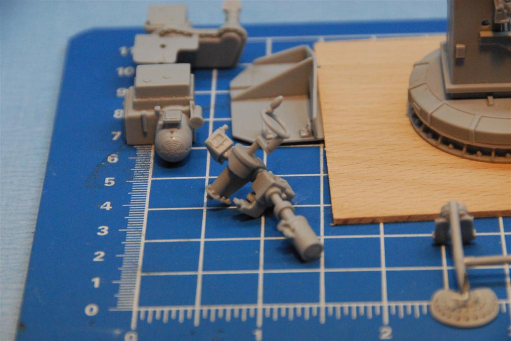

Small update,
Well I've been drilling holes and cleaning up the castings. The work on the holes is hard to see. Put together most of the sub-assemblies.
The first shot shows the front firing gear cover, it was cast as a rectangle. Photos show that it was angled. I made a fixture and put it in the mill to take off the angle.
The second shot is the elevation gear, motor and gear case.
Third is a shot of the carriage with the cooling lines added. You can just make out the cooling drain tee that was made.
Fourth is the carriage bottom with the cooling lines and pumps.
Bob W

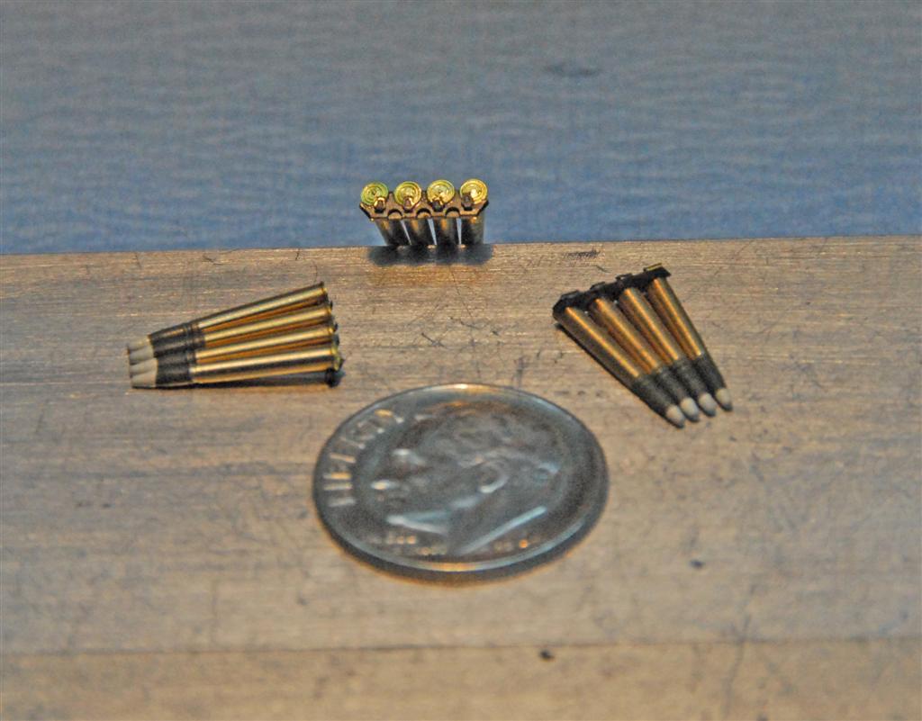

Update,
Been working on details and ammo.

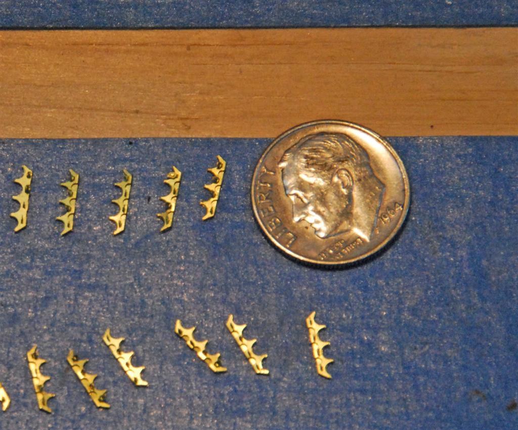

The first shot shows the barrel recoil springs and a barrel that I wound up with. Just couldn't get the springs to look right with scraping and sanding. So I cut the cast springs off in the lathe and made new from brass wire. Also, added some LionRoar 1/35 antiskid plate to the decking.
The second shot shows 72 rounds of 40mm ammo. They came from: http://www.orangehobby.com/logs/75369334.html They are real gems.
The third shot is the clips, there are six parts to each one.
The last shot is of the finished ammo and clips.

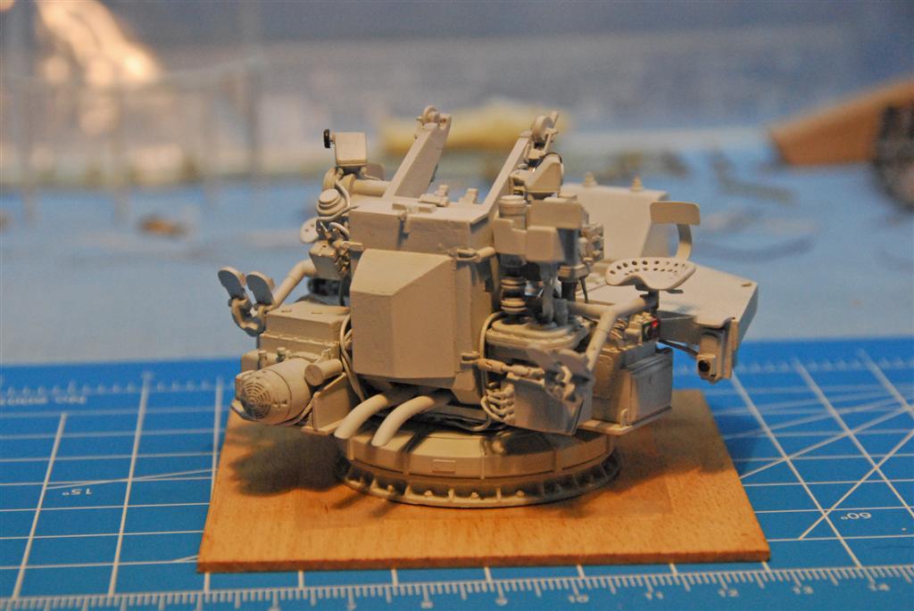

Some progress,
Working on the Trainer's side, motor, gear boxs, and the cables. The cables are from 'Detail Master', they make braided hose line for the car crowd, it's 0.020 fine SS.

Almost done with the pointers (elevation) side.

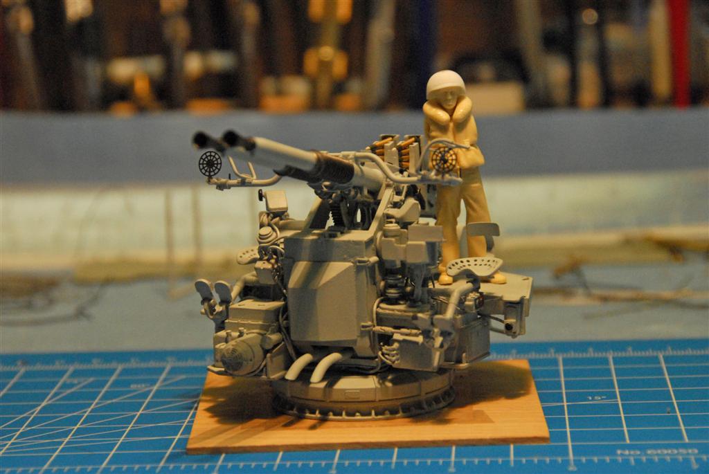

Update,
The barrels and breech block have been added. This shows the recoil springs and the sight guards. The photo etch sight guards where replaced with scratch ones because they were flat.
