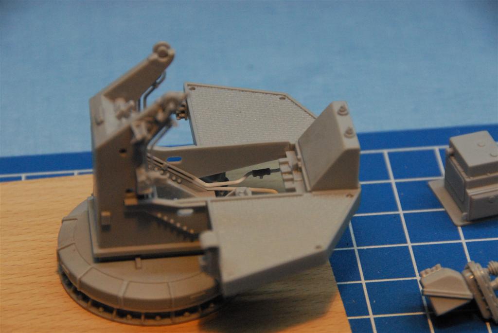

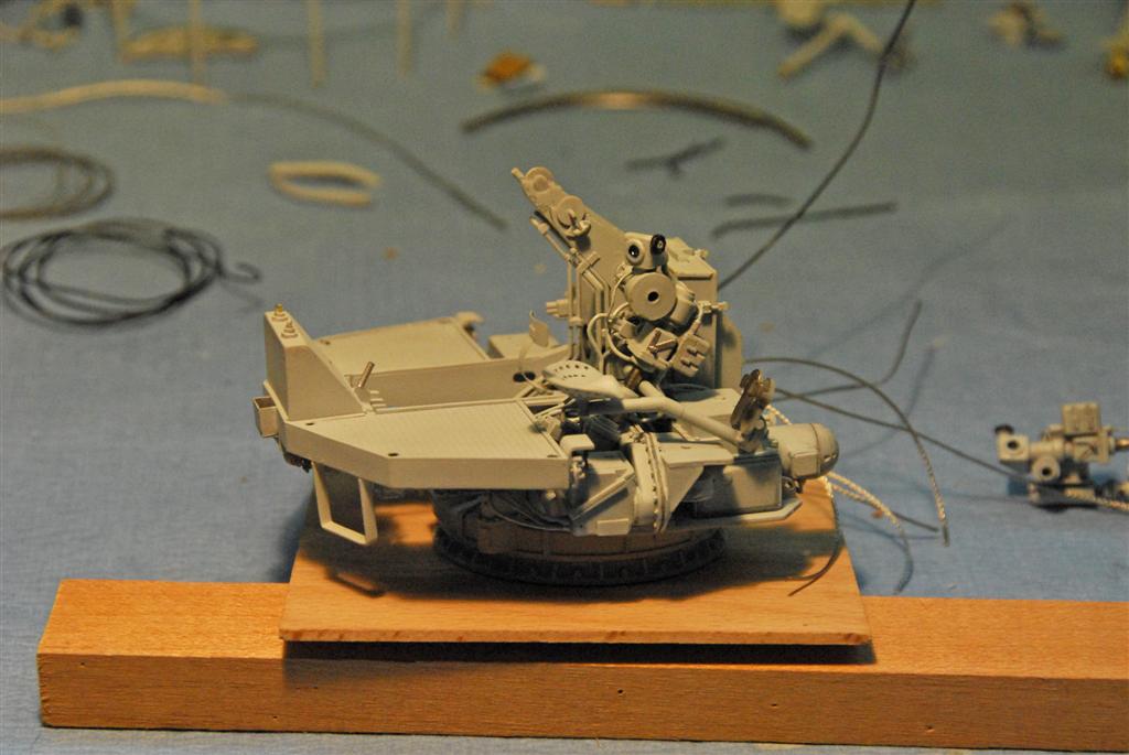

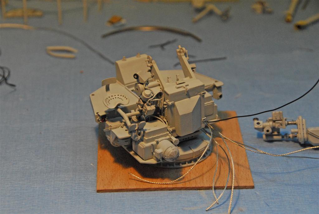

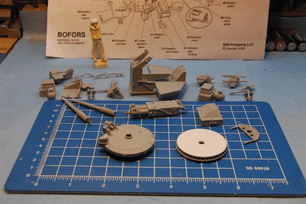

I'm building a 1/32 SRS PROTYPING 40mm Twin Bofors Mount as a restart to my modeling. Hope to scratch a gun tub from CVL 26 USS Monterey. I've met a vet who served as a gunners mate on the starboard stern most mount for all of WWII ( I don't know the number ).
This first shot is of the main parts. The base and carriage were cast as one, so I chucked it in the lathe and cut them apart. Then added new top plate, along with a center tube so the mount will train.
The second and third shots show the parts test fit with a little white glue.
Bob W

Small update,
Well I've been drilling holes and cleaning up the castings. The work on the holes is hard to see. Put together most of the sub-assemblies.
The first shot shows the front firing gear cover, it was cast as a rectangle. Photos show that it was angled. I made a fixture and put it in the mill to take off the angle.
The second shot is the elevation gear, motor and gear case.
Third is a shot of the carriage with the cooling lines added. You can just make out the cooling drain tee that was made.
Fourth is the carriage bottom with the cooling lines and pumps.
Bob W
