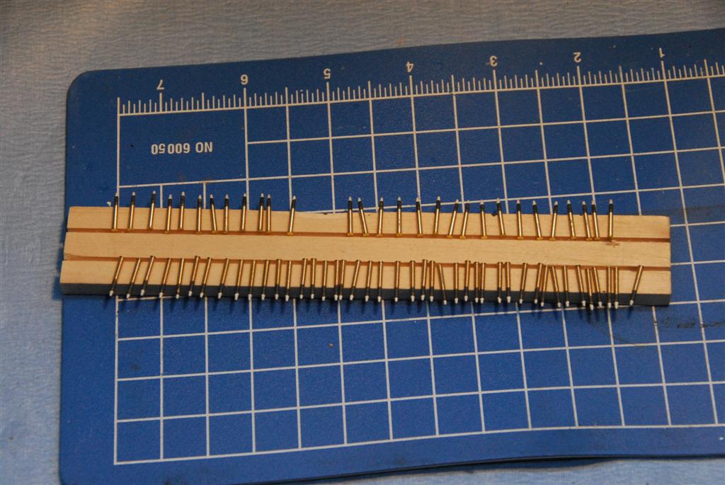

The first shot shows the barrel recoil springs and a barrel that I wound up with. Just couldn't get the springs to look right with scraping and sanding. So I cut the cast springs off in the lathe and made new from brass wire. Also, added some LionRoar 1/35 antiskid plate to the decking.
The second shot shows 72 rounds of 40mm ammo. They came from: http://www.orangehobby.com/logs/75369334.html They are real gems.
The third shot is the clips, there are six parts to each one.
The last shot is of the finished ammo and clips.
Bob W
