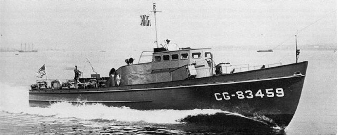

File comment: Heres an early version of the 83. Note the absence of depth charges and rocket launchers. You can see the 20mm.

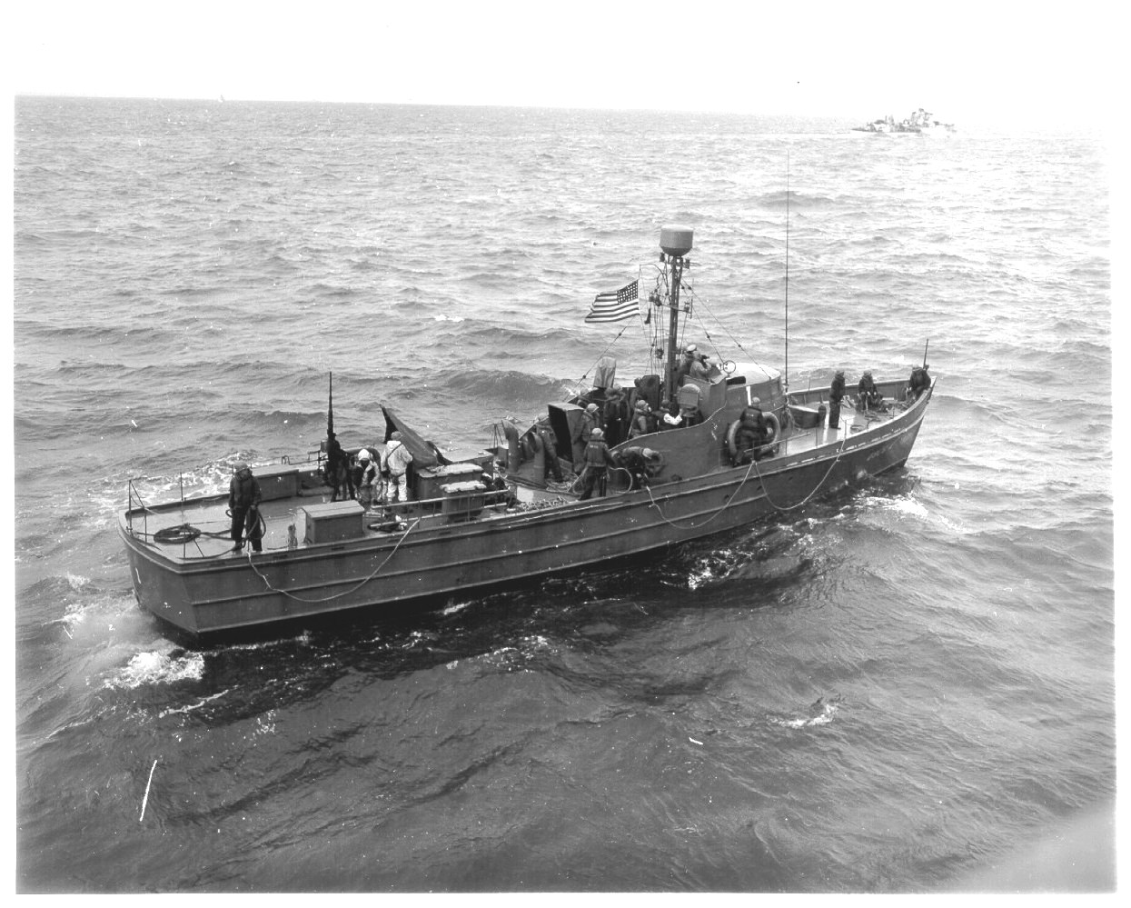

File comment: Heres thae actual boat I will build. Look close and you can see the rocket launchers and depth charges.

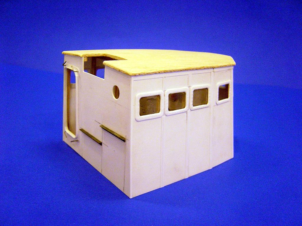

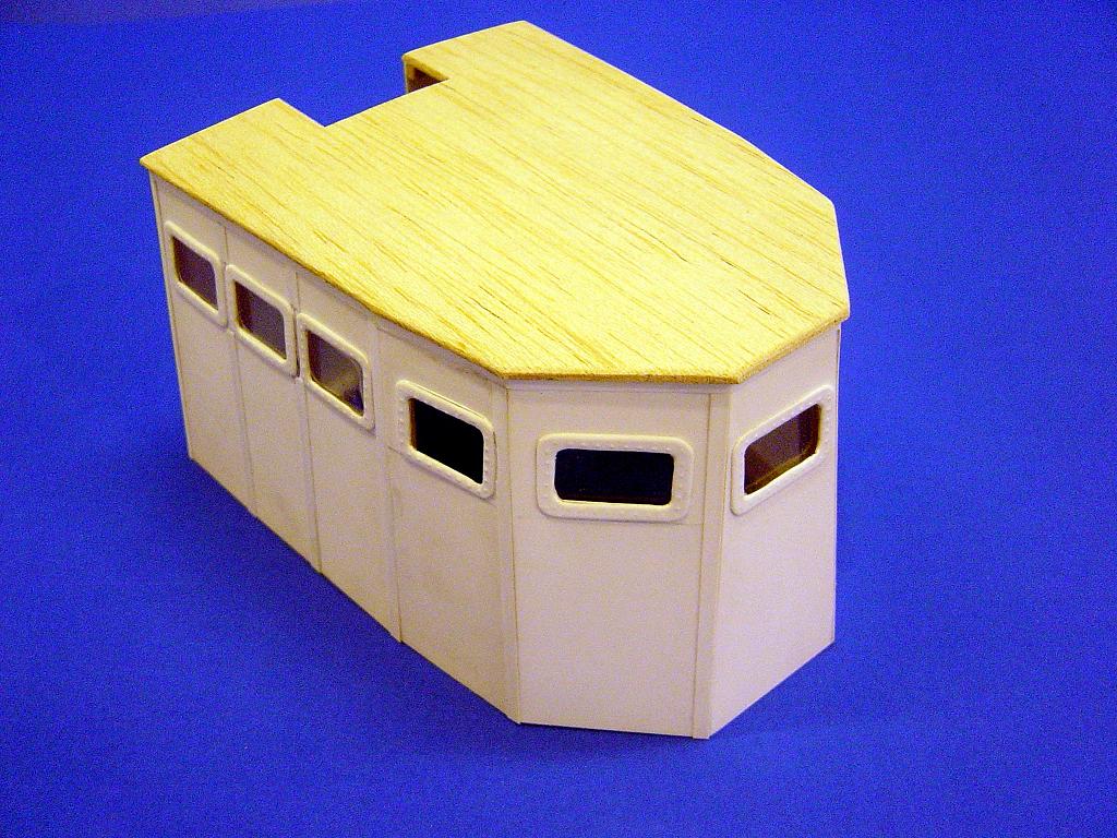

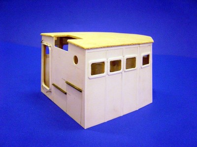

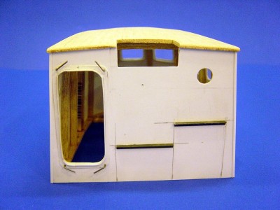

Hello again all. :wave_1: While awaiting my fibreglass hull, I decided to take on the building of the pilothouse for the boat. I call it a boat as it's a bit small to be a ship. Overall length will be about 41", with a beam of 8.5", in 1/24 scale. After an exhaustive search, there were no original drawings to be found for this later plywood pilothouse. Mr.Read and his son, who is an accomplished CAD person were able to come up with some really good drawings of what we feel this unit should look like. A best guess scenario if you will. Mr. Read was aboard during WW2 and has a very good memory of the boat. It's really quite amazing after over 65 years. In any event, going by the CAD drawings, I was able to come up with a good representation of said pilothouse. Hull has now arrived and work continues. Let's take a look...............
File comment: Portside overhead view here. House is made from balsa and sheet and strip styrene. There are 11 windows, or ports. Only two open, just behind the center one. I represented it open, while all others are glazed over with thin clear styrene. Roof is 3/32" balsa, and house walls are .020 styrene.
File comment: Stb. side overhead view here. Note the frames around the ports. I made a small mold of the frame, then Vac-U-Formed them, adding the rivet pattern with a pounce wheel after molding. I then cut them out and attached them. The three forward ports are slightly bigger than the others. The divider strips between the wall sections are .010 styrene strip.
File comment: Another view here from stb. side. Note the curvature of the roof. W/T door opening added as well as a porthole on the back wall.
File comment: Portside view here. Note the dogs for the W/T door, made from .030 steel wire. Rivet pattern around ports more visible here.

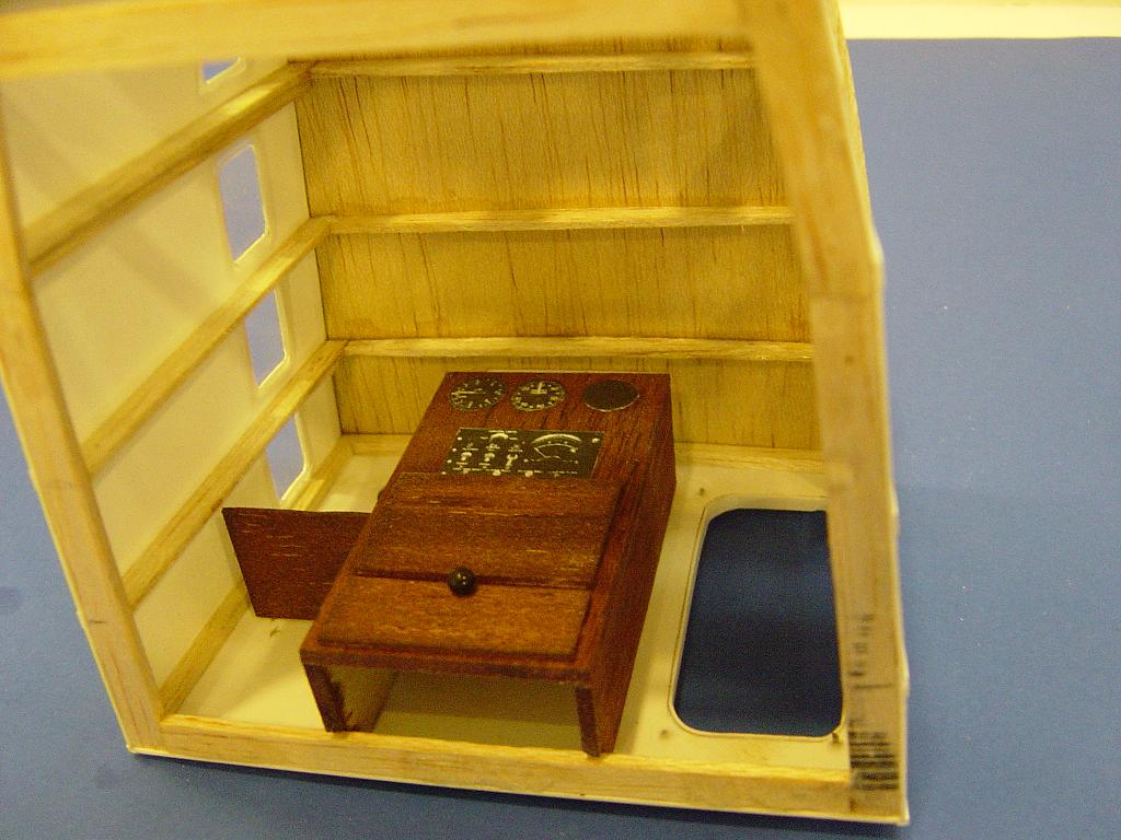

File comment: Inside view of the pilothouse. Built much the same way that the original was. A bit more interior bracing to be added. This will all be painted white. Lots of other details to add, but you get the idea.

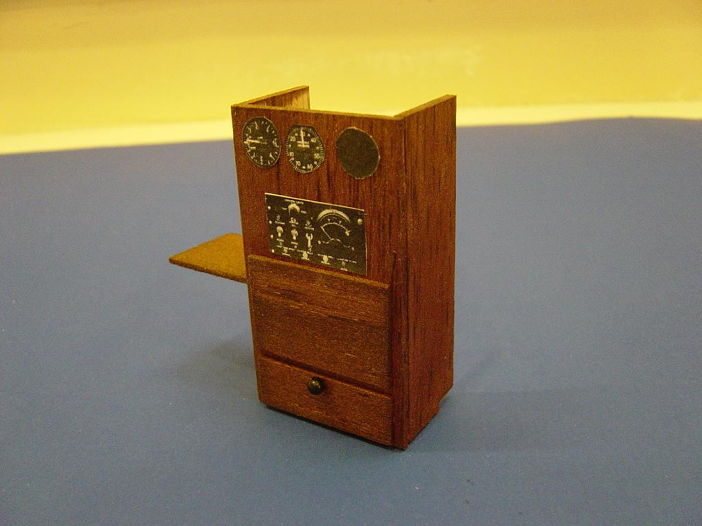

File comment: Heres the radio, desk, chart compartment and storage area located inside the house on the aft wall of the Pilothouse. Dials are clock, barometer and radio speaker with the square unit being the radio. Knob on drawer too big, so I'll replace it with a smaller one.
File comment: The above compartment in its position. Not yet permanantly attached. More to come on these inside details later.

Well, there's the rough-in on the pilothouse. Many more goodies to be added, so stay tuned! I continue on.................. :wave_1: :thumbs_up_1:

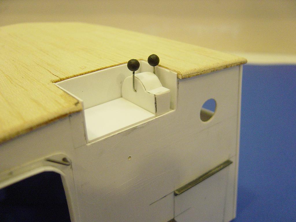

File comment: Opening on that back wall now closed in and I have added the engine controls. In the center will go a compass and to the left of that the engine tachs. Voice tubes to be added later.

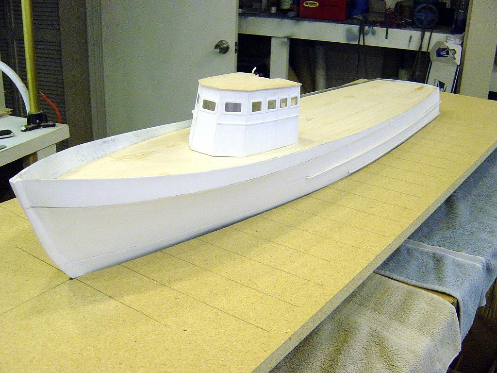

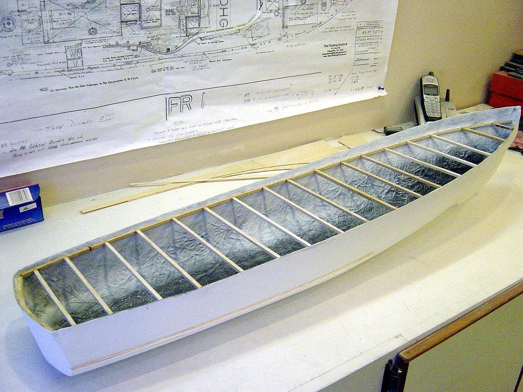

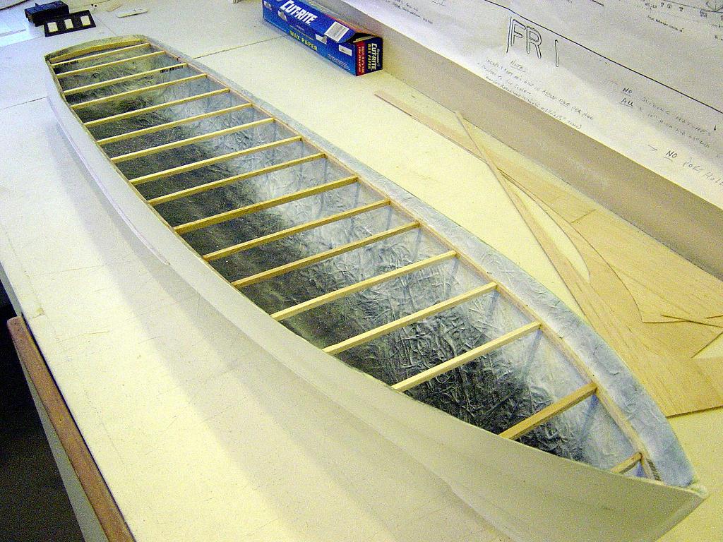

Well, I am quickly back :cool_2: As I said above, the fibreglass hull has finally arrived after 3 weeks. A screw up in shipping, but nevertheless, it is here. It was advertised as a "very clean product". The verdict? Well, it is clean. But it has no details on it whatsoever. Up to the modeler to add those. Thats Ok, we can do that! It also has a slight twist to it from fore to aft. I will compensate for that during the rest of the build. I have never used a fibreglass hull before so this is new for me. All in all, I think it will work out. The general shape looks accurate, and the finish is good. A bit of sanding and tweaking here and there. Lets take a look.............
File comment: The first order of business with this was to sand it out smooth. I then had to plot out where the deck would go. There is a line molded in the hull that shows the break between the hull and the bulwark, but it does not go all the way aft. I drew lines on the outside of the hull where the deck should be, then drilled small holes that would be visible on the inside of the hull after a coat of white primer. I then added the framework you see, plotting along the small holes already drilled. 1/4" balsa stick used here. Frame work is flat right now, I will add the camber before I secure the deck to the hull.
File comment: Another view of the deck framework. Note how rough the inside of the hull is. I will cover the inside of the bulwark with some thin sheet balsa with a styrene overlay after deck is installed to cover this roughness. Bulwark bracing and details will be added after that. Note the lower rub rail installed.

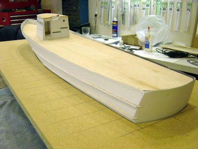

And theres the rough-in so far. Things going to plan Ok, if I can just get these people to send my stuff to the right place. :heh: More to come............Stay tuned...........I continue on................... :wave_1: :thumbs_up_1:
File comment: Now we have the hull, pilothouse and deck dry fit together and placed on the base. All loose fit for now. Note I have added the intermediate rub rails on this side. Still have to do the upper one which is slightly wider.

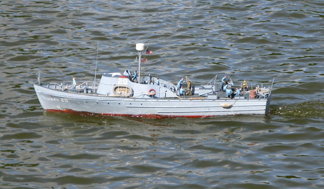

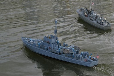

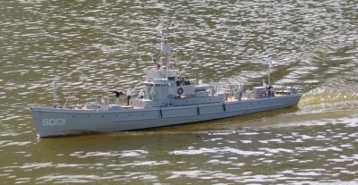

Hi Bill Here is the photo of David Jack's 83ft type and two other sub chancers .
Hope this is of some help.
