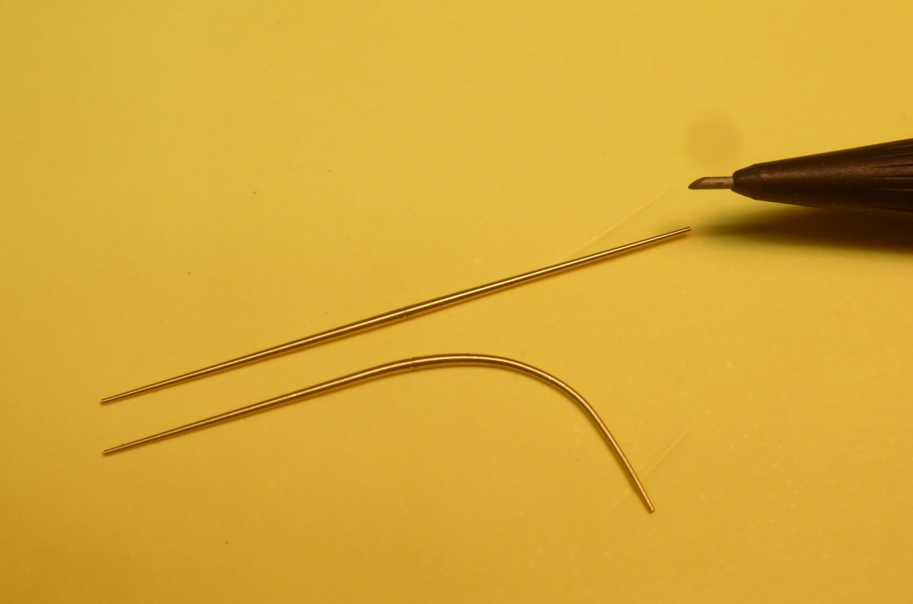

apologies for belated answer; The Nitinol wire that is easily accessible- is the one made by MODELLKASTEN
I bought mine from a dealer in Japan via e-bay
The diameter I used is 0.047 mm-- which is nice and thin and good for 1/350
and OK for some standing rigging in in 1/700... also available in thicker sizes
BUT.... I can easily pull my stretched sprue to half that size of 0.047
( How to pull stretched sprue...--see here my step by step )
viewtopic.php?f=4&t=37536
I think the ideal method in smaller scales is to use a combination of both;
have a scan 'thru here of my Normandie build's rigging,
viewtopic.php?f=59&t=168156&start=300#p934677
I used thinned white glue ( woodwroking or PVA ( use distilled water to thin ) to attach the
length of nititol wire to the deck-- and once dry--the 'propped' wire is in place, I brushed some thin runny CA glue
( Zap pacer or similar) across the upper jointo mast/ yard etc
using the tip of a cats ( discarded !!) whisker ( or a single paintbrush bristle-- very lightly spring )
Hope it helps
JB

The trick with pulling sprue really thin is to melt one end--( as per photo step by step in the thread)
dab it on the work-surface - a piece of white card- so it adheres ;
Then-- pull rapidly - as it begins to cool -slowing as not to snap.
using my method --
ie pulling from a fixed end ==> avoids blobs as first on side then the other starts cooling.
Have a go-its easy -you can pull stretched sprue to the point where you can barely see it.
try out different manufacturers of sprue...
Hope it helps
JB

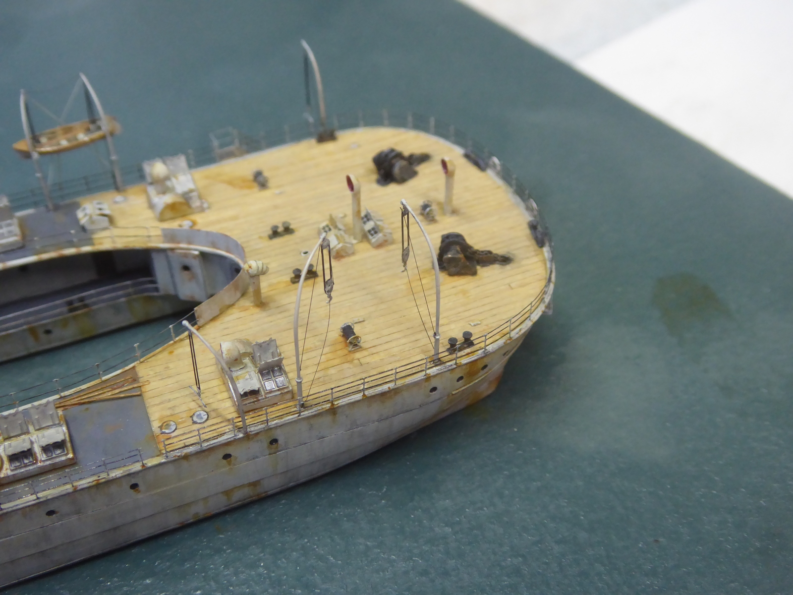

Despite it appearing quiet,,, I have been busy making small but significant progress!
The ship had a small multitude of different davits --fro boats, torpedoes, accommodation ladders etc
these varies in size and design pending theit function--
but were also in different position as well as differing types from one side to the other !

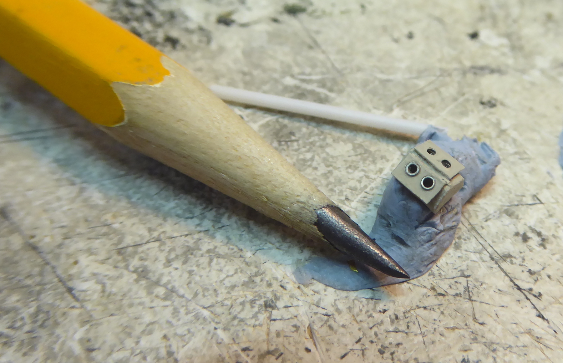

example; Midships port-side between the gantry legs; these were made by bending up Mastermodels brass yardarms to get a nice tapered davit...
all were painted in a blob blu-tack
whereas the same position set of davits on starboard were distinctly different--being the square girder type
Enhances zoomed in screenshot video still from on-line Bundesarchived WW1 film
These were made up from the ( original kit ) PE -- but extended
The other davits were broadly of similar type--again using various sizes of brass yard-arms
I reasoned that most of the small oar-powered boats as well as powered launches would have been
landed prior to her last voyage to scrapyard...
But I think she would have perhaps carried a sea-boat along with 1 x large rowing Gig Portside
I cannibalised and modified some elderly spare plastic kit boats ( for my own convenience! )
The upper pilot house bridge had distinct awning poles ; these were installed using brass wire uprights
The real ship on these awning pole uprights also had canvas screens that could be raised or lowered
Being that these are of a slightly different colour should add some additional interest to this area
I plan to make these using my usual white glue method--more on that next time
The pilot house roof aft had a Compass Binnacle, engine room telegraph relay and large voice pipe to helmsman inside pilothouse
along with very fiddly circular rail and access stairway
All circumferential deck-edge railings ( using over-etched ( ergo thinner) old WEM Koenig PE )
have now been installed...
more on that next time also
regards
JIM B

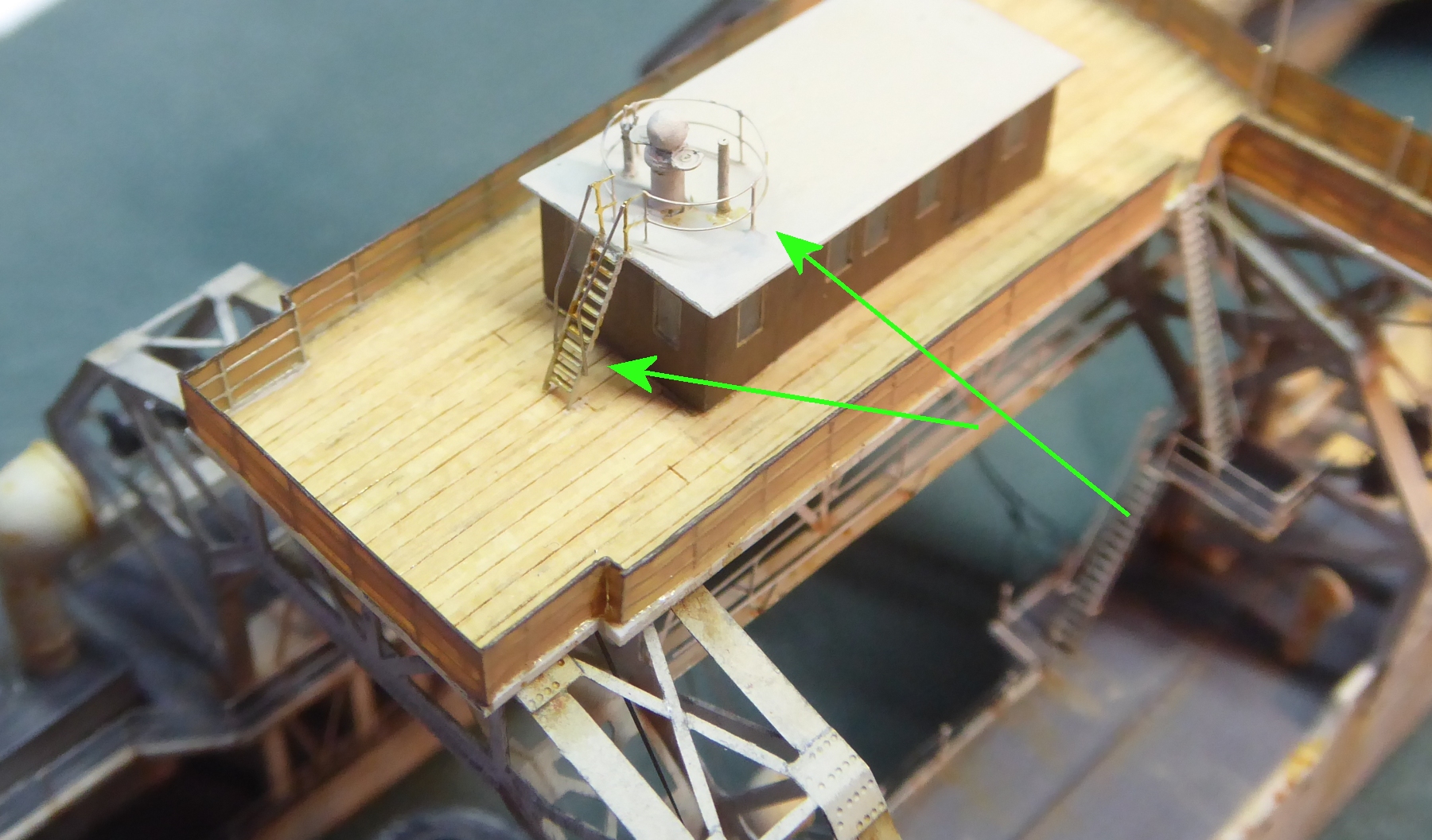

In the last update I had fitted the upright stanchions on the upper bridge and was contemplating how to make the additional canvas screens
I used the 0.047 mm Nitinol wire to ' frame ' it and then spanned the gaps with thinned white glue.
The effect is quite pleasing and satisfactory.
The aft accommodation ladder... I used the treads and grating platforms from a WEM Koenig PE set-- ( its WW1 German anyway !)
but the ( commendably fine!) handrails I was unable to use-- as the ladders on Vulkan had only a single rail
and the articulated stanchions on the outboard sides ( img )
I made new hand railings of nickelsilver wire to try and get close to the real thing
a hinged platform and a stowed accommodation ladder was espied in photos--made and added.
I noticed there was an additional skylight-- aft starboard only ( in this image)
and it IS shown on the plan ...!
So I made one !
The small sea boat which will be slung on the stb davits needed a wooden coaming panel adding
I used black gummed paper cut into thin strips, this was later painted a dull brown
The large pulling boat on the port-side was seen in images often to be suspended from the davits above the cradles
so is mine now-- ( though I still need to finish the rigging and paint the falls)
The navlight boxes were made of paper and brass and added after painting--they are still to receive their lanterns
2 x winches were made ( these operate the huge long fwd booms- not yet fitted)
There was a gangplank suspended midships across the void between two hulls
==> giving a short-cut rather than going 'around the ends...'
I made this item using some Torpedo net shelving ( sort of planked look )
and rails added to the sides

- only small steps-- but it IS coming together....
So I made one !
I reasoned that if the vessel was going to the open sea ( albeit the last trip !)
--then it was likely that the gangplank
would have been lowered to the deck and stowed... - it is now!
