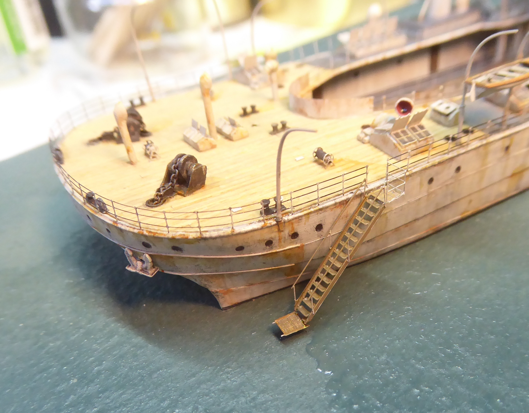

The aft accommodation ladder... I used the treads and grating platforms from a WEM Koenig PE set-- ( its WW1 German anyway !)
but the ( commendably fine!) handrails I was unable to use-- as the ladders on Vulkan had only a single rail
and the articulated stanchions on the outboard sides ( img )
I made new hand railings of nickelsilver wire to try and get close to the real thing

a hinged platform and a stowed accommodation ladder was espied in photos--made and added.
quite a number of the davits have been rigged,
spars and booms made and installed
the spars have a fixed cable to keep elevation
and running rigging for raising the spar and block and tackle hoists
Almost all of the boats were landed at an earlier time
aside from the large pulling boat port-side and the sea boat stb aft
All the other boat positions and davits were left unused and
the heavy tackles hooked at the base of the davit mountings
The pulling boat rigging has been been painted and the boat adjusted
The searchlight platform on its spindly legs and the tricky tapered railing has been installed
some items , tapered -- the function of which I have not been able to identify, have been made and installed x 4
any ideas?
I am looking forward to loosing all the shiny spots and glue marks with a coat of matt varnish to homogenise it all somewhat.
new update soonish !
JIM B :thumbs_up_1:
