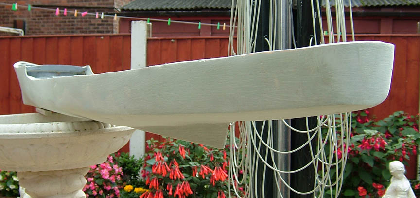

Hi Guys, As you can see I am getting there with the shape, just a little more work to be done on this side of the hull.
This bow shot shows the nice lines of the Porter hull, when dry I will turn it round and finish off the starboard side.
enjoy, ARH :wave_1: :wave_1: :thumbs_up_1:

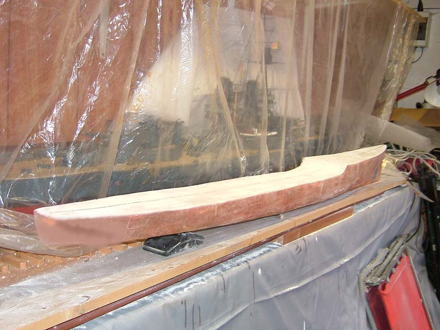

Hi Guys I have turned the plug around and nearly finished off this side.
Viewed from the stern, still a little work to be done in this section.
This is the deck layout, just trying it for fit, everything lines up nicely :jump_1: :jump_1:
The stern section, a little work to be done here.
The stern section needed to be made a little rounder on the outer edges, which I have corrected.

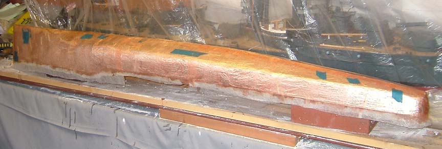

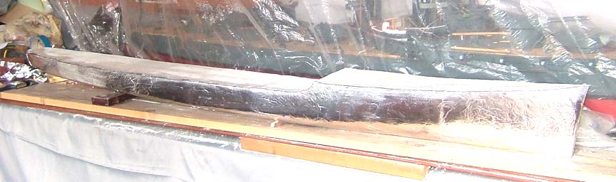

Hi Guys, I have covered the PLUG with a tin foil, I first painted PVA glue to the plug and then laid the foil on top and smoothed it out. The idea of this is to stop the resin sticking to the plug, it will come away and be stuck to the new hull, leaving me the plug if I want to cast another one.
Starboard side Bow
Starboard side Stern
This is the Port side, looking from the Bow.
Now I am ready to mould the Hull. :jump_1: :jump_1: :big_grin: :big_grin:

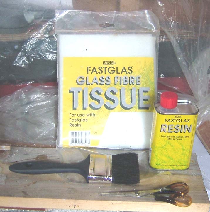

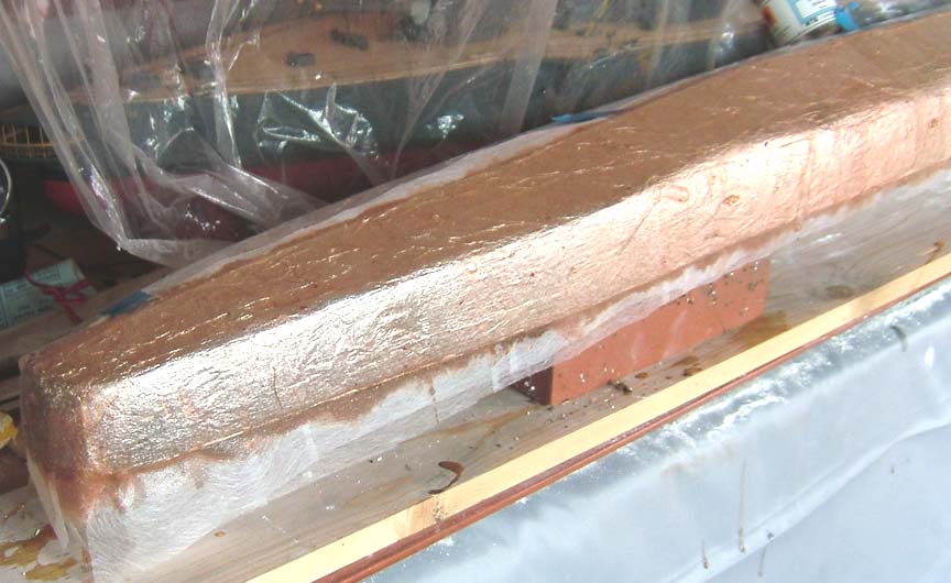

Hi Guys, This is the material I am using to cover the plug, also a paint brush and a pair of scissors, there should be a catalyst to add to the resin and a tin to mix it up in.
The matting was cut over size and taped on to the opposite side of the hull to hold it in place, bow section.
Same again on the stern section, always give it a good overlap on any joins.
On any awkward sections like round the stern, just cut the matting at intervals with the scissors and let it overlap each other, the same goes for along the hull.

Hi Guys, The resin was mixed, 1/2 a tin and the small amount of catylist was added, the first coat was applied over the matting with a brush, dabbing the resin into the matting.
Bow shot, Port side
Stern shot, Port side.
Over all view of Hull.
Bow trimmed to deck level.
Stern trimmed to deck level.

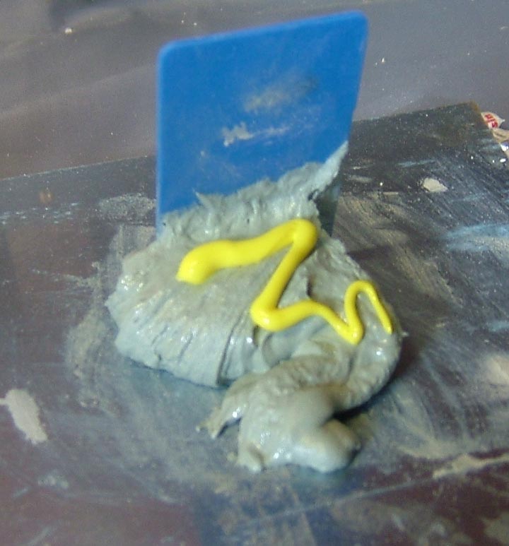

Hi Guys, This is the filler I use on top of the matting.
Use it in small amounts, add the small amount of hardener, mix it well in.
I work on one side at a time, spread a very thin coat over the hull, leave to set, then give it a quick sanding with rough sand paper.
Bow shot.
After sanding, give it another thin coat and leave to harden. Then sand with a slightly finer grade of sand paper, we will be adding another coat later.
enjoy, ARH :wave_1: :thumbs_up_1:

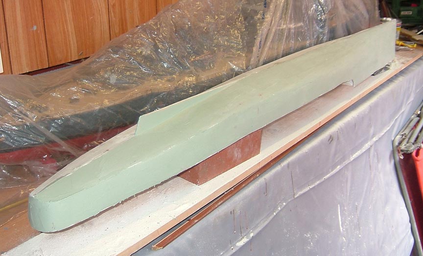

Hi Guys, A second thin coat applied.
A Bow shot.
You can see the hull beginning to get a better shape and getting stronger.
The keel section put in with filler holding it firmly in place.
A shot from the bow, beginning to take shape. Both sides have had 2 coats and the bow shape looks better.

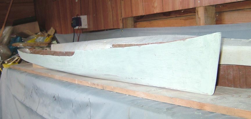

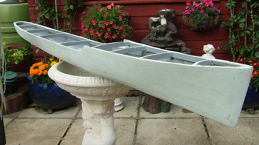

Hi Guys, As you can see the very thin layers and the sanding is beginning to show in some nice lines of the hull.
From the stern, still needs a little sanding.
A nice stern view.
The bow is looking better now, after it was cut down the middle.

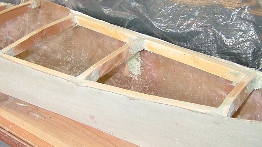

Cross members fitted.
I have started to put in the hull strengtheners. First I cut the cross sections and then I added the camber of the deck. These sections were filler pasted in position first, then I added the side pieces, again these had filler paste applied to them and fixed in place.
In the photo above you can see the filler on the far side timbers have not been sanded. The last photo shows both sides fitted and sanded. The hull is now getting even stronger.

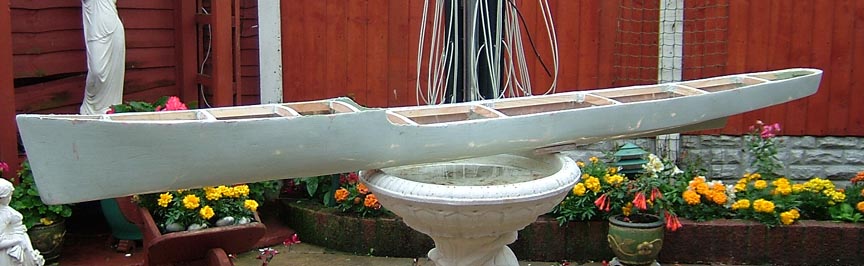

Hi Guys, When doing the side sections I usually do 2 at a time, I brace them to the side with a thin piece of plywood.
When set you can take out the ply and sand the filler to clean up the joints.
On the stern I used a piece of 1/4 inch plywood, marked and cut to shape.
As you can see, with all this work we have increased the weight to 2lbs :lol_3:
At the Bow I did the same as the stern, cut from one piece of plywood.
A view from the Bow, all sections fitted and ready for the deck.
Midships view.
A view from the stern, looking better each day. What you have to remember is at this stage every thing looks a little rough, as we go on things begin to get tided up a bit more.

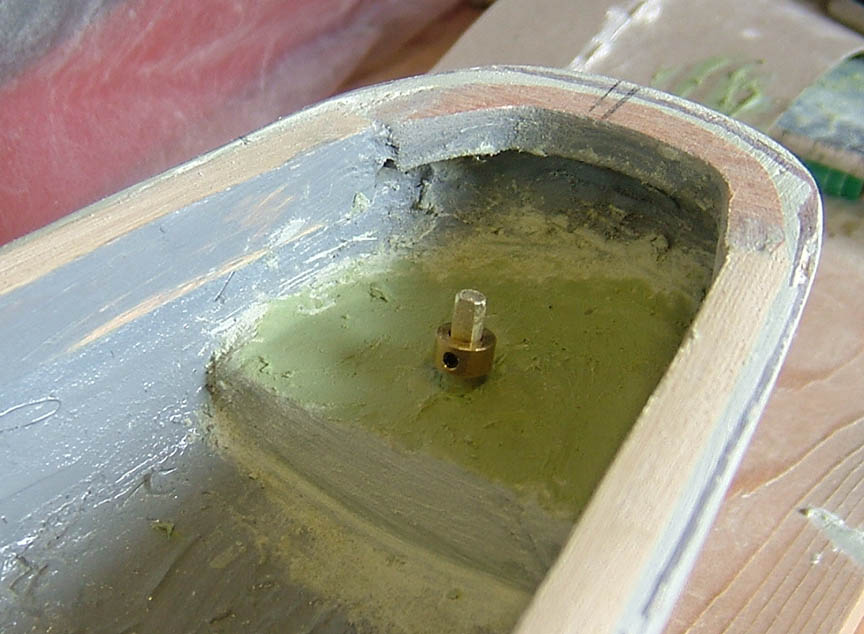

Hi Guys, continuing on, I am fitting the rudder post and rudder.
Drilling a hole though the hull large enough to accept the sleeve that will be fibre glassed in to the stern of the hull. On a ship with a single rudder it is usually on the centre line.
I have now cut 4 sections of plywood, and filed my brass rod with 2 flat sections. I have glued the sections together with Epoxy glue, laying the first section down then placing the rod just off centre with the flat downwards, then I glued the 2 side sections and then added the last top section, clamping all 4 corners till it was set. Rudder sanded to shape and fit in place.
The shaft was cut to size and filed with a flat section, then a brass boss was fitted and tightened with a Allen key to prevent the rudder from falling out. The arm to turn the rudder has still to be fitted.

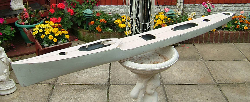

Hi Guys, All the openings are cut out and the deck nailed and glued down.
Stern view
Bow view

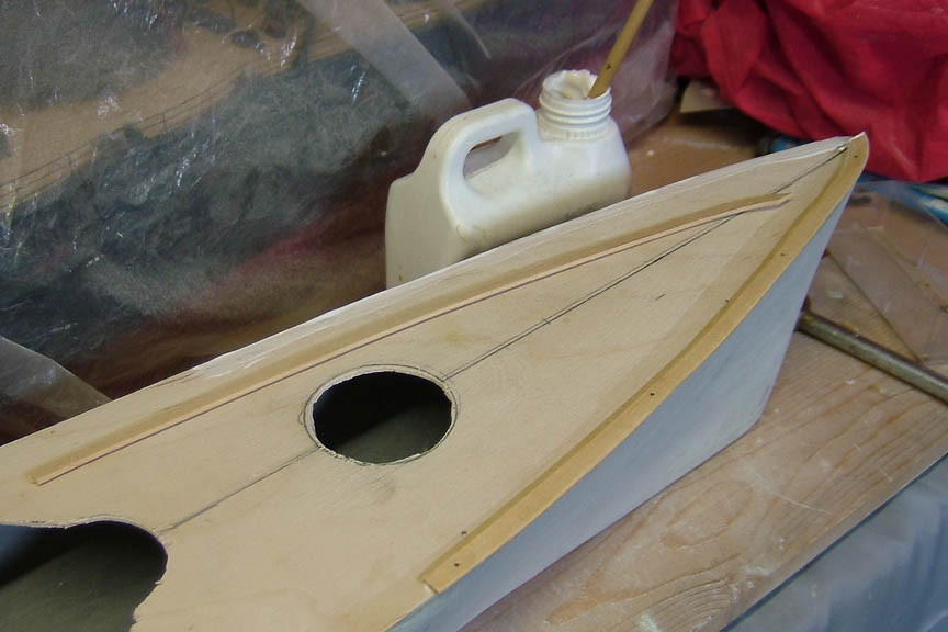

A close up of the hull, I have filled in between the deck and the hull side with filler paste and sanded to shape.
A close up of the stern, same procedure.

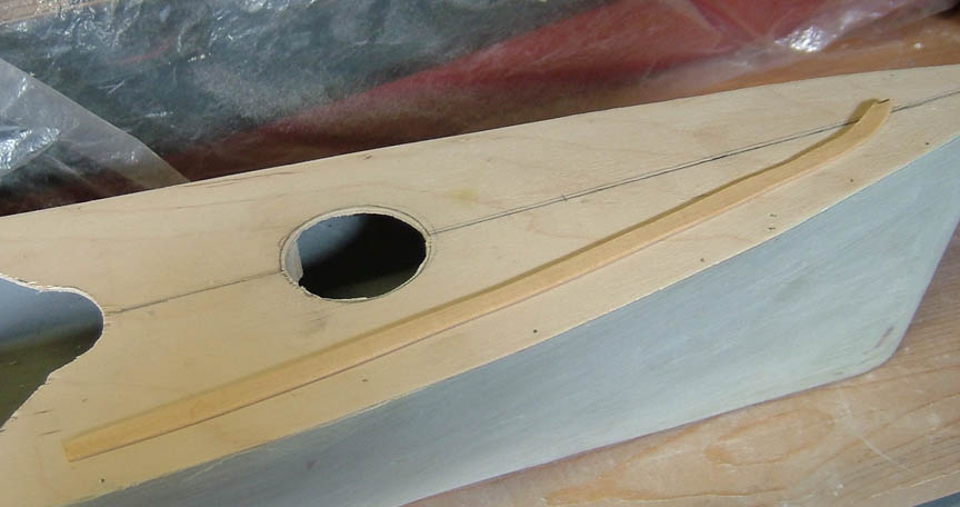

The deck edging has been cut from 2mm thick European lime wood, it overhangs the side of the hull. It was glued and nailed in place.
You may notice I have put in some between the deck superstructure.
Starboard side bow combing ready to be fitted in place.
Starboard side fitted, Port side cut to shape.
Both sides fitted, you can see the size of the nails I am using compared to the size of the paint can.
