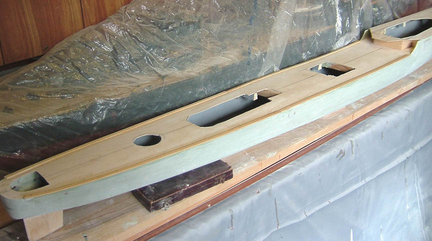

This is the deck layout, just trying it for fit, everything lines up nicely :jump_1: :jump_1:

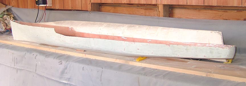

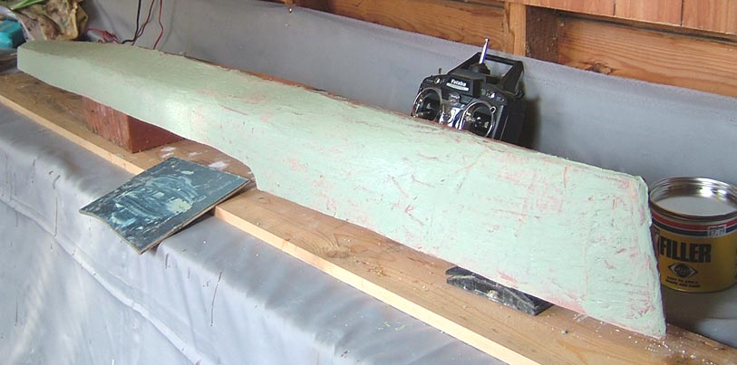

Hi Guys, This is the filler I use on top of the matting.
Use it in small amounts, add the small amount of hardener, mix it well in.
I work on one side at a time, spread a very thin coat over the hull, leave to set, then give it a quick sanding with rough sand paper.

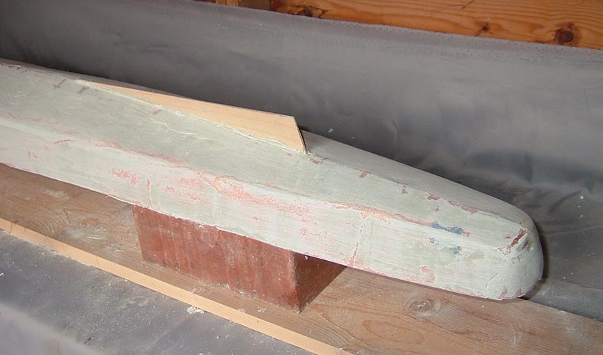

Hi Guys, As you can see the very thin layers and the sanding is beginning to show in some nice lines of the hull.

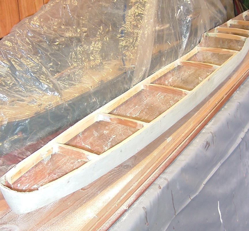

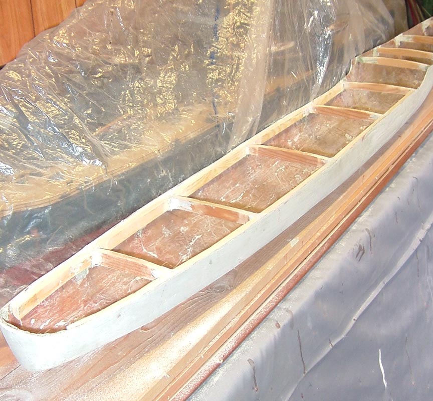

Hi Guys, When doing the side sections I usually do 2 at a time, I brace them to the side with a thin piece of plywood.
When set you can take out the ply and sand the filler to clean up the joints.

I have got to the point were I need to put on the decks, I will have to fit the shafts though the openings at a later date. One of my prop shafts is delayed due to short supply.
The first thing is to cut out the deck in 1/16 ply, and then put PVA glue on all sections around and across the hull.
The deck was laid on and nailed down.
Second picture from a different angle.
The rear deck was cut out and laid on to check for size, at this point I was going to leave the deck off so I could put in the shafts easier, but something happened, :lol_3: :lol_3:
Another view.
I cut out all the openings and left a weight on top of the hull, it had 2 wedges under to stop any movement. I then went in for my tea. I had left the shed door open because no one ever comes round the back of the house.
An hour later I came back to find the hull on the floor with 2 large cracks in it, the deck on the floor and the weight, I think a CAT had tried to climb on to the work bench and brought the whole lot crashing down. The weight must have done the damage, so I had to repair the hull and fix the deck in position to give it the added strength. :lol_spit_1: :lol_spit_1:
