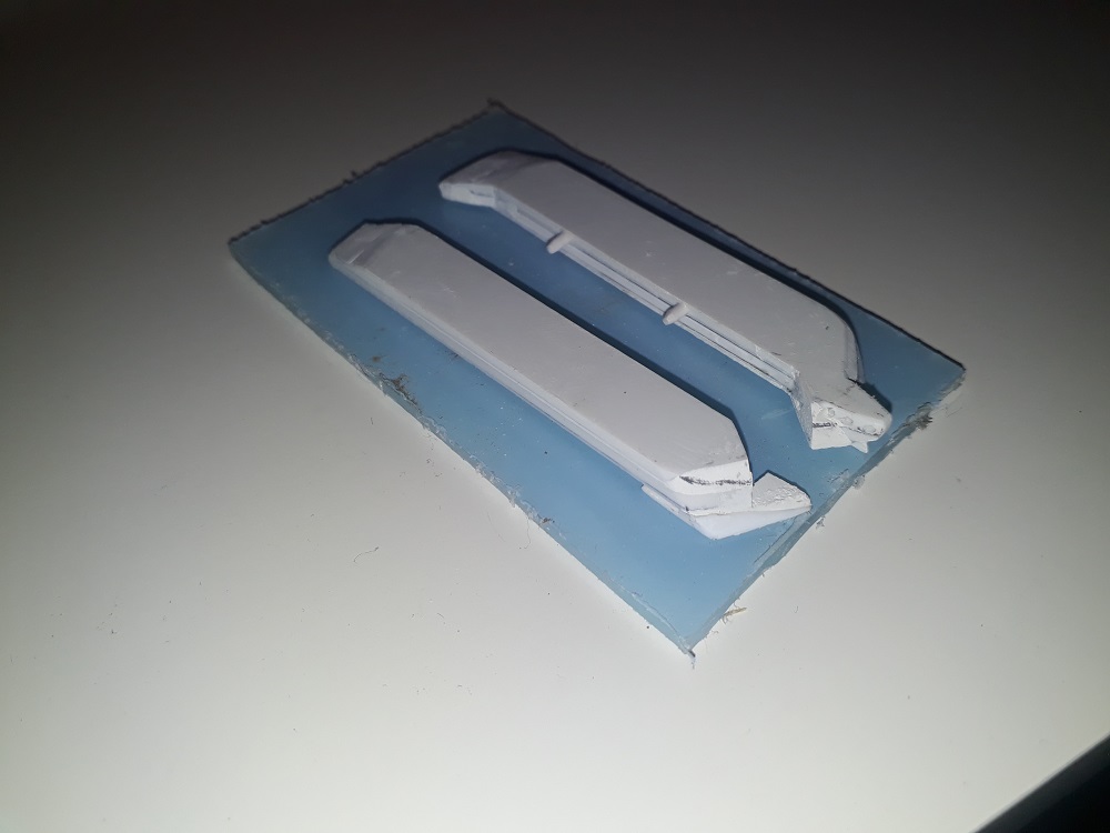

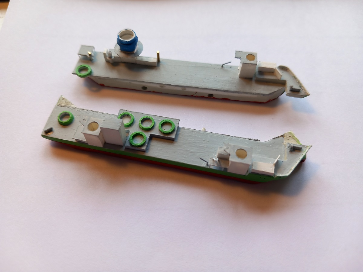

I also changed the split of the hull from the original. It now contains the bow and stern section on one side. Slanted sides along with the centering pins create a good centering effect for mounting. Also on deck the slanted sides are not continued and the split is made straight. This creates a vertical edge to align the hull halves inside the bottle. The slant also allows for an easier bow and stern construction.
The vessel has a rather odd Voight-Schneider propulsion consisting of 3 propulsion units. The center one is mounted on the slanted part.

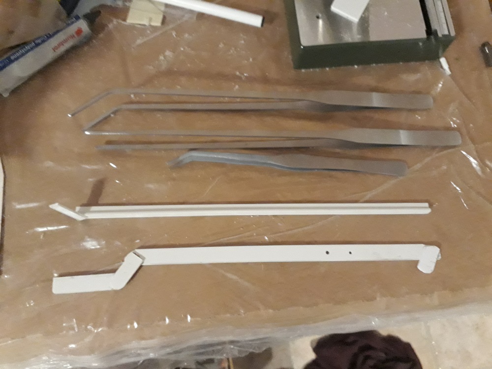

As promised here is some of the tooling and testing I'm doing.
This is the test bottle I mentioned before. I now simply put a small piece of styrene rod inside, to see whether it'll take the heat of the epoxy and also to see how it will look with the distortion of the bottle and the epoxy. This piece is slightly conical in shape as I intended to use it as a monopile in this project. It appeared however too short. So yes, the idea still is to put a monopile next to the vessel. Her deck load will consist of Transition Pieces, yellow conical shapes with a platform that are normally put on top of a monopile and which will then support the wind mill itself.
I also added different diameter wires to see what it will look like for future reference (yes, a potential next project is already growing in my mind). Here are some tools. I started off with the medium pincer, it's longer than the usual ones, but still too short to reach all the way back for this application.
I then designed the tool with the high handle from styrene in a sort of Z-shape. It had initally only the small part making it more of a 7 shape, but the angle of it wasn't correct, and the handle too high (restricting the angle I could make through the bottle neck). I couldn't reach "around the corner" inside the bottle, the area closest to the neck. I did add the longer stanchion then, to use it for leveling the sand on the bottom.
Given the experience of this one, I designed a new tool with the lower handle, and with an upstanding edge (T-shaped) to keep the rigidity. This allows for steeper angles. I also adjusted the small piece to a slightly sharper angle (keeping in mind that it has to pass the neck of the bottle). This tool does allow me to reach around the corner and is also useful for level sand when kept sideways.
I also bought a set of aquarium/ aqua-scaping pincers of 27cm long, they have small teeth at the tip, which is better for holding stuff inside the bottle and have proven very useful during trials for this project. And the vessel as she more or less is now (and yes I'm aware the paint needs some touch up and the legs are crooked, that's why the top deck of those leg casings is coming last, I use them to straighten out the top part of the legs):

Little progress. The ship has a lot more platforms and clutter than I expected when I started this. Can't leave all of it off, so I'm making tiny platforms and the rescue boat.
Will soon be rigging that crane jib with some fly fishing binding material.
Next will be the deck cargo to hide that nasty seam. It looks worse on the picture as the hulls aren't entirely pushed together in this picture (I noticed later on).
Also added some brass wire to resemble the mooring winches. The portside aft one will be covered by a platform in any case. I could probably go sharper in details, but then there's also the distortion of the bottle later on, which might not make this worth the effort. It's a first after all...

I was just getting up to speed Jim, now some real progress.
I am sacrificing quality for speed a bit, but I guess it's a bit like a Ford carrier, too many new technologies in 1 go... For the time being I did the windows free hand with a tiny tip marker. I later on figured out I could have used masking tape to at least have the top and bottom edge lined up and straight. I tested that, and it worked, but the windows were a bit under an angle. I might use a modification of that making tape-marker combo on the next build.
I added the cargo lashing equipment, which basically are a bunch of clamps to hold the Transition Pieces. Also built those TP's and started painting them. Couldn't wait to have an overview since I'm working on many different area's of the vessel at the same time, so made a small dry fit. It also helps to test fit a few things through the neck to reduce the assembly inside the bottle.

The reason I chose the Sea Installer was because of its odd length-width-height ratio, the raised crane being an additional plus (not even part of my original idea, as the legs would have been challenging enough).
I guess any modern crane vessel would be suitable, as long as you raise that crane high enough to make it fill the bottle properly.
With this build I went from idea to start of construction within 1 week, which is not what I normally do. However I've decided to live with some of its errors and learn the lessons I've learned from them. At this point I'm still happy I'm trying this, although the bottling process is something I'm somewhat afraid of.
During tests, I've always put one part of the hull sideways and push the other part on it that way. That way you can push, using only one hand/tweezer. She can't really sit upright, since both parts have the legs sticking out at the bottom, so you can't squeeze them together. However, adding all the detail on the sides now, and with the sandy bottom in the bottle, I'm hoping I don't break anything when doing this.
I'm nearing completion now, working on the helo deck. We'll soon find out how this will go
Once/if/when she is in the bottle, I'll start doing a lot of testing for additional features:
