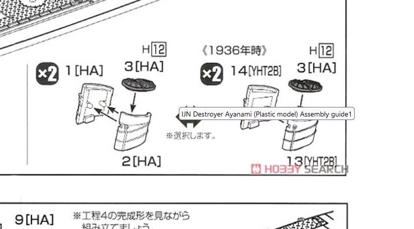

Early and late war main masts. A shame that they did not include PE torpedo loading gantries.
As to the funnels, it appears that sprue T2B offered the as-built, taller funnels. These were cut down by approx. 1 meter during the 1936 refits. (Instructions courtesy on HobbySearch Japan.)

Great point as always Dan, thank you!
I only now noticed that the PE fret lacks funnel caps as well. Really weird selection of parts here.

Both Rainbow and Five Star make 1/700 PE funnel grills. Or adapt one of the Tetra PE frets made for various YH Fubukis, I suppose.

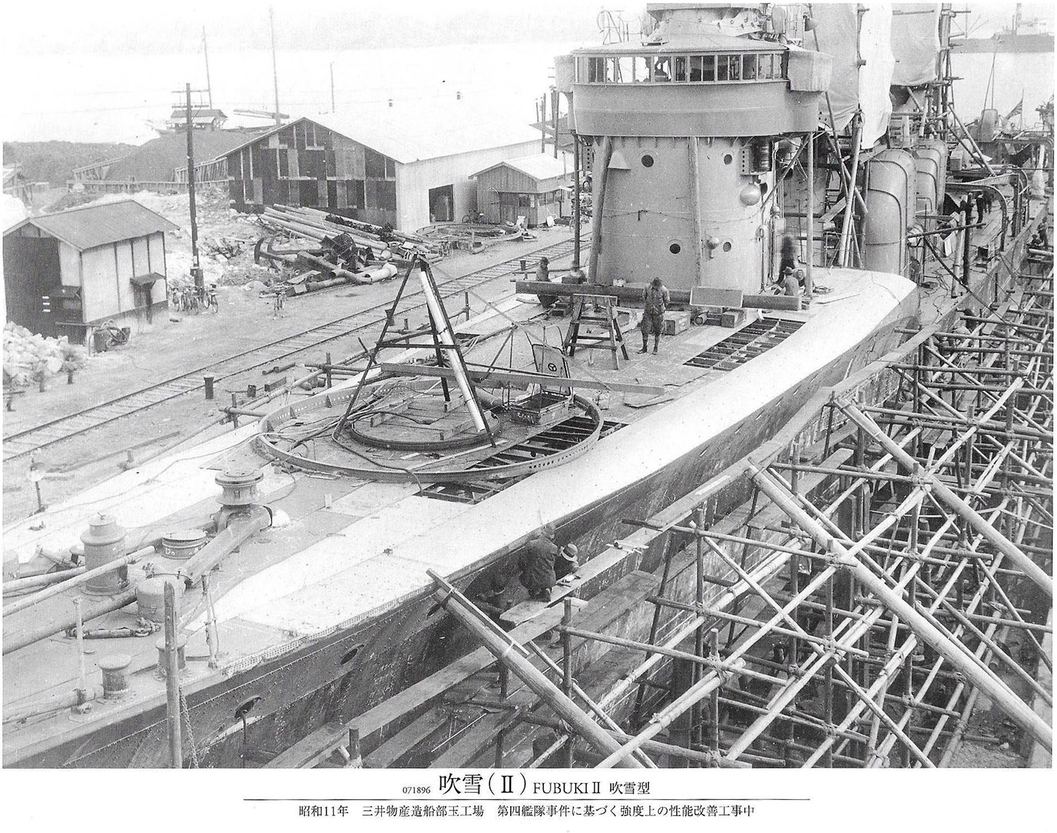

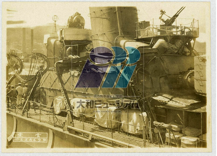

Posts: 9037
Re: Calling all IJN Fubuki class (??????) Toku-gata fans
Post by Dan K »
Sorry, didn;t see this until now.
1). The WoW layout is more correct, particularly around # 1 turret. The brown decking is linoleum.
2) Most Japanese sources indicate that the Type I s entered the war with a twin 13mm mount in front of funnel #2. Please see the Shinonome photo below. (btw, Shinonome is in drydock to repair collision damage to her torpedo reload girders.) Fubuki's last dockyard visit was in April, 1942 for maintenance, so I think it unlikely that her AA fit changed before being sunk.
3) The davits for the small motor launch aft on the starboard side should be moved forward slightly in the Tamiya kit, so that #2 TT mount can rotate and fire. See the Shirayuki photo below. Side views show the boat to be raised OVER the height of the tubes, so there was clearance.
HTH.

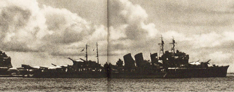

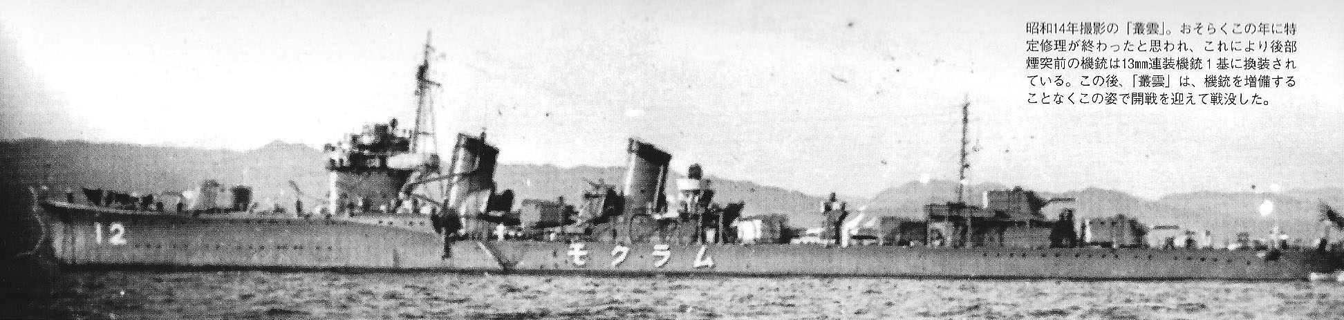

So in your opinion Carlo Cestra's poster titled "Fubuki 1941" is not accurate?
Not accurate, but there's more wrong with that illustration than just the AA and the linoleum. Wrong turret type, funnels too tall after reconstruction, rigid voice tubes removed. Around the start of the war, a more flexible type of voice tube was installed.
See modernized Type Is below

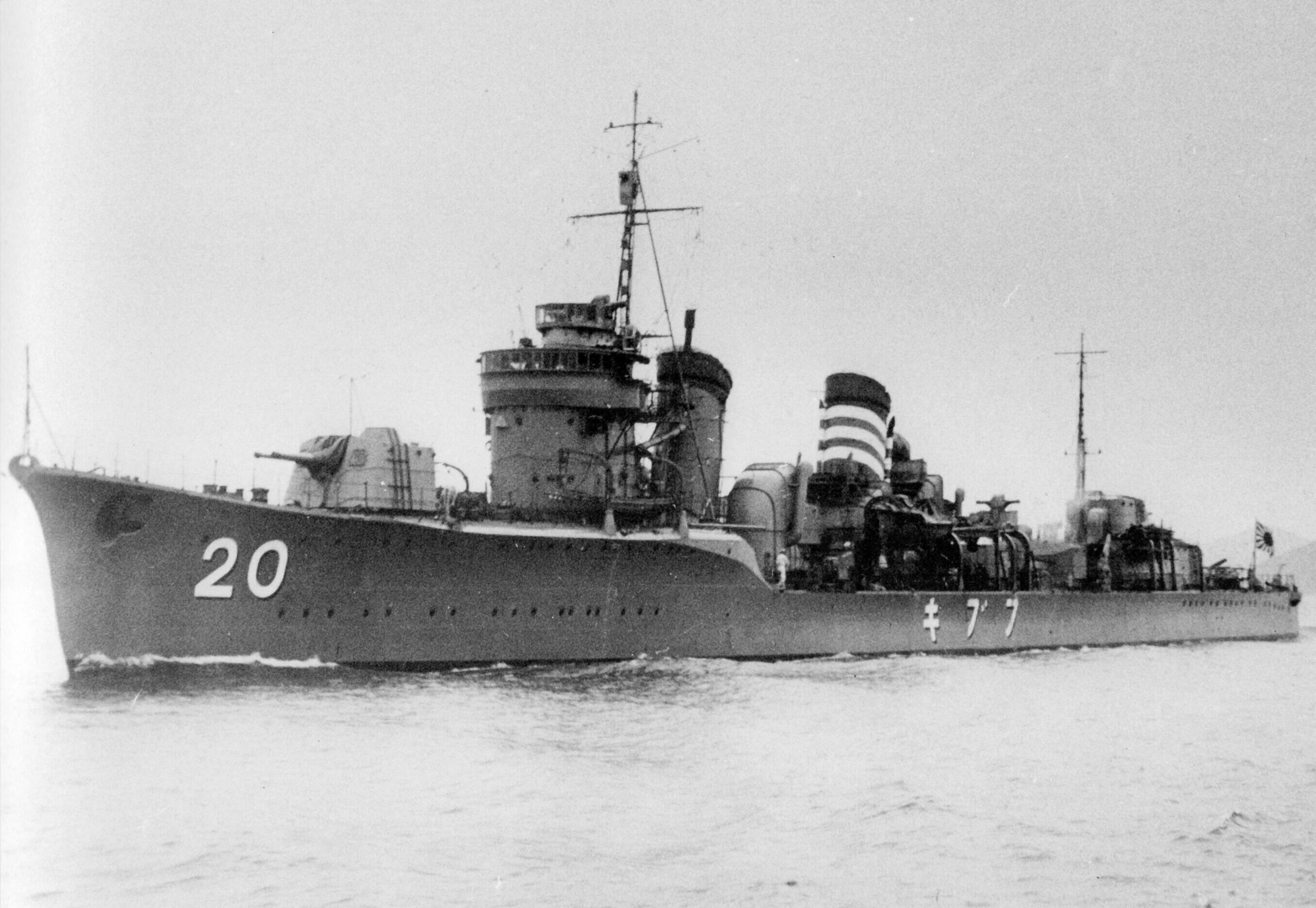

Posts: 9037
Post by Dan K »
where these new voice tubes were located
Basically in the same location, though it's not really documented at all. I suspect that such tubes were not always rigged, at least until much later in the war. The photo below of the Type II Sagiri shows similar tubes over the TT mounts. But, here, they are not extended forward or aft to the main gun mounts. I couldn't even say whether or not a Fubuki 1942 would have used them.
removing Tamiya caps as you did in Shirakumo should be enough to get them to their correct size?
I think so.
sed just brass parts like railings or some wires for this?
Various companies make mesh brass in various sizes. K & R, Five Star, maybe Rainbow, among others. I will note that Tetra makes a comprehensive set for the Yamashita Hobby Type I Fubuki kit that has most of these type parts. Actually, the YH kit is pretty good, and more accurate than the Tamiya kit. Definitely less aggravation to make it look "right". Just a thought. :smallsmile:
