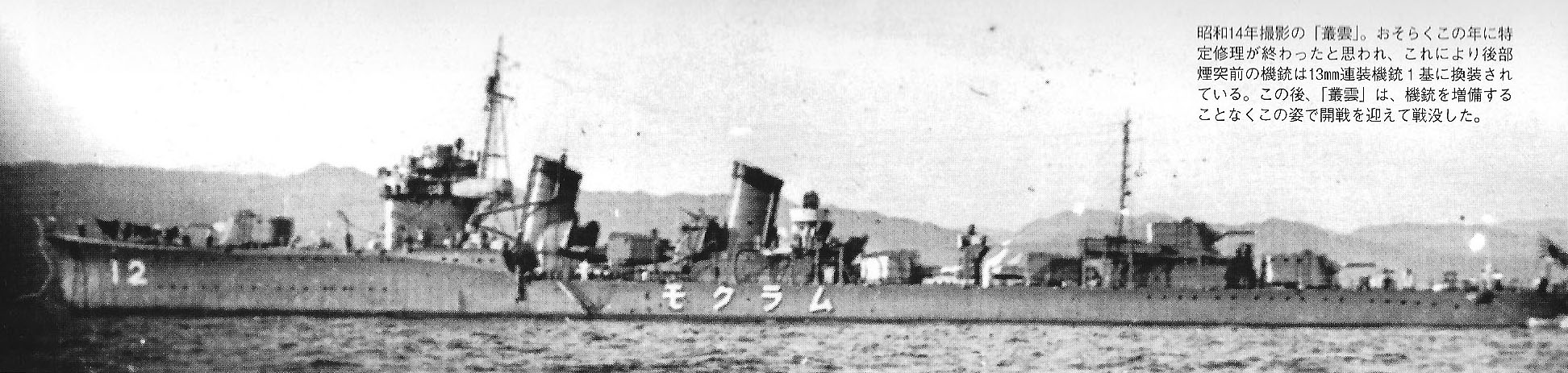

Hello. I'm pretty new to 1:700 models and trying to get my best out of 50 years old Fubuki set from Tamiya - I'd like to create model of the latest setup from before she was sunk and have a lot of doubts:
1. The area covered by linoleum - is the model from Yamashita correct: https://www.1999.co.jp/eng/image/10734892/60/1 or maybe this visualisation is more accurate: https://sketchfab.com/3d-models/fubuki- ... f3f13391da ?
In Carlo Cestra's "The Japanese Destroyer Fubuki" book from Kagero it just looks like brown painted metal deck https://www.mojehobby.pl/zdjecia/7/2/3/ ... 061_11.jpg and on the bow it also looks like metal deck with just transversal strips of metal not looking like brass bracing on linoleum: https://www.mojehobby.pl/zdjecia/6/2/3/ ... 061_10.jpg
This is a view of his appearance of Fubuki in 1941: https://fineartamerica.com/featured/jap ... estra.html
2. What was AA armament of Fubuki by the end of her service? Just 2 double 13mm guns on a platform next to 2nd funnel or there was more single barrels added later (like on one of renders of stern from above book)
3. Location of cutter at the stern. In Tamiya's model it is right next to the front torpedo tubes making it impossible to launch them in this direction. In other materials about the class I see this cutter moved slightly to the back, sometimes more to the front or even not present - where it should be in real in 1942?
PostPosted: Thu Feb 02, 2023 12:39 pm
Posts: 8867
Sorry, didn;t see this until now.
1). The WoW layout is more correct, particularly around # 1 turret. The brown decking is linoleum.
2) Most Japanese sources indicate that the Type I s entered the war with a twin 13mm mount in front of funnel #2. Please see the Shinonome photo below. (btw, Shinonome is in drydock to repair collision damage to her torpedo reload girders.) Fubuki's last dockyard visit was in April, 1942 for maintenance, so I think it unlikely that her AA fit changed before being sunk.
3) The davits for the small motor launch aft on the starboard side should be moved forward slightly in the Tamiya kit, so that #2 TT mount can rotate and fire. See the Shirayuki photo below. Side views show the boat to be raised OVER the height of the tubes, so there was clearance.
HTH.
