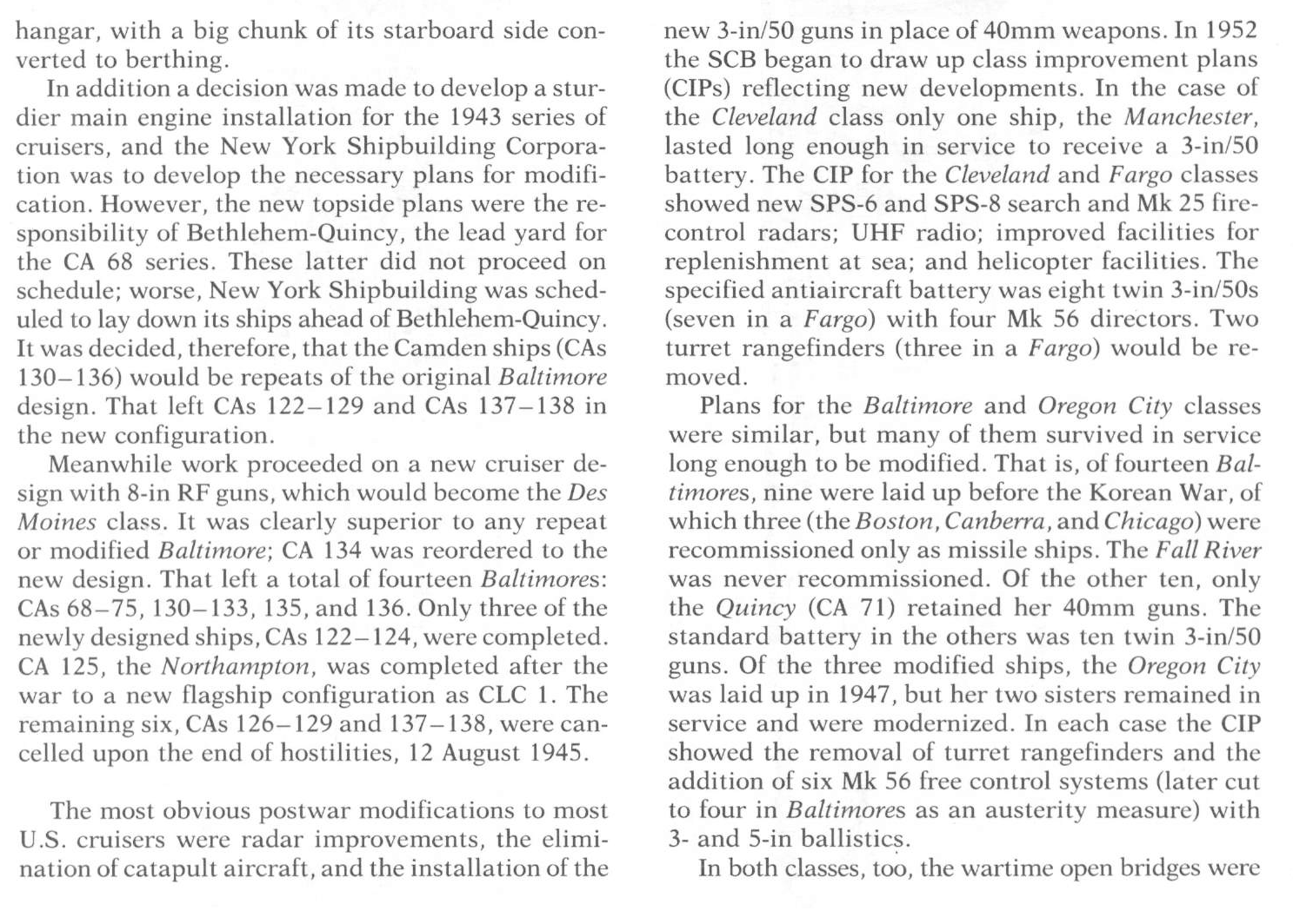

Does anybody know if there are photos of the two Fargo class cruisers USS Fargo and Huntington in the 1950's when they received their CIP (Class Improvement Plan) upgrade?
PostPosted: Wed Jun 28, 2023 1:12 am
Posts: 166
Location: Hajdúszoboszló, Hungary
I've checked (I usually check 3-4 sites for photos and navsource is one of them)
About Fargo I only have two long range aerials from 1953 at Bayonne Naval Depot (Refit should had took place in 1955)
And a few from 1961 when she was deactivated (Sensors removed, 3" guns had their cupolas)
As for Huntington a single 1955 aerial blurred photo when she was at Philadelphia Naval Shipyard (Barely identifiable) and one photo from 1961 when she was deactivated, aft view.
PostPosted: Wed Jun 28, 2023 1:46 am
Posts: 166
Now I'm not sure the two Fargos got the CIP refit as part of the SCB-74C.
Most sites tells that she was put on reserve or decommissioned in 1950, some others state her twin Oerlikons got removed in 1955, while Friedamn states what was the armament and radar canges of the Cleveland and Fargo classes in the CIP but not clearly states if Fargo got it at all.
PostPosted: Wed Jun 28, 2023 6:00 am
Posts: 3841
SCB-74 was the upgrade to the 3-in/50 RFG mounts replacing the 40-mm mounts. Only one Cleveland class got this mod, USS MANCHESTER (CL-83). Both of the FARGO sub-class were decommissioned in 1949-50, prior to the Korean War.
