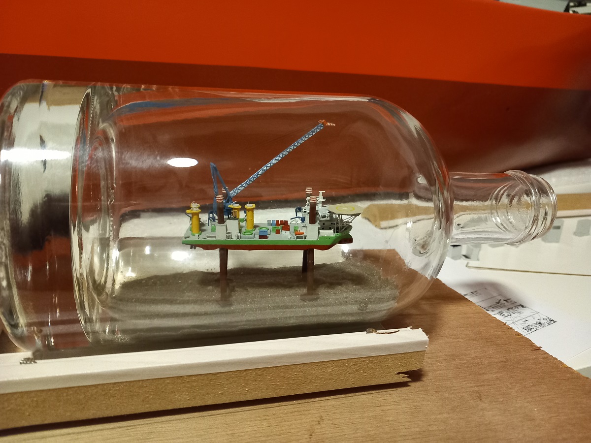

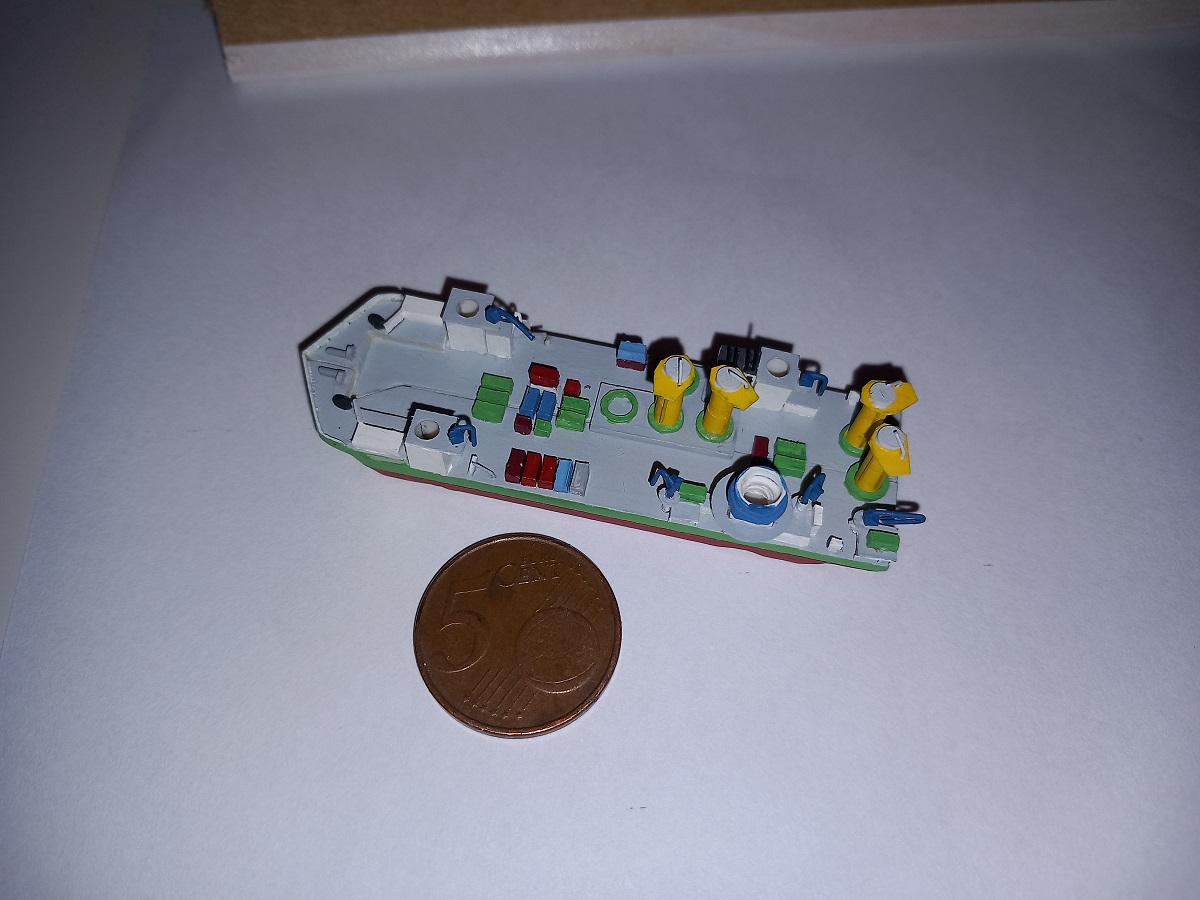

Time for some test fitting with the bottle.
And some more platforms all around the vessel. Luckily they are nested against more solid structures, so I only need to make 2 legs and I can glue the backside to these more solid structures.

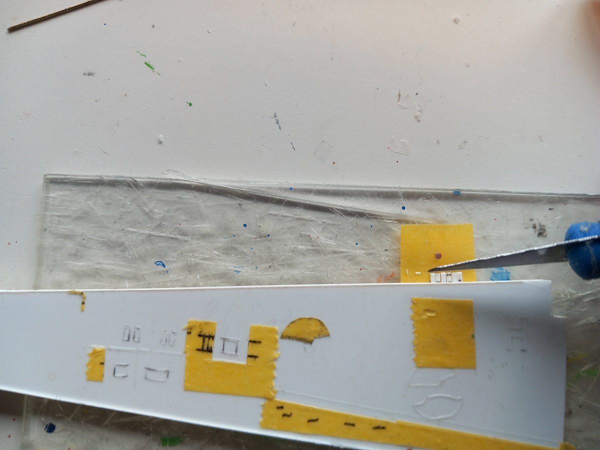

And for the gratings on the engine casing, I decided to paint them. Since they are slightly bigger, I opted for masking. I can't cut them this fine and close to each other, so I made one large hole and then separated the separate grills by using a tiny strip of masking tape.

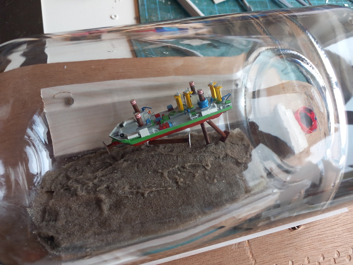

Nearly there now, some minor paint jobs and she's ready.
I've also tested the etching cream. Test went like a walk-in-the-park, of course on the real bottle, it went sideways (a little). Some small bleed underneath the mask has made the result less then perfect. On the other side, it is only in the background, so I guess I'll keep it that way.
Been thinking about doing the whole bottle thing all over again, including the sand, with a new bottle, but that would take again 2 weeks, and I don't want to spend that amount of time on this first attempt. I'll just make the best of what I have.
I'll let the pics speak for themselves. The crane was eventually rigged with Uni Caenis thread for tying flies for fly fishing. Clearly the thinnest thread there was, also the weakest, but strong enough for this job.

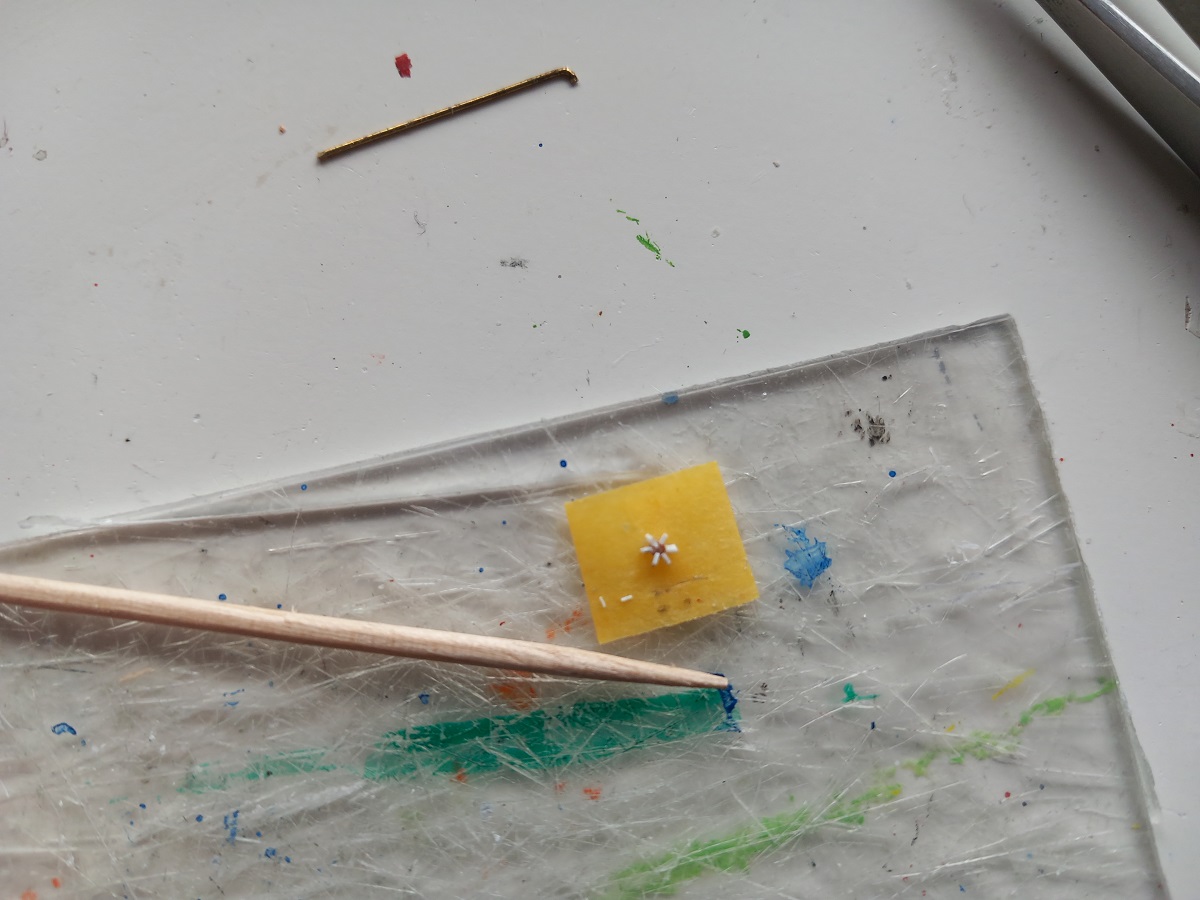

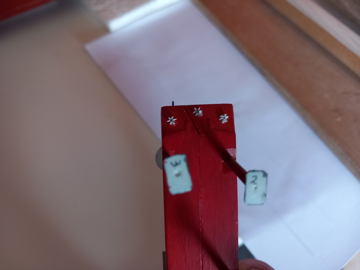

Easy to forget in my rush to have it finished, but I still needed to add the Voight Schneider propellers. I wanted to do that last, since they would be very vulnerable during all manipulations of construction.
I also first did a test in the test bottle to see if my sequence would stand a reality test. I noticed the legs were trouble, too hard to press down, which I could do with the prototype, but with all the details on the real thing, it was hard to press without damaging something.
Decided to file a bit off the leg part that would fit in the "sleeve" of the hull, for easier up and down movement. Then the Voights. Built up from tiny strips of Evergreen, which I eventually made even smaller. I made a core of 1mm styrene rod (brown, you can see it glued to the masking tape above the blades.
I then cut lengths of 1.5mm of the strip. Then I lined them up on some masking tape to avoid them flying away, and cut them with scalpel to have same length. I then glued the strips to the central piece of rod/disk. And once the glue set, I pried it off the tape to glue them to the hull. I did this method to avoid handling the vessel and working on it directly. Afterwards I painted them. I had to make 3 of them for this ship. That was the final step before bottling.

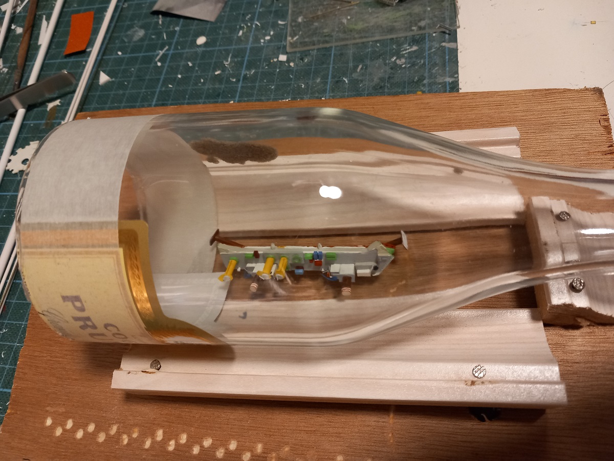

Well time to dive in. 1st attempt (yep!). Attaching part 2 to part 1 was as expected and practiced and went quite well. The crane somehow wanted to shift and twist all the time in the tweezers, so took me a while to find the balance. The hull bouncing around didn't really help neither. As you can see, the legs go tangled, so it didn't want to sit properly. Then leg 1 dislodged. The tiny pin (0.3mm copper wire, normally locked in place with CA) came out and the lower part fell out. I never quite thought of that going wrong... In any case, I was still of the illusion that I could fix that once I got the other 3 legs properly deployed. Until... a second leg came off. After several attempts to deploy the 3 legs, 2 went without a fuss, but the crane leg came off as well. I'm assuming I took out the CA glue during my last adjustments with the file around the hinge to make it slide easy. The leg was blocking completely at first, something that never happened before, I found out it was blocking on the partly extended pin. And yes, I did get nervous during this whole process and some curses escaped me.
I guess I need to fix those pins better.
I used 0.3mm wire in a 0.5mm-ish hole since pressing a 0.5mm wire would be difficult and possibly break the hinge off the leg. This time I am going to press that 0.5mm wire in that hole to make sure it wedges itself in and won't come out by itself.
You can see the etched DEME logo near the back of the bottle in some of the pics as well. Be it under an angle.
The merchant shipyard

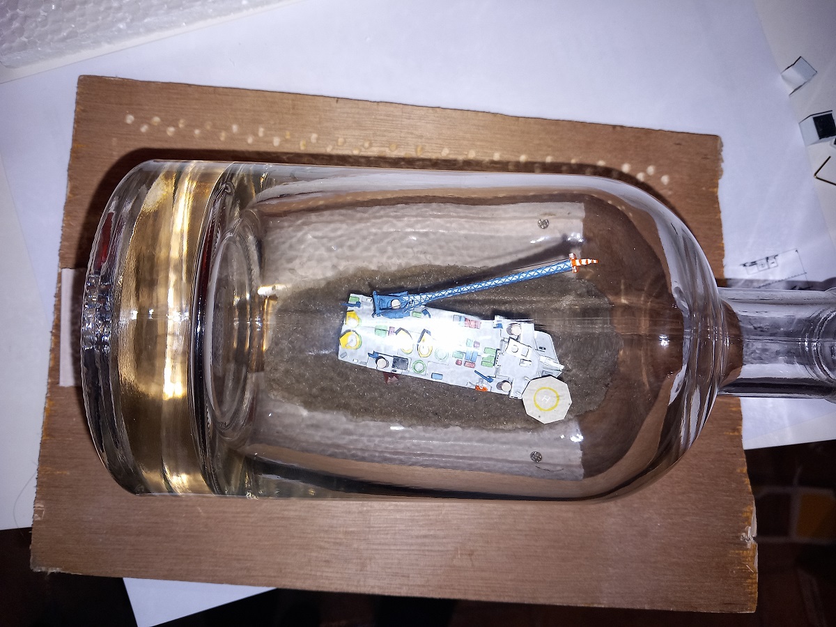

As giving up isn't exactly in the dictionary, off to attempt No2.
Given the issues with the pins and the pretty obvious solution, I went ahead to fix it and try again (can't wait too long or I run the risk of shoving it somewhere at the back of a shelf).
This time I was succesful, except for 2 small issues. 1 leg was twisted, so the foot was pointing (Chaplin-style) outward. Second issue is that the glue on the accomodation block didn't seem to catch, so I assume I couldn't/didn't press it hard enough in its place. The latter action is also difficult as she's far from steady on the sandy surface. I'll wait until she's fixed in place to have another go at that.
She's not in final position yet as I'll fix her with the same sand-acrylic mixture as I used on the bottom. This will make her more steady and make sure all 4 feet are touching the bottom.
At the same time I'm running some epoxy tests as well as making a wind turbine hub to mount over the neck of the bottle.

Hi Jim,
luckily I didn't have to do that. I was indeed doubting between waiting for the glue between the hull halves to set, so I'd have a stronger platform to build on and manipulate or just to continue building.
Luckily I just continued, so I was still able to separate the halves. If that wouldn't have been possible, breaking the bottle would have indeed been the only way...
Next step was to attach the ship to the bottom to prevent it from floating (and toppling over) in the epoxy. Same for the monopile foundation I placed next to the vessel.
I then filled some holes between the feet and the (rock-hard) sandy bottom. Both gluing and filling was done with acrylic-sand mixture to blend it in with the bottom. Next up was the filling of the epoxy. As you'll remember, I had a test bottle. So first test was with that bottle. I also added the Uni Caenis (nylon) thread along with the woven Uni 8/0 thread in it. Just to see what it would look like in Epoxy and to see if it would withstand epoxy at all. The test bottle was ok, some bubbles which were immediately visible when I mixed the two components. I probably shook 1 or both components too much before pouring. Most of them disappeared due to the slow curing. I also noticed that some bubbles came from the sand, so despite the slow pouring, air was still trapped somewhere and released perhaps too far down the curing process of the epoxy. I didn't like the colour too much, so I decided to add more pigment for the real thing.
Then came the real pour. I'm stuck with some bubbles, but I can live with them. I noticed some air escaping from underneath one of the feet at regular intervals and relatively late in the curing process. Luckily none of them remained trapped mid-epoxy.
Not sure on the hub, it looks a bit heavy and eye-catching. Perhaps with a better stand underneath it will look better. And at least the model is finished now. I'll see about the "extras".
