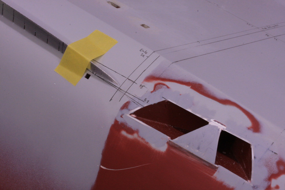

Bismarck has large grills for cooling water intakes and discharge on the side of the hull, above turn of the bilge. I recall seeing drawings of the duct work which indicate the interior ducts are a horizontal Y shape, with one branch being the intake for cooling water and the other branch are for discharging used cooling water overboard, and due to the size of grills the ducts are easily visible from the outside. but i can’t find the drawings.
would anyone know where i can find drawing for these?

PostPosted: Fri Dec 01, 2023 9:15 pm
Posts: 4045
Modeler Bernd Willmer constructed the intakes and discharges from what appear to be good drawings for his amazingly detailed 1/100 scale Bismarck model. Although I don't have his drawings or his contact information, here are photos he posted years ago of that work.
Perhaps someone here will be able to help further.
