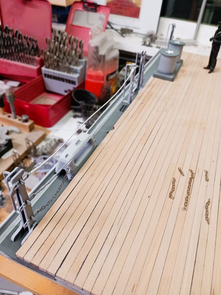

Today/tonight I worked on reprinting a couple times the lifelines/connectors until I got them long enough. Then worked quite a while tonight on installing the several chains that go between the H Stanchion & Pipe Stanchion when the fueling station is not in use.
This was extremely tedious work and with the shop in the upper 80s tonight, not real comfortable to work in. As Mr. Skunk was out and about snorting grubs in the back yard, I didn't think it prudent to leave the shop door open. Tomorrow I'll check out the local feed & seed and see what they recommend to repel skunks from the yard - too bad because they grovel for Junebug & other insect pest grubs in the ground. When I went out to the shop after evening chow, we did have a distant encounter, but not of the 3rd Kind :doh_1:
Here is tonight's progress -
Tomorrow I'll paint the chains and begin getting the F.O. Station parts ready for installation.

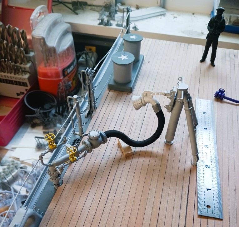

Thanks - as for the inside lip, you are correct, but I had to make some adjustments. I may be able to slide a very thin piece of styrene sheet along the outer deck edge, but I'll have to think about that first. At this point, the one photo that does show the lip simply didn't catch my attention at the initial design stage. I also left off the myriad of bolt heads that are on the surface of the outer angled surface of the waterway as this probably would have stopped DSM altogether if I had put them in.
Here is today's fitting of the F.O. piping - not permanent at this point:
I've still got a bit of work to do on the decking where the tripod is secured before actually adhering the piping in place.
