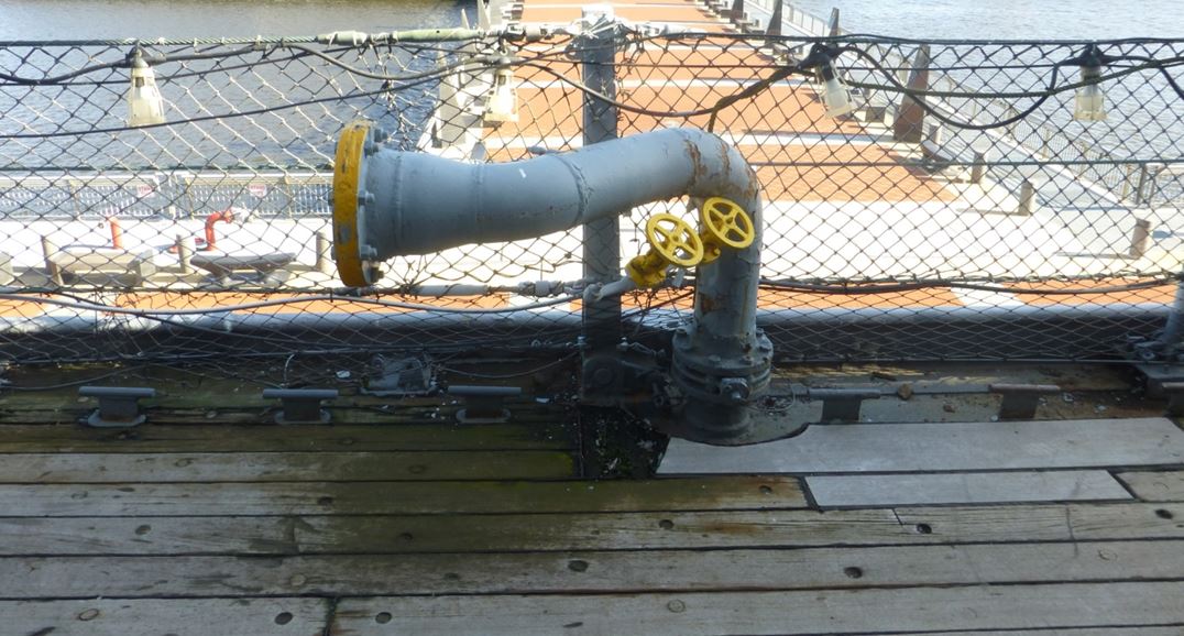

While on board USS WISCONSIN (BB-64) during a 2019 ship's reunion, I took quite a few photos of the deck gear and equipment. Recently I became interested in the refueling stations that were installed on these ships in their 1980s refit. There are (4) of these stations located on the main deck - 2 on port side, 2 on starboard side. As I've discussed in other threads, these items are NOT identical but similar - again, I believe that the two primary yards involved in these rebuilds (Long Beach NSYD & Pascagoula, MS) took the general plans for the class and came up with their own construction. They are very much alike, yet not identical. As for the museum ship configurations, WISCONSIN has pretty much a complete RAS unit intact on her after portside station. NEW JERSEY, on the other hand, has only the F.O. riser and valve (blanked off) without any of the associated piping, tripod, flex hose and so forth. Due to having somewhat fairly decent photos of this unit on board WISCONSIN, that is the one I decided to model. In a 1/24 scale, this gives me a 17" long x 8" display area of the deck with all the fittings and equipment that appear in that area of the main deck.
So, here are a couple photos of typical F.O. RAS (replenishment at sea) stations on board USS NEW JERSEY (upper) and USS WISCONSIN (lower) - (Thanks to Big Jim Slade for the photo) (I believe I got this photo from Cliffy B several years ago) as my photos are all from deck level or from aboard the tour boat!
So at this point I have 3D designed/printed all the necessary parts for building this display. Here are a couple composite shots of my design. This does not include the wood deck which the display model will have - so, items may appear to be "hanging" in space - Note - I have revised the angle & flex hose on the fuel station assembly since making these composite pictures.
I have done a couple revisions to the actual F.O. piping assembly as well as adding various connection loops & details to the basic H Stanchions & Closed Chock which I originally designed & printed. Tonight, I finished adding the decking, which is all individual wood strips glued to a built up display board of 1/16" thk. Plexiglass sheet (3 layers) + the 1 1/2" wide deck edge pieces which include the waterway and outer side of the hull. You can see this in the composite pix above. The smaller purple riser & valve is for the JPS aviation fuel piping which is also mounted in this area of the deck at each RAS Port.
While my photos were obviously helpful in designing this display, they were somewhat inconclusive in being able to determine some details of this area of these ships. One of Big Jim's illustrations in his USS NEW JERSEY book (Vol. 1) did clarify some sizes, etc. and I used that as a basis for the general height of the tripod and adjusted as needed. The unit on WISCONSIN I don't believe is as high as the one on NEW JERSEY.

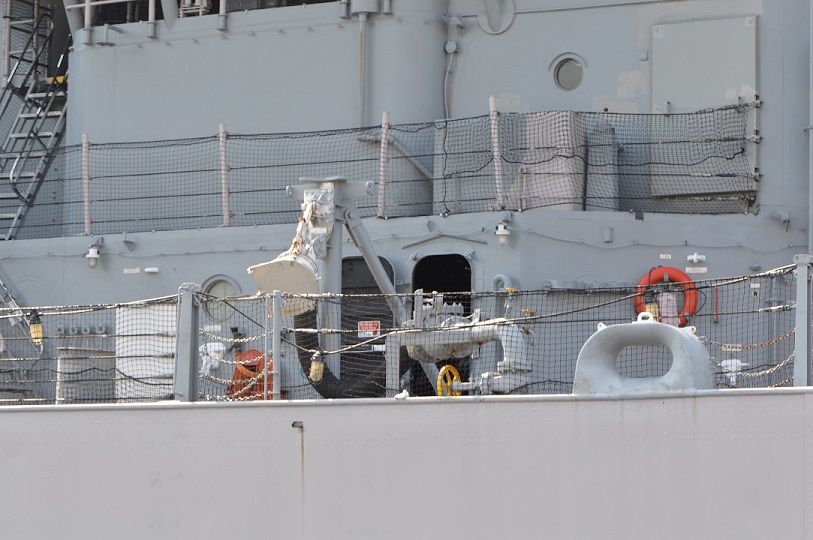

Here is another shot from the tour boat that I took of WISCONSIN's port side after station - (My display will not include the nozzle blank that is installed as shown in the photo)

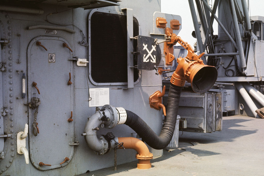

Hank,
We had pretty much the same refueling equipment on the OK City, with a different arrangement of parts. Here is a close-up photo of the rig and my CAD model of it.
PS: I didn't model the "corrugations" in the hose, but just used a smooth hose. The ridges would have added many tens of thousands of facets to a drawing that already had 2.2 million objects and about 22 million points!

Thanks for the additional info/photos - I can use those as a confirmation of my design of the hose & nozzle apparatus. You took the same approach I did with how to design the flexible hose - those ridges, while different somewhat on the battleship rig, could have been a design killer to do in 3D. My print came out very nice without them and I'll use it as is.

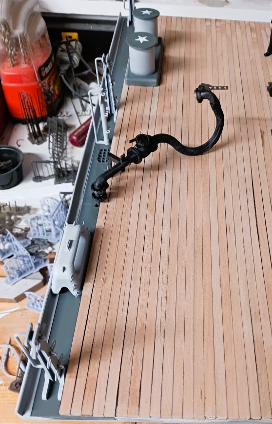

After a couple more redesigns & reprints, I've gotten this display fairly well in hand -
Now that the lifeline stanchions are in place I can modify the lifeline/connectors to fit - always a bit of a difference in reality and design. Will reprint those tomorrow. I hope my paint arrives so I can paint the F.O. unit and JPS piping - so, this is moving along fairly well; the tripod is already painted.

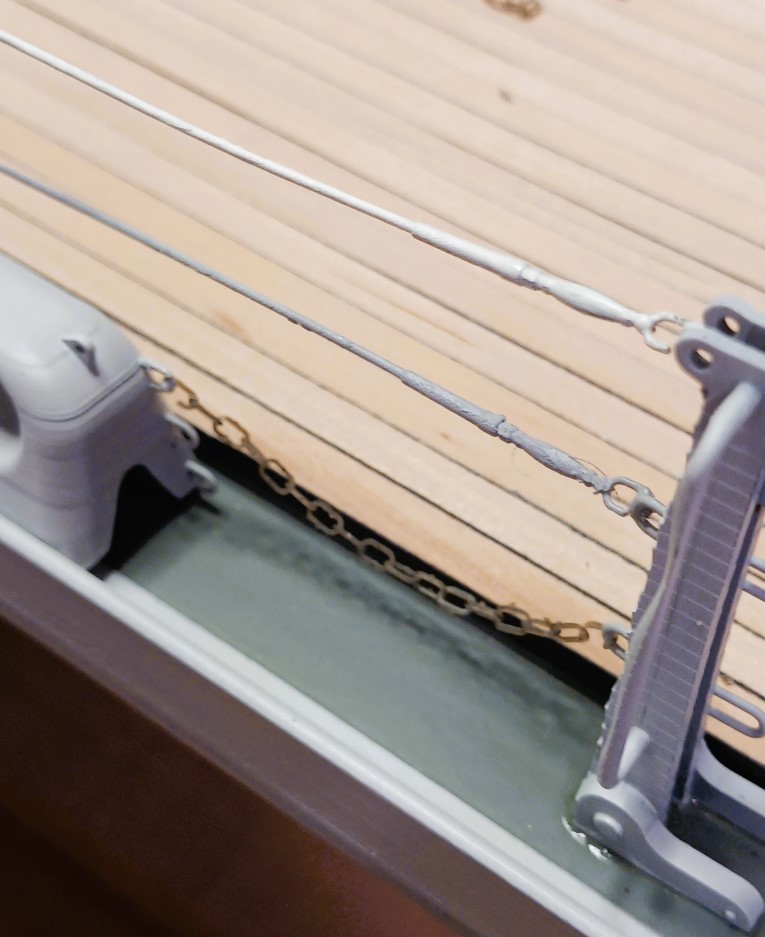

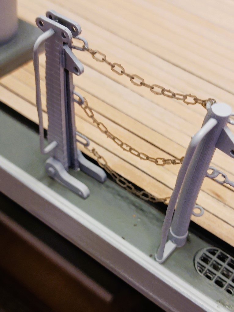

Today/tonight I worked on reprinting a couple times the lifelines/connectors until I got them long enough. Then worked quite a while tonight on installing the several chains that go between the H Stanchion & Pipe Stanchion when the fueling station is not in use.
This was extremely tedious work and with the shop in the upper 80s tonight, not real comfortable to work in. As Mr. Skunk was out and about snorting grubs in the back yard, I didn't think it prudent to leave the shop door open. Tomorrow I'll check out the local feed & seed and see what they recommend to repel skunks from the yard - too bad because they grovel for Junebug & other insect pest grubs in the ground. When I went out to the shop after evening chow, we did have a distant encounter, but not of the 3rd Kind
Here is tonight's progress - Tomorrow I'll paint the chains and begin getting the F.O. Station parts ready for installation.

Here is today's fitting of the F.O. piping - not permanent at this point: I've still got a bit of work to do on the decking where the tripod is secured before actually adhering the piping in place.
